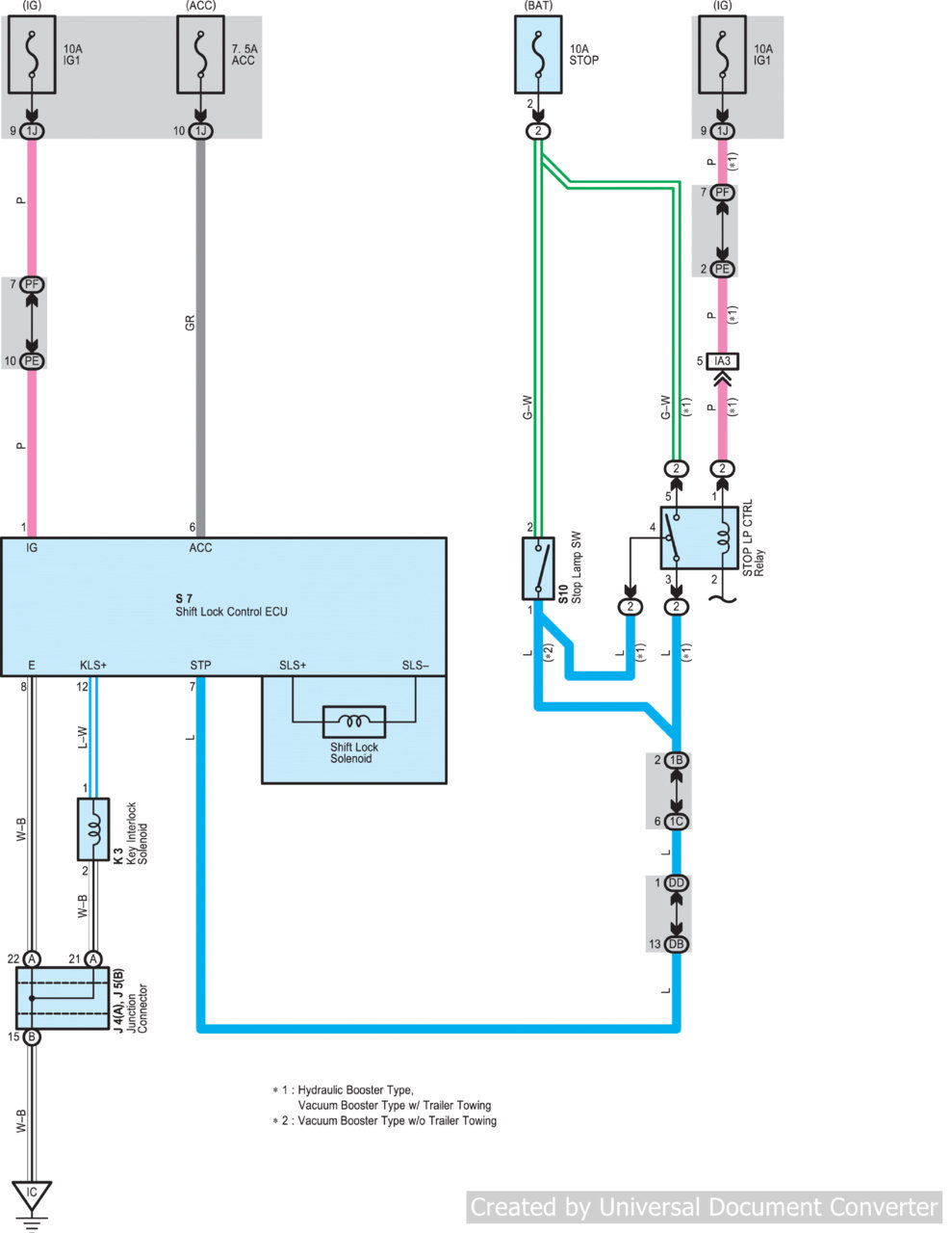

    The shift interlock is controlled by the Shift Lock Control ECU on the shifter itself.
    Steves104x4[QUOTED] likes this.

    Did it get stuck in part at the same time it wouldn't start?
    deentllc[QUOTED][OP] likes this.

    That's why I was interested if the IG1 and IG1 No 2 fuses have power, the same leg of the ignition switch feeds those as well as some of the powertrain management. I'm not seeing anything else in common aside from body grounds.

    I believe that only lights up when the tail lights are on.
    I'm trying to eliminate things that the shift interlock and PCM have in common as we will likely find the issue since both happened at the same time.

    J4/J5 connector seems to be a common.
    I’m with you, maybe it’s a ground issue?
