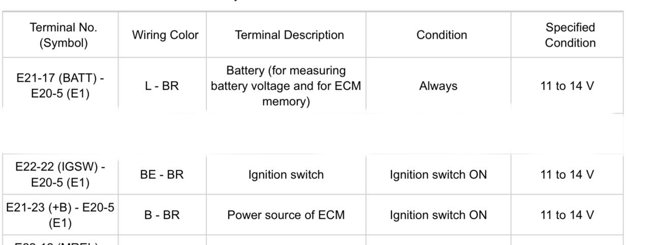

    Why are you checking E21-12?
    That’s for the 4WD Actuator.
    Check the ones mentioned above.
    E21-12 isn’t of a concern right now:thumbsup:

    Also, you won’t see power on E22-12 unless you back probe the ECM when it’s hooked up.

    That was a typo on pin 12. Ok, that was the lamest attempt on my part to check those pins at night..in the rain.... as everything that could have b unattached from the magnets (my lights), the makeshift needles for the pin testing getting swept away in the gutter of rushing water and then getting stuck under the steering wheel and sharp shreds of plastic and metal that dug into my hips and lower back that I'm sure left noticeable marks that are going to stay there for at least a couple of weeks. I SUCK...sometimes.
    So, breakfast is on me. Save your receipts! lol I am determined to do this in a civilized manner and get the voltage. Please allow me to reattach a few fingertips and reinvent this pin testing tool. Actually, now that most of the dash plastic is gone (somewhere .. I did not look as I tossed it behind me in frustration), this next round should be way more civilized and not as embarrassing to talk about.

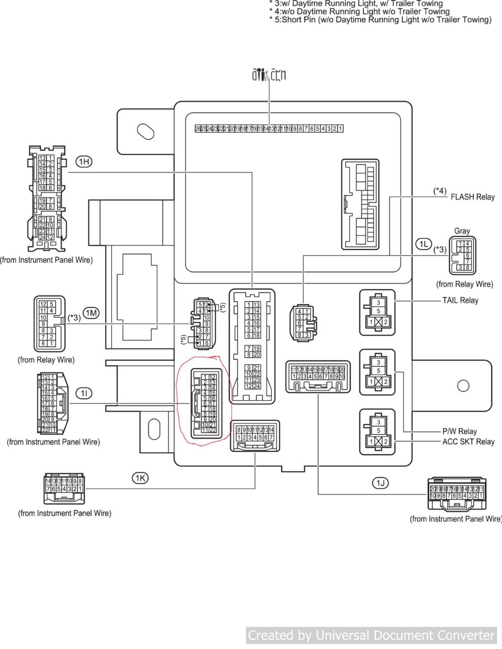

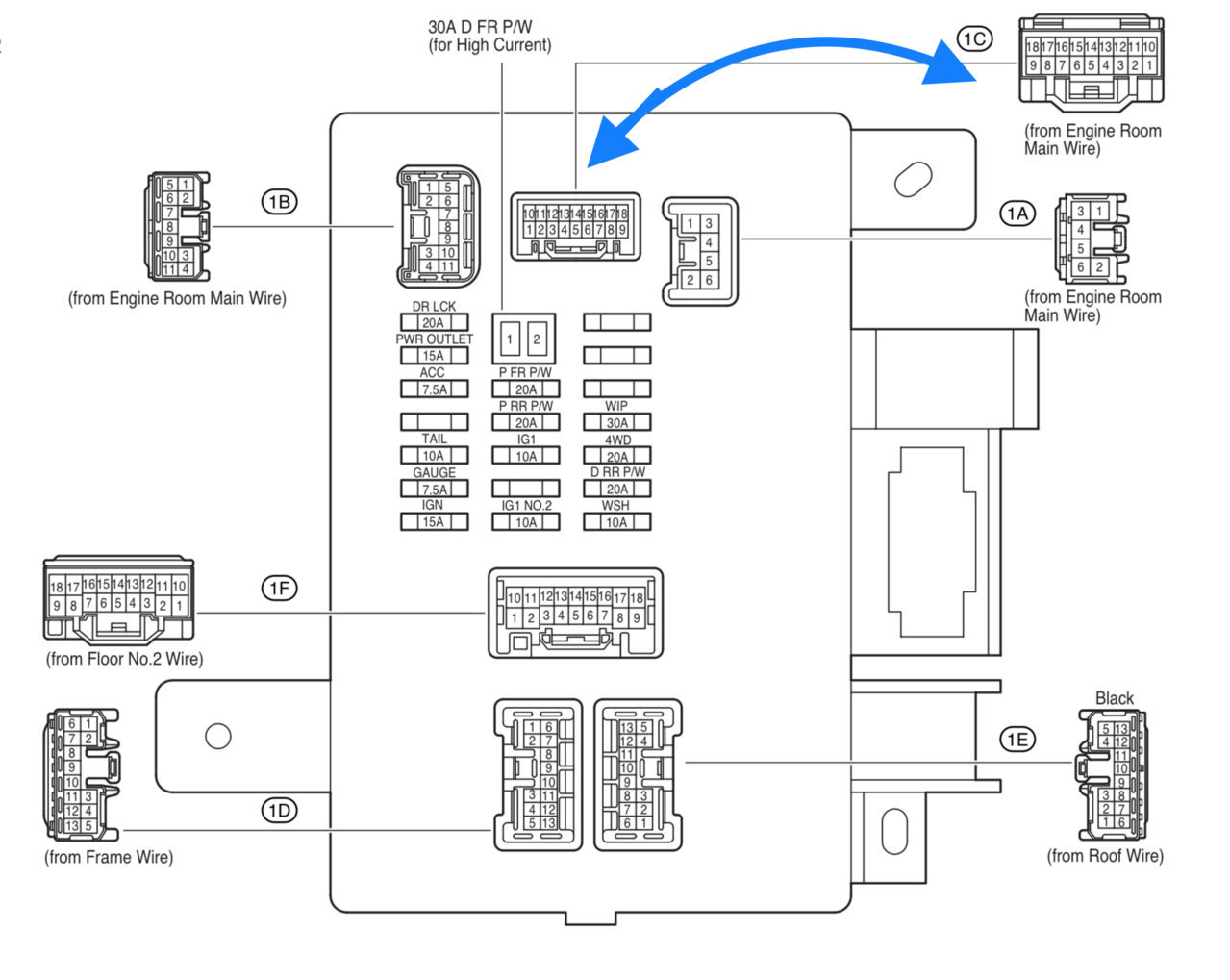

    Well the PCM definitely wouldn't power up if there's no power at that pin, it comes from the IGN fuse through Pin 15 for connector 1I (Beige Wire).
    1I is on the back of the Body ECU/Interior Fuse box, not easy to get to but you might unplug it if you can and look for corrosion/burnt pins.

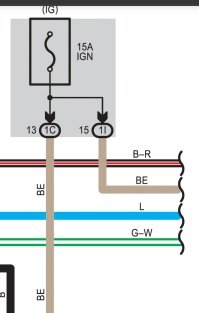

    Are we 100% positive we have power to BOTH sides of the IGN fuse?
    Are we 100% sure we have power to BOTH sides of the IGN fuse?
    Maybe try 1C-13 first, it gets power from the same fuse.
    Just because we can, and it’s easy to get to, and it joins in the same junction box?

    Well that leg of the Ignition Switch also feeds the Gauge Fuse so if it was dead the Cluster wouldn't work.
    I'm with @TnShooter verify the IGN fuse has power on both sides.
