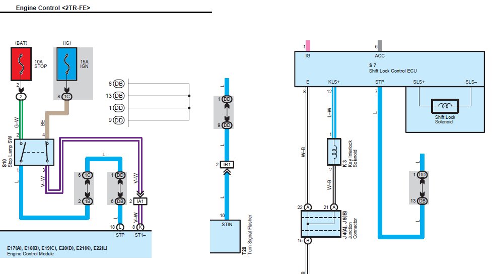

    The RED n YELLOW, GREEN n WHITE...did you trace them to what connector they go to/come from?

    No, it is a little tougher to see those, but I will do that to help complete what you have provided. That is very cool.
