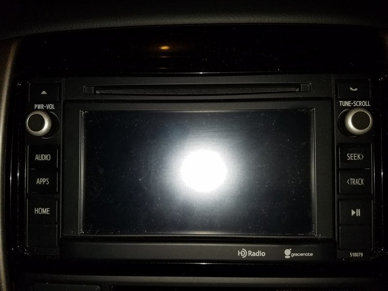

    I blew 2 of my speakers on my tacoma and am looking to do an audio upgrade.
    Anybody know if i shouls swap the headunit as well our can i just install an amplifier instead. I haven't taken the dash apart tho take a look if there is anything from the factory headunit preventing me from doing upgrades.
    I know my old 4Runner needed a new unit but the stock one in the Tacoma is pretty nice.
    TIA

    Do you have the factory Entune Touch Screen w/o JBL?

    I believe so. It was an audio upgrade (entune sounds very familiar) when i first bought it but no jbl
