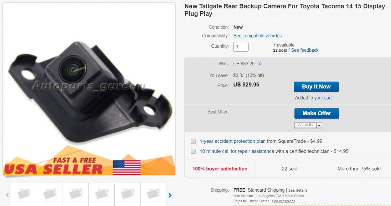

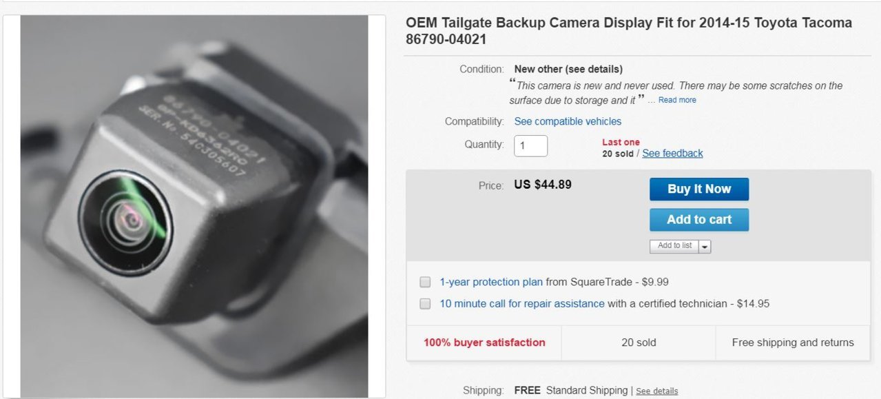

    Has anyone out there tried the ebay versions for $29.96 or $44.89? They are pretty obviously not Toyota parts but they reference the Toyota part number, and even use the term OEM.
    Just curious.
    I'll probably try one of these; it's worth $30 for sure.

    Thanks! I decided to order the $29 "USA SELLER" one today.
    We'll see how it works!
    It has the Toyota part # printed on it.

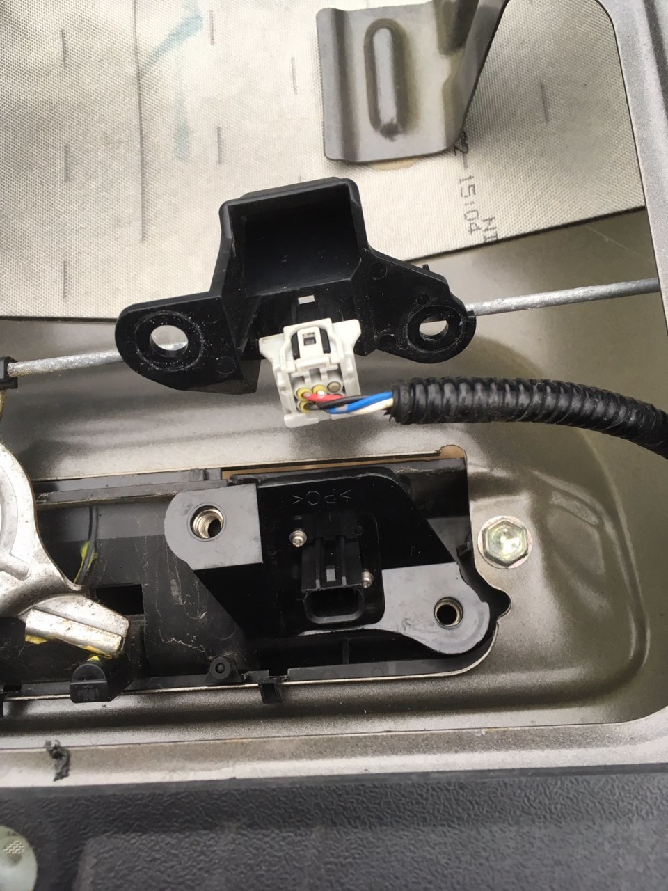

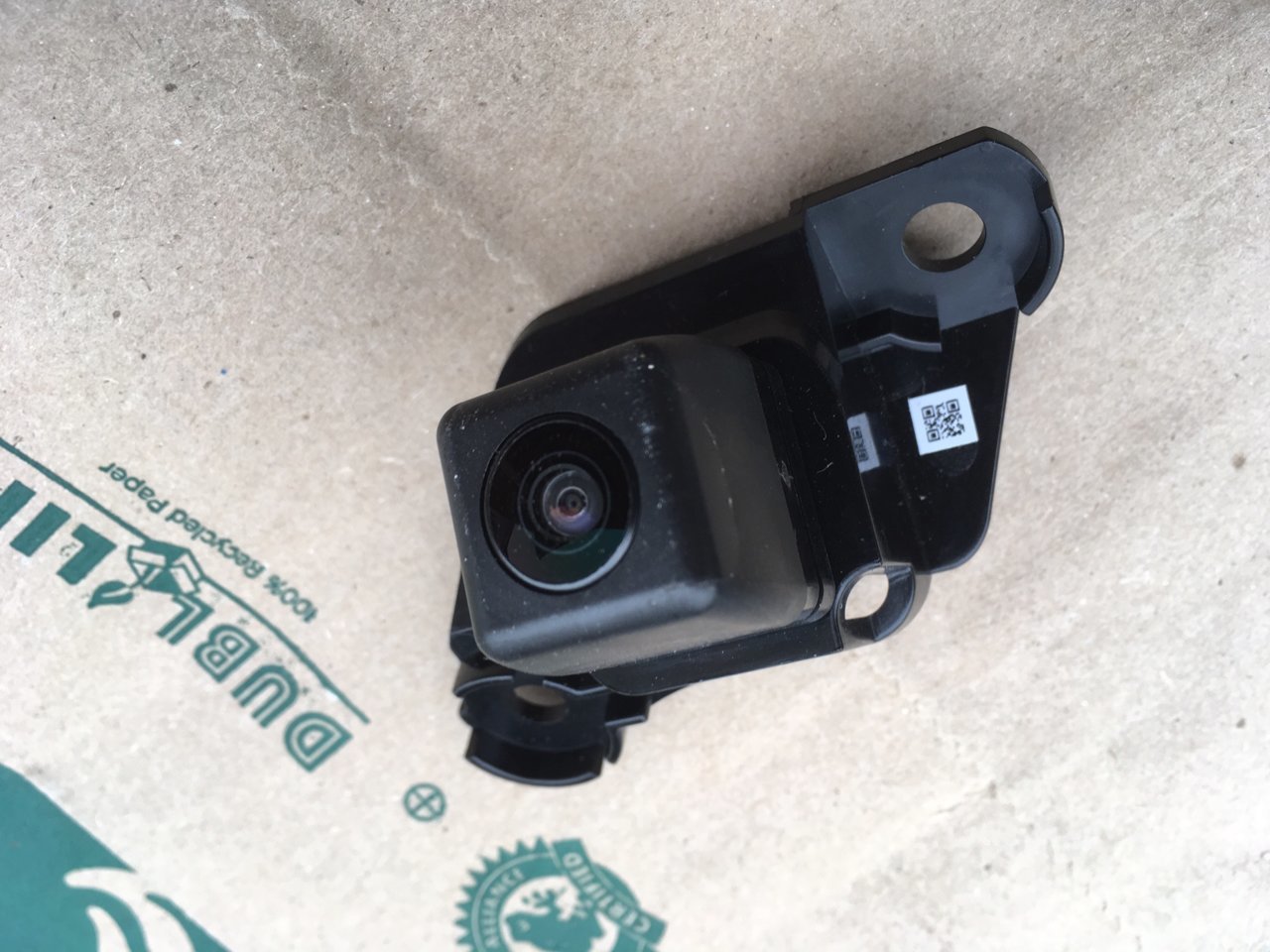

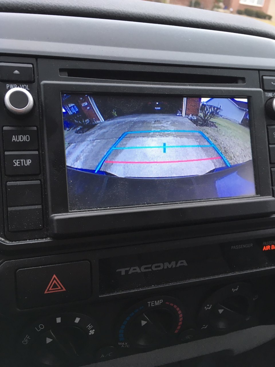

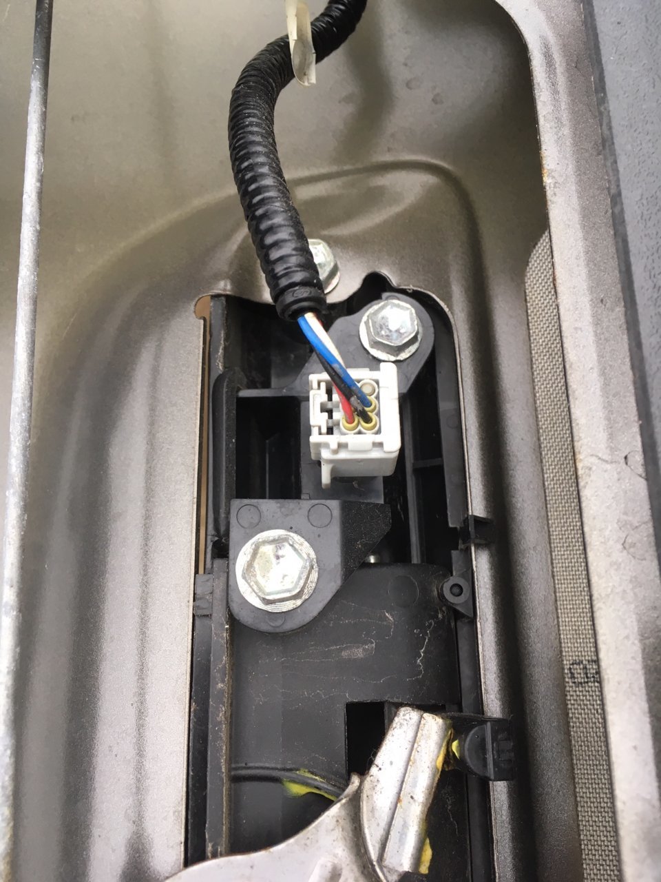

    Finally warm enough to feel like taking my tailgate apart. No problems whatsoever. here are some pics of how it went. Also was a good opportunity to improve the lube on the latch mechanism.
    This is what the blank looked like. Just like the camera.
    Here's the camera:
    Blank still plugged in, camera is an exact fit.
    My truck is safer now! I am really disappointed that Toyota won't offer these cheap upgrades for a reasonable price. If you are in my situation, you can do this for $29. $700 at toyota is ridiculous. It could save someone's life. We have little kids all over our neighborhood.

    I've used one and they work fine. Just be sure to buy a camera with the same plug as the harness. Earlier ones had 4 pins, later had 6 pins. Think they changed it sometime in 2013?
