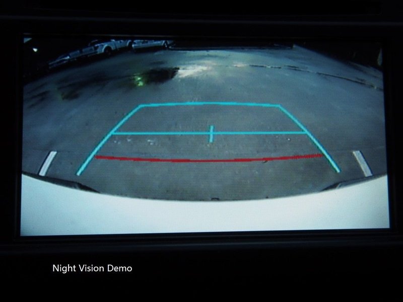

    To you guys that recently did installs: when you had it all disassembled on the back end, did you see any way to adjust the camera angle while doing the install? Or is it a direct fit, fits like a puzzle piece solution?

    If it is a non adjustable part, could one put a washer under any installation screws to affect camera angle? Or would the next piece fit improperly after that?

    The camera fits right in. No adjustment needed. You may make adjustment by adding a washer. But these cameras have wide angle lenses. Therefore, adding a washer or so doesn't change the view too much if there is any change at all.

    I just asked because a lot of these cameras show nothing but tailgate on the bottom third of the screen. It'd be nice to lower the camera a hair so the tailgate lined up with the bottom center of the display screen.
    Due to it being a fisheye lens, I do realize there is inherent "wasted" space, but alignment could be just a little better than it is. No biggie. We can see what we need to. Anything more would simply be a bonus.

    I don't have a pic on my hand. My wife drove it to Louisiana. I grabbed one from the seller's ebay link. He put it up upon my request. It is for night vision but you get the idea. I will do a write-up since I promised him to do one this weekend.

    Agreed. Showing tailgate doesn't make any sense to me. I guess the problem is the design of tailgate handle which sits way deep into the tailgate. The seller on ebay told me they tried to solve the problem by adding more space to the connector side of camera but doing so would expose the whole camera under direct sun light which potential reduce the lifespan of the lens.
