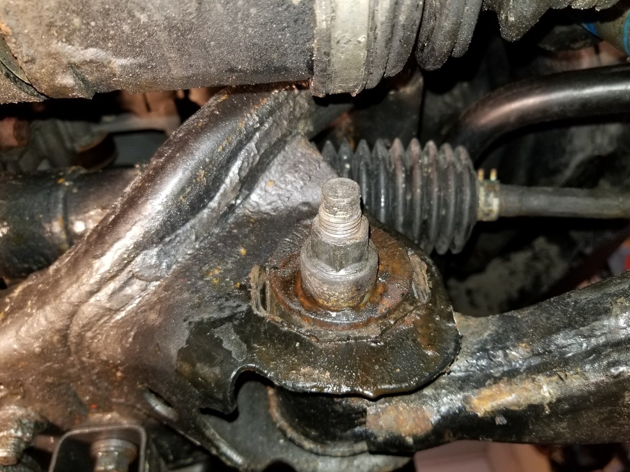

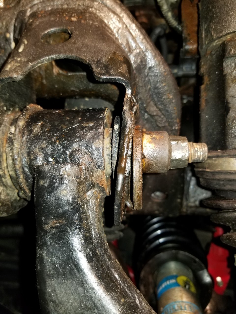

    I put my new lift in this weekend and was back and forth there yesterday for an alignment. First time they couldn't undo the cam bolts, turns out the tech was wrenching on the side where the cam is part of the nut with a 2ft breaker bar (you have to loosen opposite side before you touch the cam/nut side), as a result he bent over both tabs on one side. So I went home and loosened everything myself, drove back and the tech went to work.
    Pic shows how he tightened the cam down ON TOP of one of the tabs, as a result it didn t sit flat and bent one of the LCA mounting ears. (First photo) The cam was also upside down and hanging off it's adjustment plate. Should be flipped 180 pointing upwards centered on its plate. (Second photo)
    They said they got it aligned with a print out to my spec but when I got home I can visually see the toe is way out. \-/
    Fixed it at home and bent the ear back best I could. (Second photo)
    Pretty p***ed off to say the least.
    I have an appointment at Haddad Toyota at 1pm for an alignment and feeling hopeful.
    Will report back.
    If all goes well at Haddad I'm gonna return to Tire Warehouse and show them these photos

    holy shit.... the second picture is that just a bunch of ice/snow on the underside or is that metal? How the angle of the picture looks it almost looks like the LCA has busted through the tab. So any place can manually alter the alignment sheet to show its in spec. They just change the parameters and vola you are in factory specs.
    So I had a similar issue happen to my last truck. Mavis Tire in Pittsfield ended up busting a bunch of my alignment tabs and almost fully rounded off my inner tie rods. I didn't catch it until I drove back to Michigan and then the dealer in Michigan wouldn't align the truck afterwards since the tabs were broken off and since its welded on they wouldn't do.. basically the repair manual says replace frame.. That's why I bought the Total Chaos alignment tabs (but never installed them). I went to a super local repair shop in Michigan who replaced the LCA (the dealer warrantied me that since the ball joint boot was shot). And then anti seized all the new alignment bolts. And he was then able to adjust the alignment.
    Haddad may not be able to address it. Fingers crossed though. Chris Church is one of the service manager there, if you can deal with him he should be able to sort you out as best as possible

    It's metal, haha. I have a wax undercoating called Tectyl with some Fluid Film on top for good measure. Makes everything look gnarly.
    Mavis is terrible. Their favorite tools are a blow torch and a sledge hammer. Was talking to a buddy of mine who had new brake lines put in there. They left the old lines on the chassis and zip tied the new ones to them!!!
    It looks like it's busted through, but its just bent and the plate with the tabs that's welded to it as well.
    George Haddad is my dad's neighbor so I may play that card for extra care. I'll take note of Chris Church, thanks. Really hoping this gets sorted out today.

    So far so good. Up on the lift, and the tech, Doug seems top notch. He pointed out the bent tabs and is familiar with that problem. He said he'll bend them back and tack weld behind them.

    nice! glad to know someone in a shop can operate a welder haha
    if hes up for it have him run a couple beads around the other tabs to try and keep it from happening to them to
