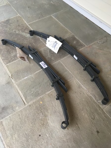

    So the rear Dakars showed up today! Big thanks to Marie from @HeadStrong Off-Road for getting them out fast, and also good call on ordering the full bushing set since these didn't have the front ones. Just waiting on the rear shocks to show up tomorrow and hopefully Thursday starts the whole tear down process
    Also got lucky in a way and both packs were + rated

    Those look like the new improved Dakars....they should have round yellow isolators between each leaf (at the ends) and black square ones in the middle of the pack between the leafs. Also, the new packs are sans the front rubber bushings since most use poly ones.
    I got mine the other day and was very happy to see they were the new ones. Hopefully no squeaks.
    jztacoma[QUOTED][OP] likes this.

    Yeah they have the isolators, looks sort of yellow think they got painted a bit. Started assembling the front shocks tonight. Got dark and the damn mosquitos came out so called it a night and hitting it tomorrow
    Sna[QUOTED] likes this.
