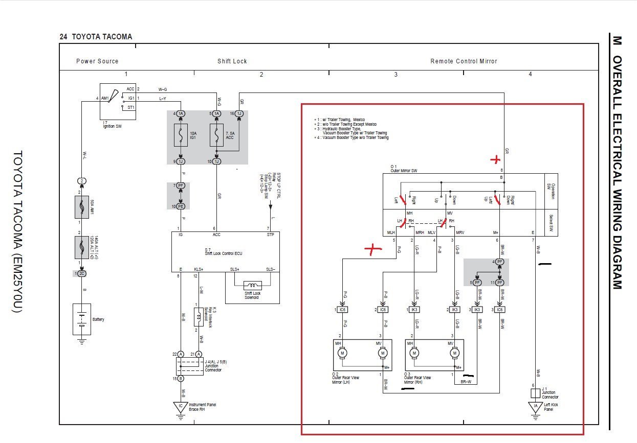

    I got an account today to view the wiring diagrams for my 2015 Toyota Tacoma DCSB. I ended up downloading all 34 .pdf files of the wiring schematics for the body, engine, interior, etc...
    PM me if you need me to look something up for you. The .pdf files are relatively small.
    For starters, I'd like to know how to read/decode the attached image, especially the red square area which is the remote controlled mirrors. I am about to do the 2010 4 Runner Mirror Upgrade to my 2015 DCSB, and I need to identify each of the depicted 2015 Mirror control wires so I can make the crossover to the Sienna Mirror Control Switch (which has the power fold which has been converted to a momentary on switch to act as the power on button for the mirror heat).

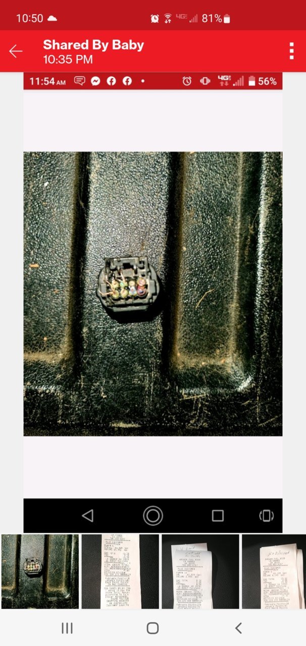

    Can I get a copy of this, even if its on the diagram that shows the 8 connector harness for fuel line? The connector we bought has no colors so we arent sure which wire goes to which connector.
    Please help us, it would be very much appreciated.

    Pretty simple circuit, you have ignition Power coming into the switch on Pin 8 (Green) from the ACC Fuse (7.5A) and Ground coming in on Pin 7 (White/Black).
    The labels within the switch show the position the contacts would be in when the corresponding buttons are pressed, the dashed line between the 2 contacts on the bottom portion of the switch indicate they are connected and move together.
    So in the example I have drawn below would be with the left mirror selected and the left button pressed on the switch.

    What connector are you referring to?
    Fuel pump connector is a 5 pin.

    Screenshot_20230215-225011_Message+.jpgScreenshot_20230215-225011_Message+.jpg Screenshot_20230215-225011_Message+.jpg I think it has something to do with fuel line or filter, bit im really not sure. I have a picture of the part thats on the truck and i need the counter for that, but the connectore that we were told to buy is all black, no colors. I will atta h so may e easier to understand

    Do you happen to have a diagram that shows 5 prongs

    It hooks to a vapor cannister, i believe
