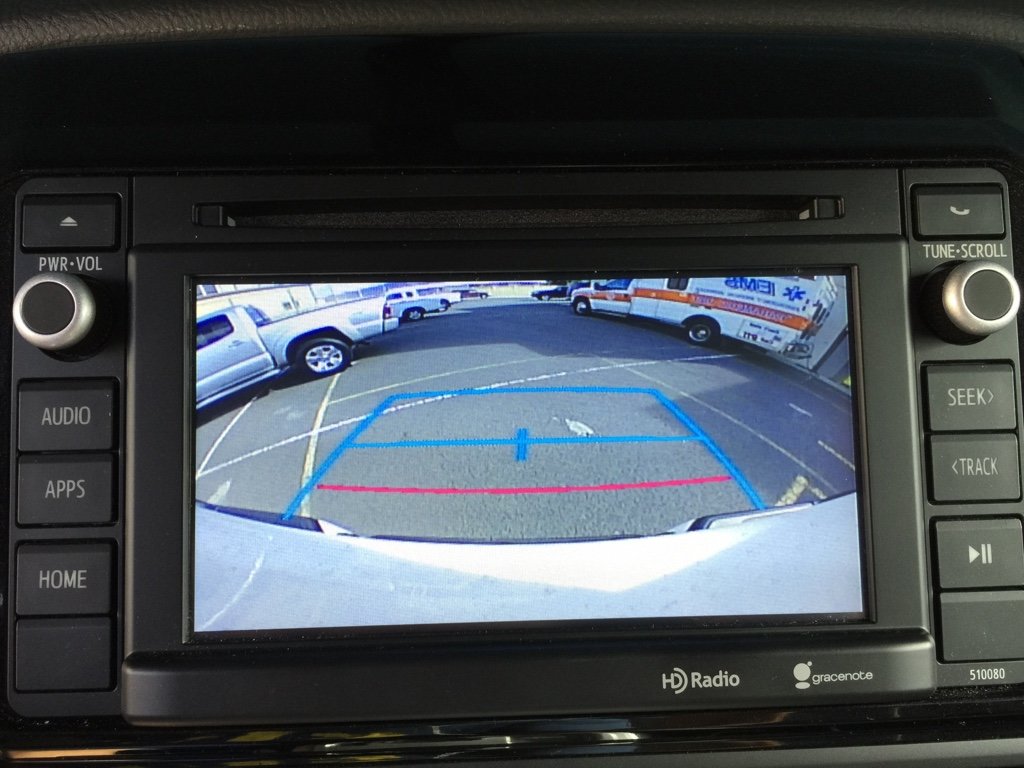

    Anyone know how I can double check the camera alignment on my '15 Tacoma? I swear for the first couple months I couldn't see that much white on the bottom. Seems like the camera has shifted down but now I'm second guessing myself. Maybe it actually has been at this angle the entire time.

    Hmm. Haven't really paid attention to that portion of the screen. Though I don't recall seeing that much tailgate on my 2015 either.
    My lines will perfectly center me in a parking spot though! And that red line is about 12" or so from the bumper. I can back my bumper within an inch or two of my garage wall pretty reliably.

    It definitely isn't supposed to be that low. Mine looks like that now, too, after I swapped the OEM tailgate handle with the Pop & Lock. Haven't done it yet, but I've been thinking about adding a thin rubber washer to the top screw of the camera to get it to angle a bit higher. I'm sure it's possible with some patience and fiddling around. The manual gives you information on how much distance those lines mean. You could place and object or draw a chalkline on the ground, then adjust the camera as needed.

    Exact same thing happened to me also.
    I swear it was not that low but I don't really know.
    I tried to adjust it but there was no adjustment that I could find anywhere.

    Looks fine to me

    Mine looks the same way. I have to admit, when I saw yours I thought it might be pointing too far down because of how much tailgate was in the picture. Got in this morning and mine looks exactly like that.

    I installed mine last week and was wondering the same thing. I looked at the owner manual and it says the red line is 18" back and blue line is 36" back from the bumper. I put some chalk mark on the driveway and they were pretty much spot on, I didn't use a plumb bob or anything to get the exact edge of the tailgate to the ground but it seemed good. The center line also looked good. My wife has the highlander and the screen and camera are so much better on that.

    Looks the same as my 2015,

    The camera on mine has done the same thing and is pointed more downward.

    My 2015 looks the same as OP.
