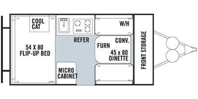

    For reference, this is the original layout:

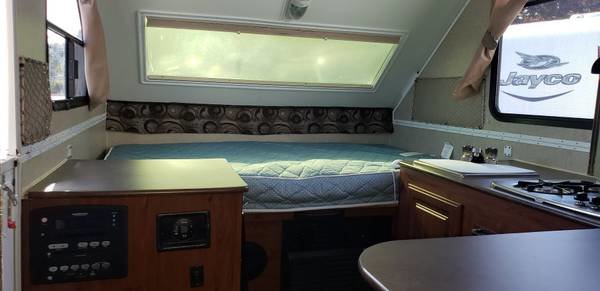

    And here are some pics of what these look like stock.

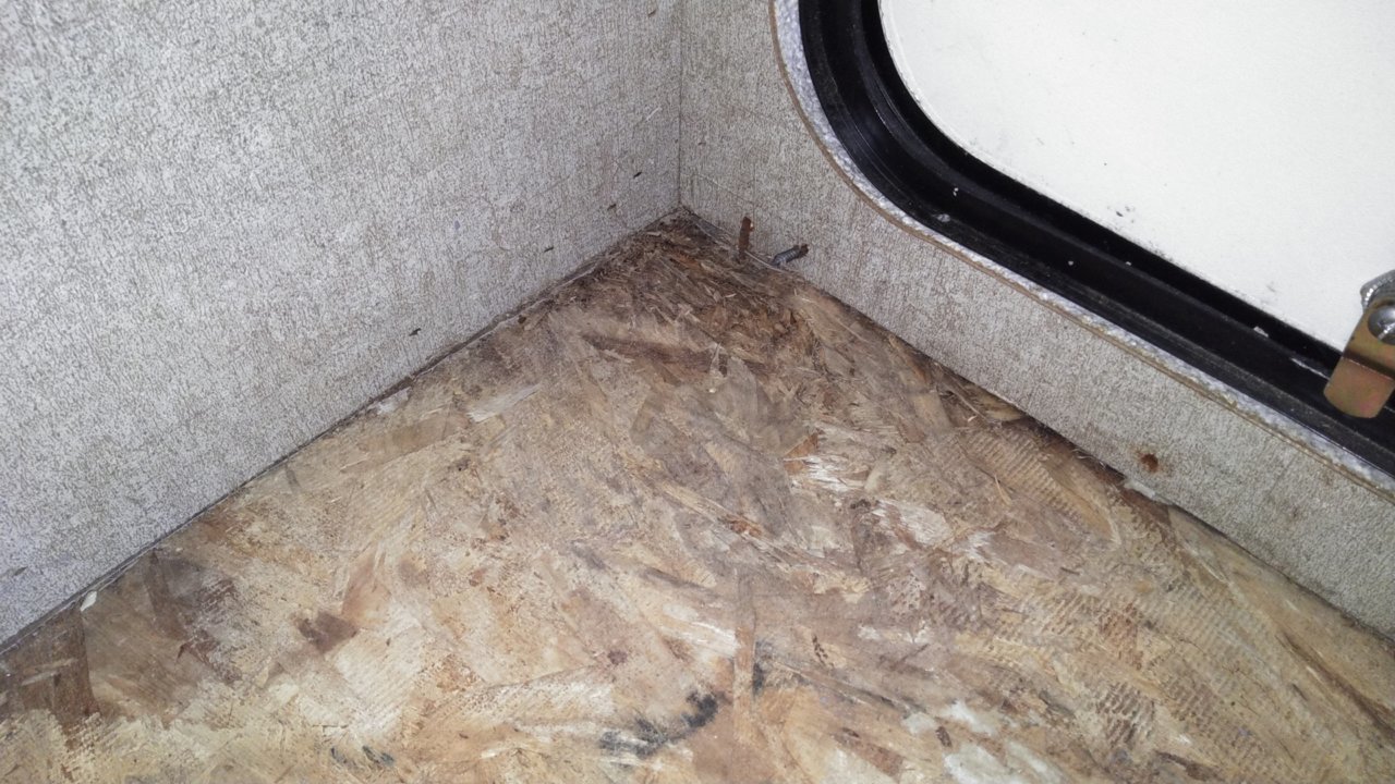

    During the process, and what partially led to this, we discovered some water had leaked in various places. Pretty sure I'm gonna replace the floor, but I'm still looking at to decide. I'm also gonna get some quotes from some welding shops about lowering the axle so I can put bigger tires on it so we can get 4-6" more of ground clearance out of it.

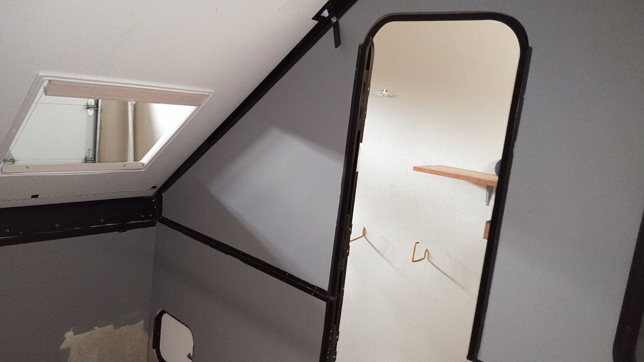

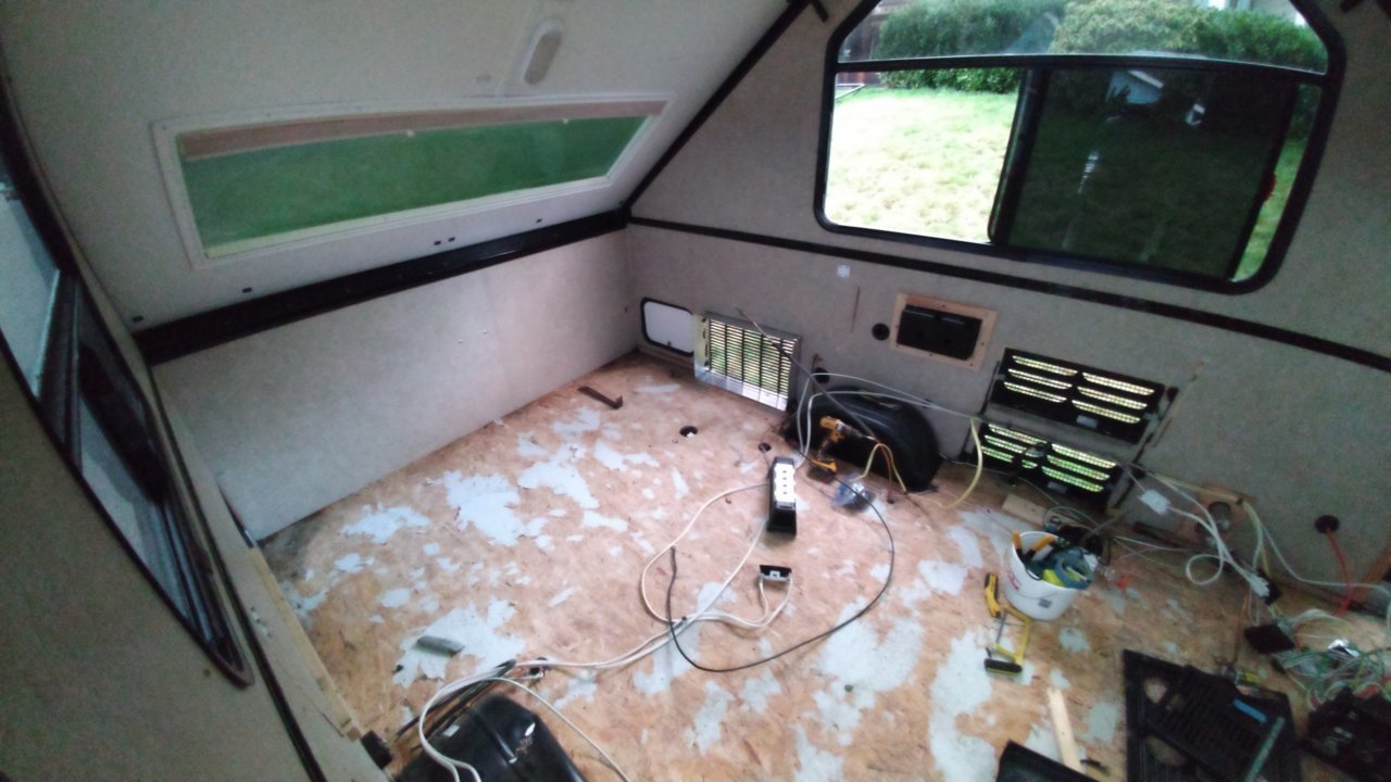

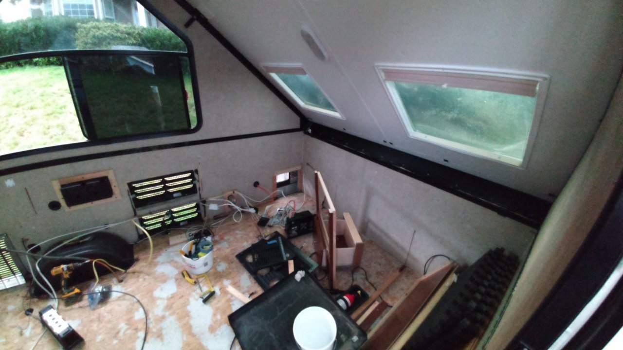

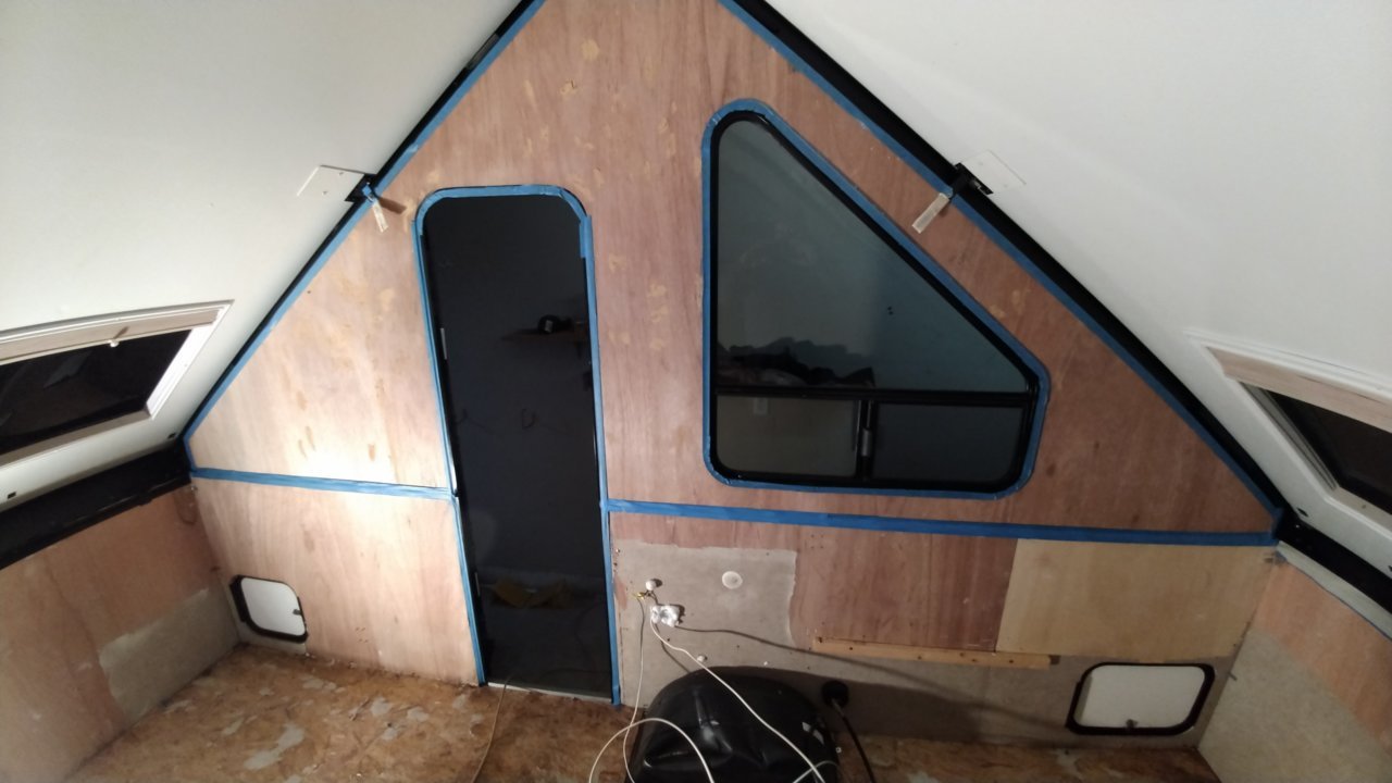

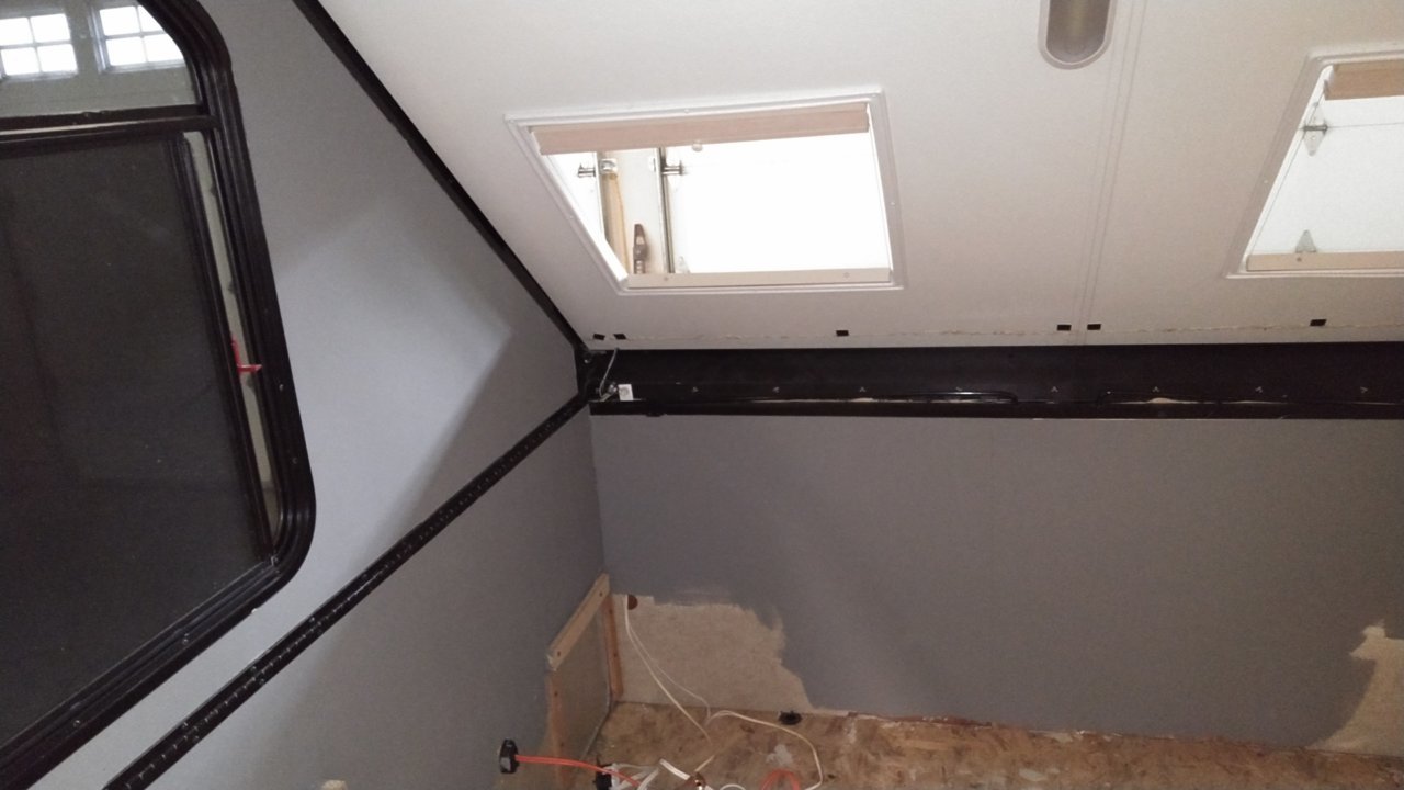

    Progress is being made, though it seems slow. I hope to make major progress tomorrow. A lot of prep and stuff that isn't terribly obvious yet.
    Contact paper stripped, and taped for paint:
    3 coats of paint on. The parts that aren't painted are going to be storage areas that I will probably line with the same flooring we use on the floor. Kind of an eyesore for now, but I'll cope.
    The corners were all a little soft. I contemplated replacing the floor, but this thing is made in a way that makes that hard. They make the frame, then put a one piece floor down, then put the walls on top of it. So, instead of tearing it all apart, or piecing a floor together under the wall, I bought some Minwax Wood Hardener and treated the soft areas. It dries clear so not much to see.

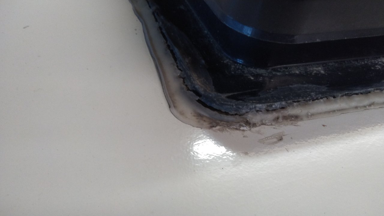

    A previous owner thought silicone was a good idea. It wasn't. I pulled the ceiling fan and all three skylights.
    Peeled all the decals and a bunch of unneeded stickers off of it.
    Soon to come: flooring, new skylights and ceiling fan, reseal all the seams on the outside, new axle, then build out the inside.

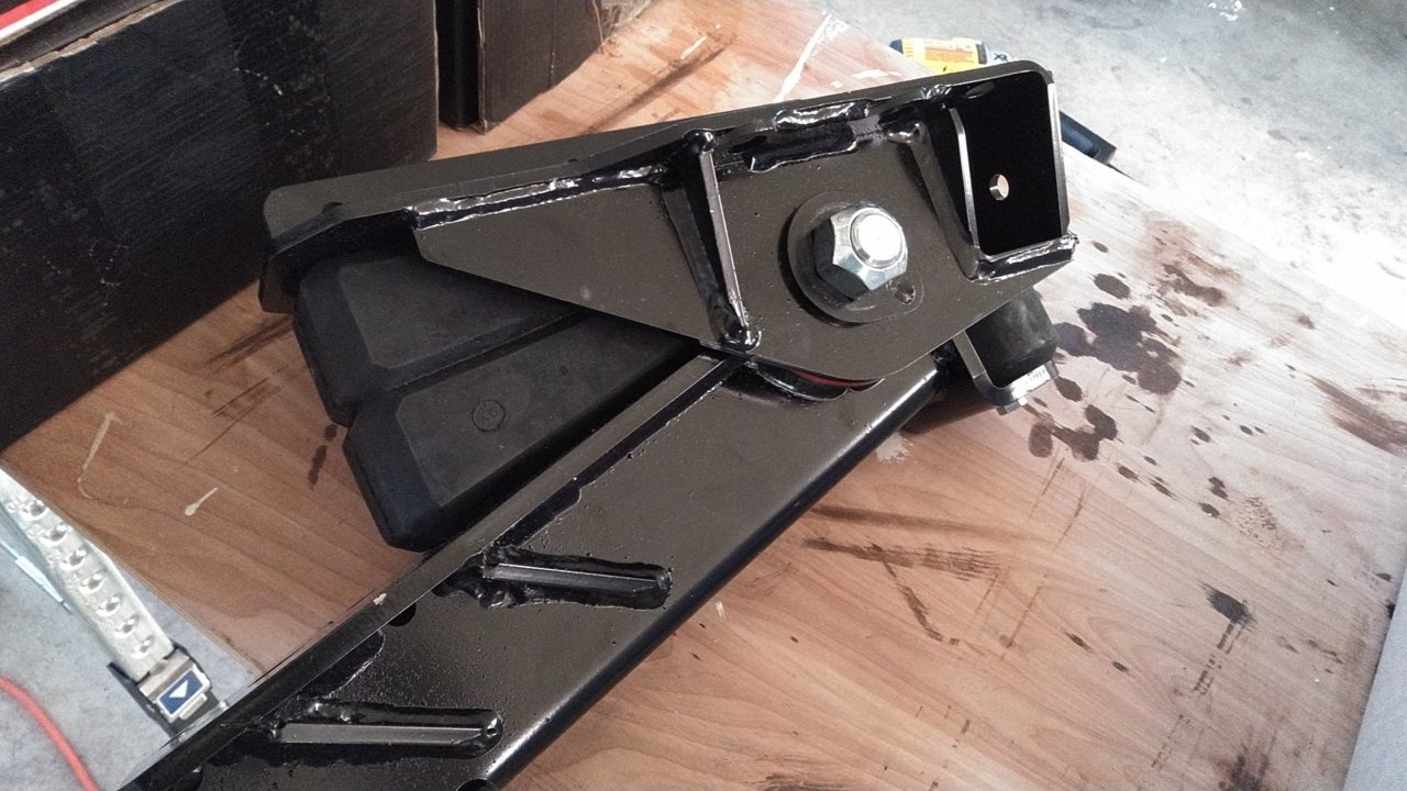

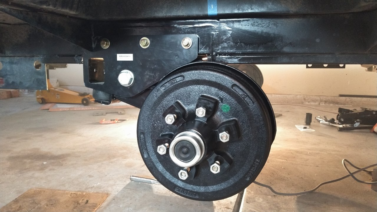

    Teaser pic of the Timbren axle-less suspension.
    Two of these go on, with no axle between them (this is possible because they're going on right under a frame crossmember). It's all bolt on. I also got new 4" lift spindles, brakes, and 6x5.5 hubs. They're rated for 3500 lb. For reference, the nut shown is 1.5" and the steel plate is either 1/4" or 3/8. This setup is pretty cool and seems super stout. I think I'll end up with something between 9-12 inches of lift total, between the suspension sitting lower, the lift spindles, and whatever size tire I go with. It'll all still tuck into the factory wheel well. The lack of an axle across it will effectively increase its clearance too. I'm certainly looking forward to getting it done and getting it out in the woods.

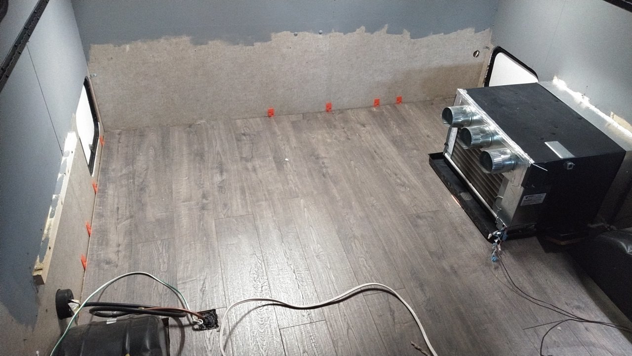

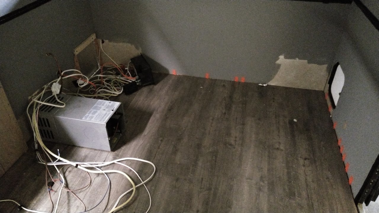

    Got the flooring, heater, and AC in:

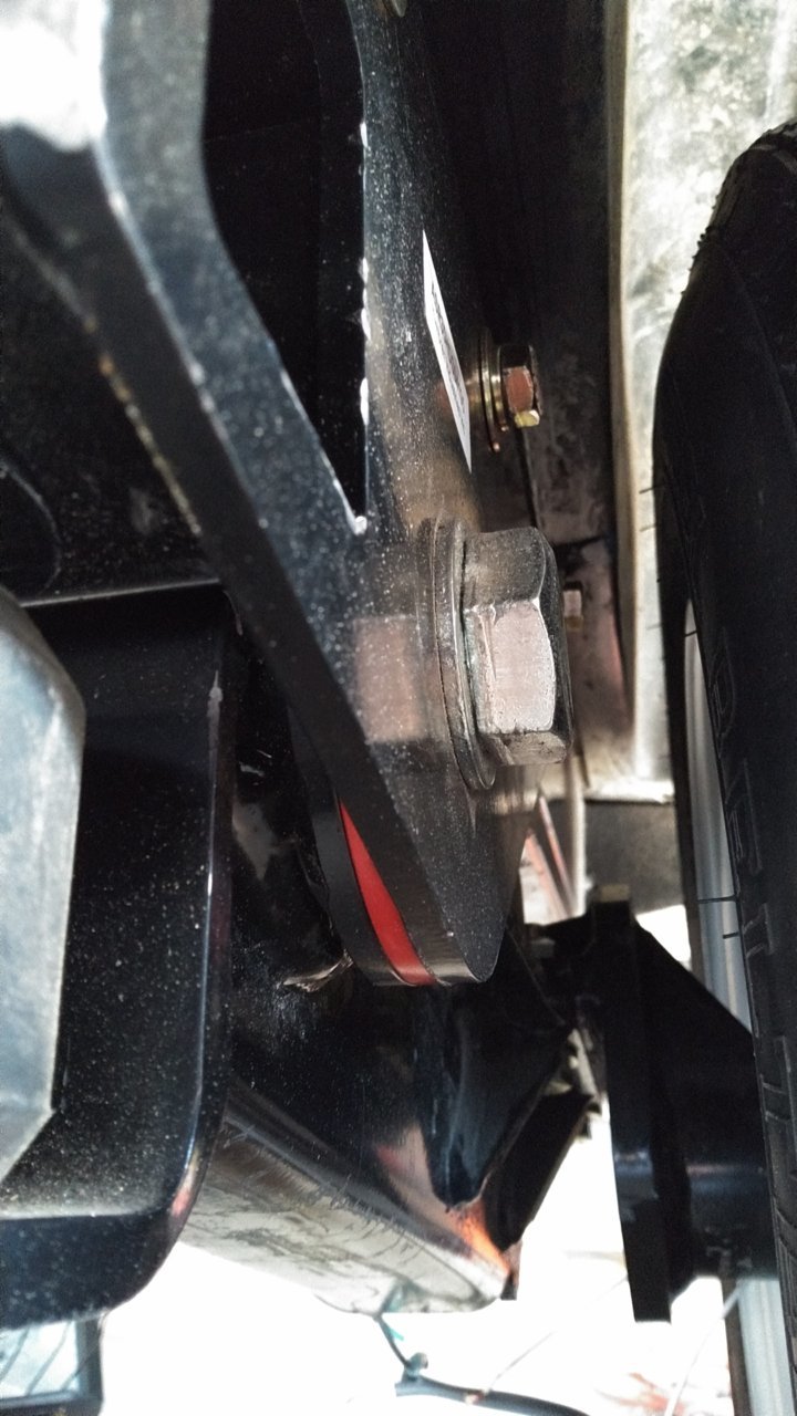

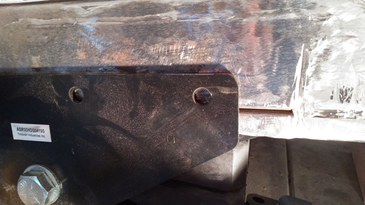

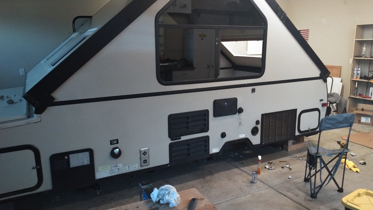

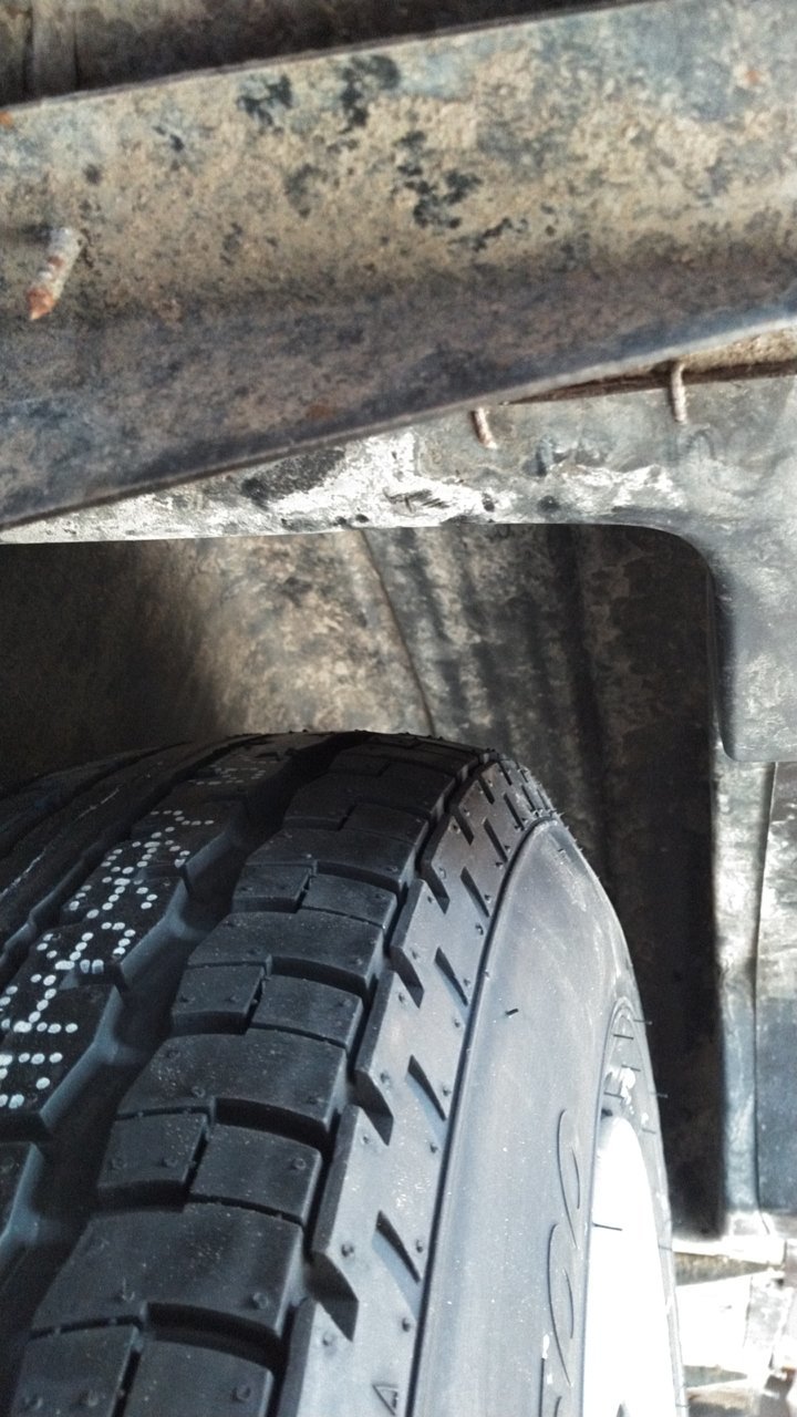

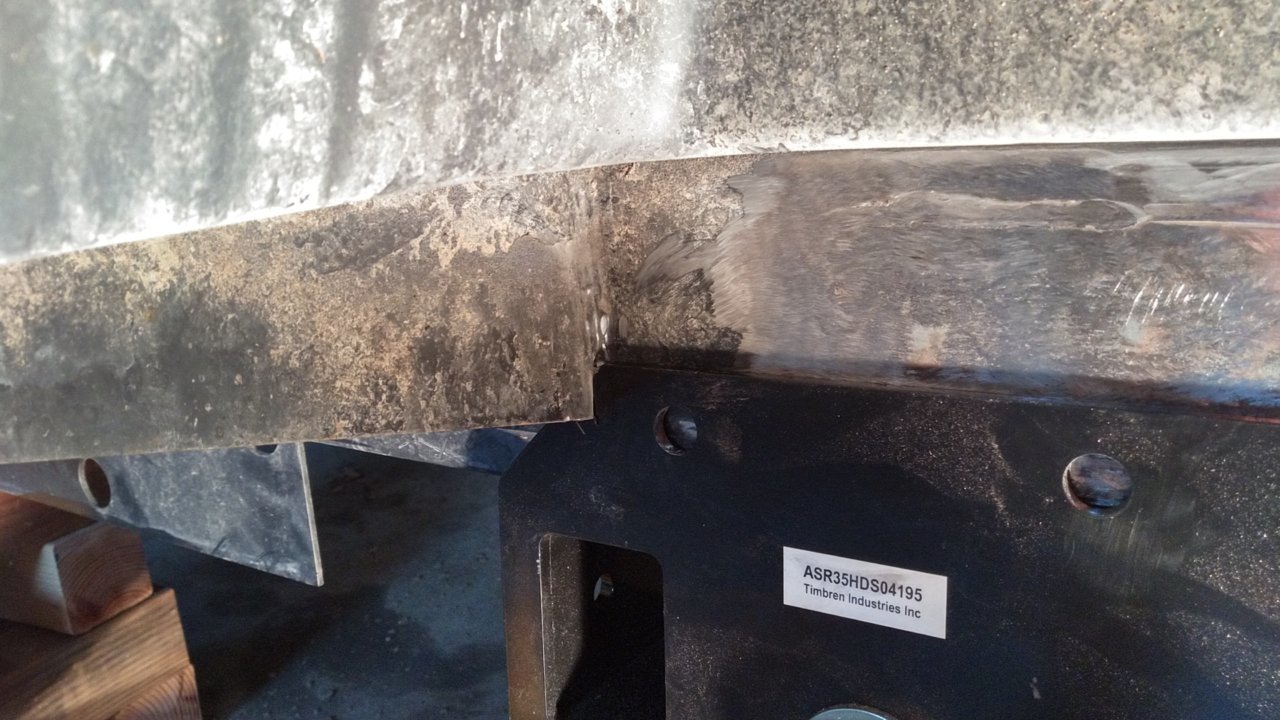

    Finally got the axles under it. Had to do way more grinding and cutting than I realized going in.
    Had to cut the spacer along the bottom of the frame rail shown here to keep the bolt holes away from the seam:
    And I had to notch the weld of this support bracket on each side to get enough clearance for the axle:

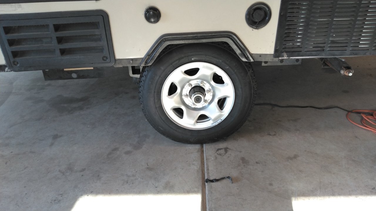

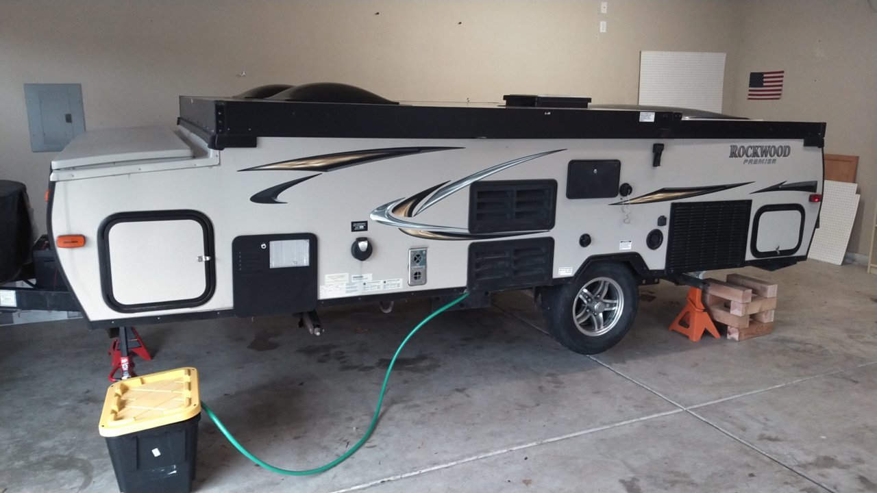

    Got tires mounted on the wheels and got them mounted today. Upsized from a 185/80/13 to 205/75/15. That gave me another 2.5 inches in height, and 0.8 inches in width. The 4" lift spindle, axle, and tires gave me about 6-7 inches of lift on it.
    The 40mm offset is about perfect. 35mm would have worked. Almost went with stock Tacoma steel wheels with 30mm offset. I think they would have rubbed.

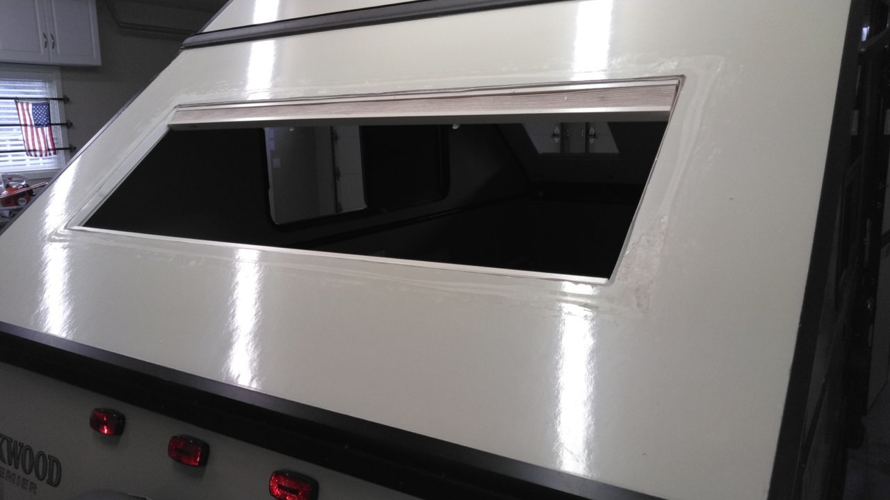

    Also sealed the ceiling vent and the new skylights today. She comes home tomorrow!

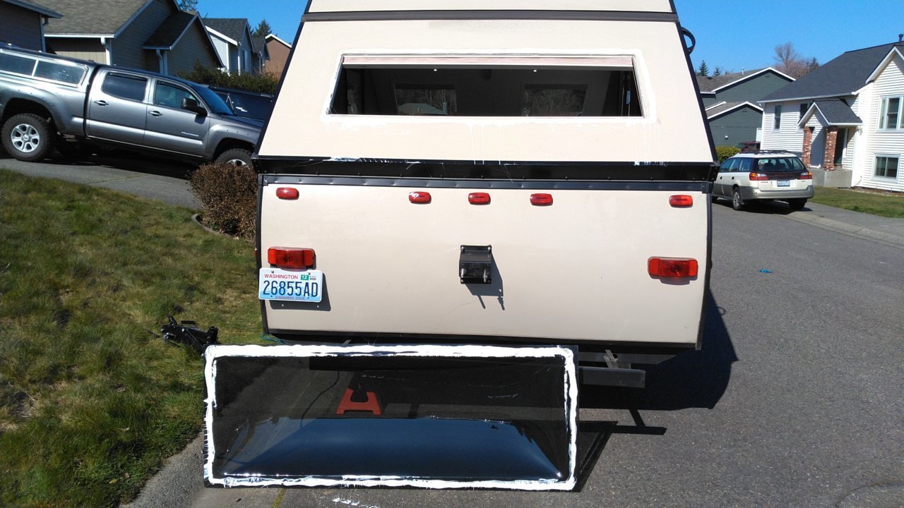

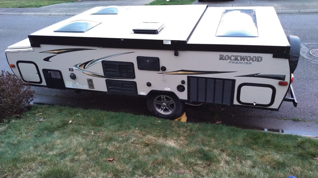

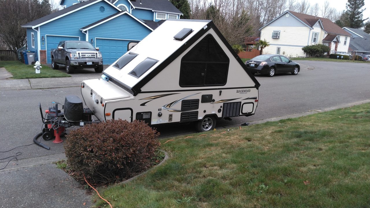

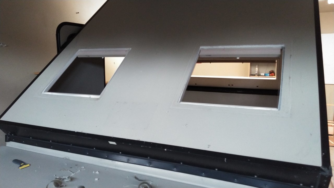

    Progress has been slow and I've had my first major complications. The frame isn't strong enough to support the weight of the camper with this axle system with no crossmember, which I found out by almost losing one side of the axle when I pulled it home. I think it's still salvageable. The axle was designed to make it easy to add a 2" x 3" crossmember, and it sits so high off the ground it doesn't impact ground clearance, so that's only a mild mess up, I hope. That all happened Saturday. I got real pissed after the axle and decided I didn't want to mess with it so I came inside and killed some time in the house. At 2pm it was really nice outside, so I went out to start on it.
    I set it up and this happened a few minutes later:
    It was a nice day so I put the skylight aside and started working on the interior build. What I got done Saturday didn't look like much so I didn't take any pictures. I redid the rear skylight and decided to let it cure for a full day and then some to keep it from falling out again.
    Sunday I took the day off and spent it with my wife. This morning, it was cold and rainy. The weather broke at 10am so I went out to start on it. The weather went from so sunny I wondered where my sunblock was to rain, hail, freezing rain, and wind gusts. The first rain came and went and there were no leaks in the skylights or ceiling vent so I thought I was golden. Then it came a downpour and the rear skylight started leaking like crazy. I got a little work done but eventually got tired of the weather and having to move buckets under the leaks and everything else, so I called it a day. It was a really frustrating weekend.

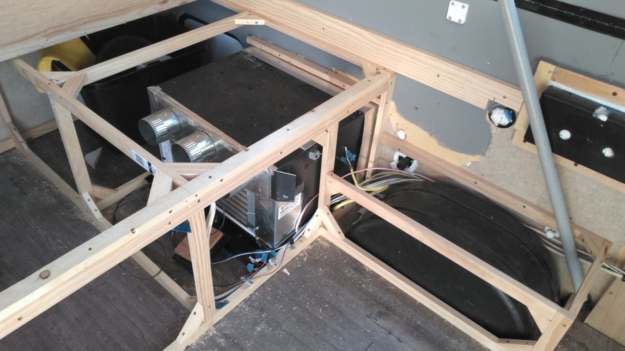

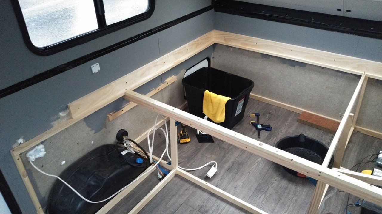

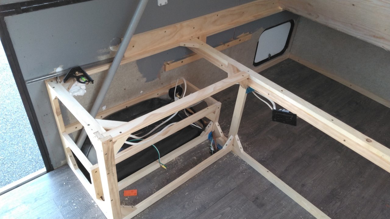

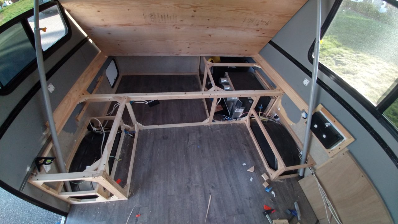

    I'm still working despite the quarantine because I'm "essential." Took this past weekend off to spend with my wife. I'm off all this week because I was supposed to go see my family. Rather than pick up shifts, I'm dedicating it to the camper. Got some time in on it today.

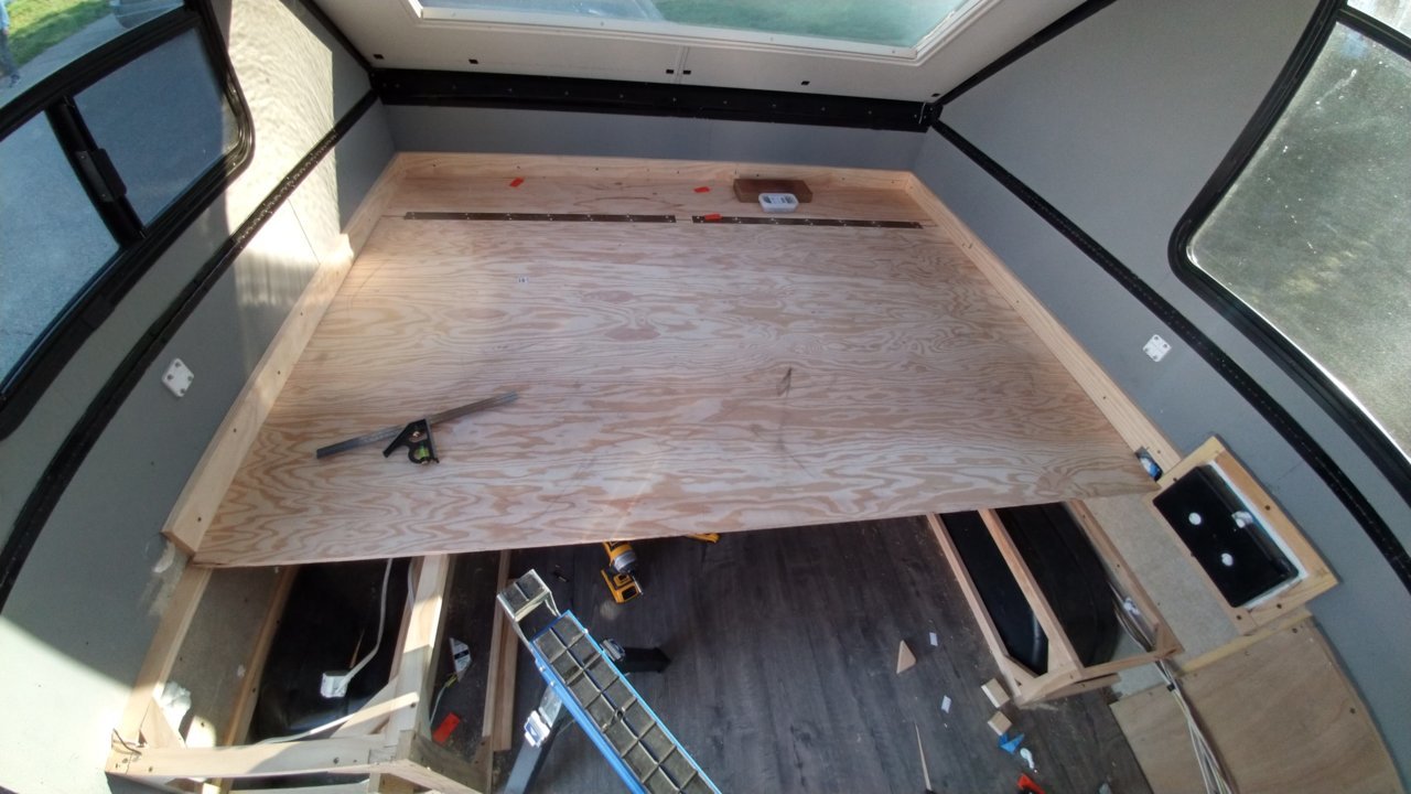

    Frame work for the bed is about done. Ran out of 1x2's or I would have framed out the cabinets. This is all 1x2 construction but is really solid because of all the corner braces. You'll notice most are wood with a couple metal ones. Tried the metal first and wasn't satisfied so I just cut a bunch of scraps into braces. I'll replace the metal ones before I'm done.
    Since I ran out of 1x2's and didn't feel like going to the lumber yard, I started cutting some plywood.
    I also cut and screwed in the panel that goes across under the bed, behind the AC there, but forgot to take a final pic.
    I'm finally getting into the funner stages (for me) and have a few cool features planned. Hoping to have daily updates for the next several days.

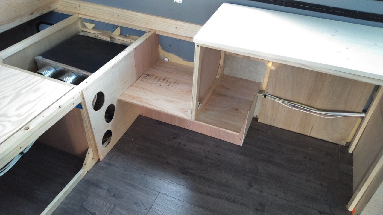

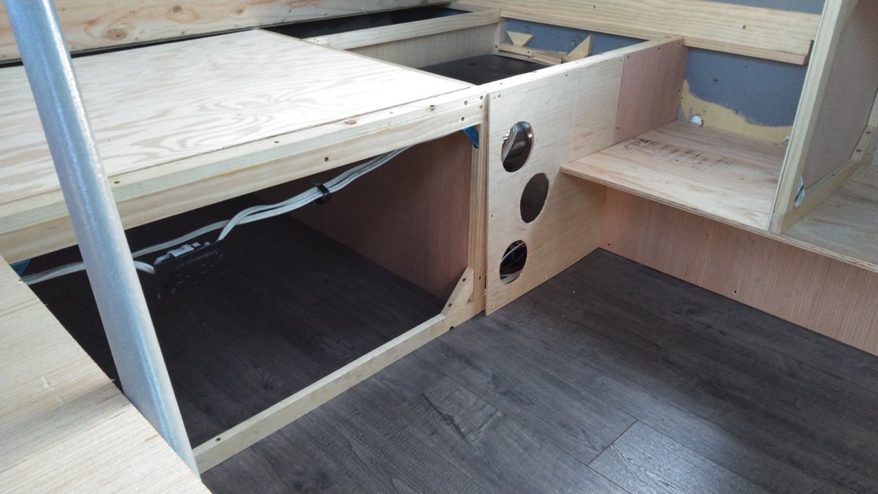

    Worked on it Tuesday but forgot to post. My wife was off yesterday so I spent the day with her. Got another full day in today. Starting to look like a camper again.

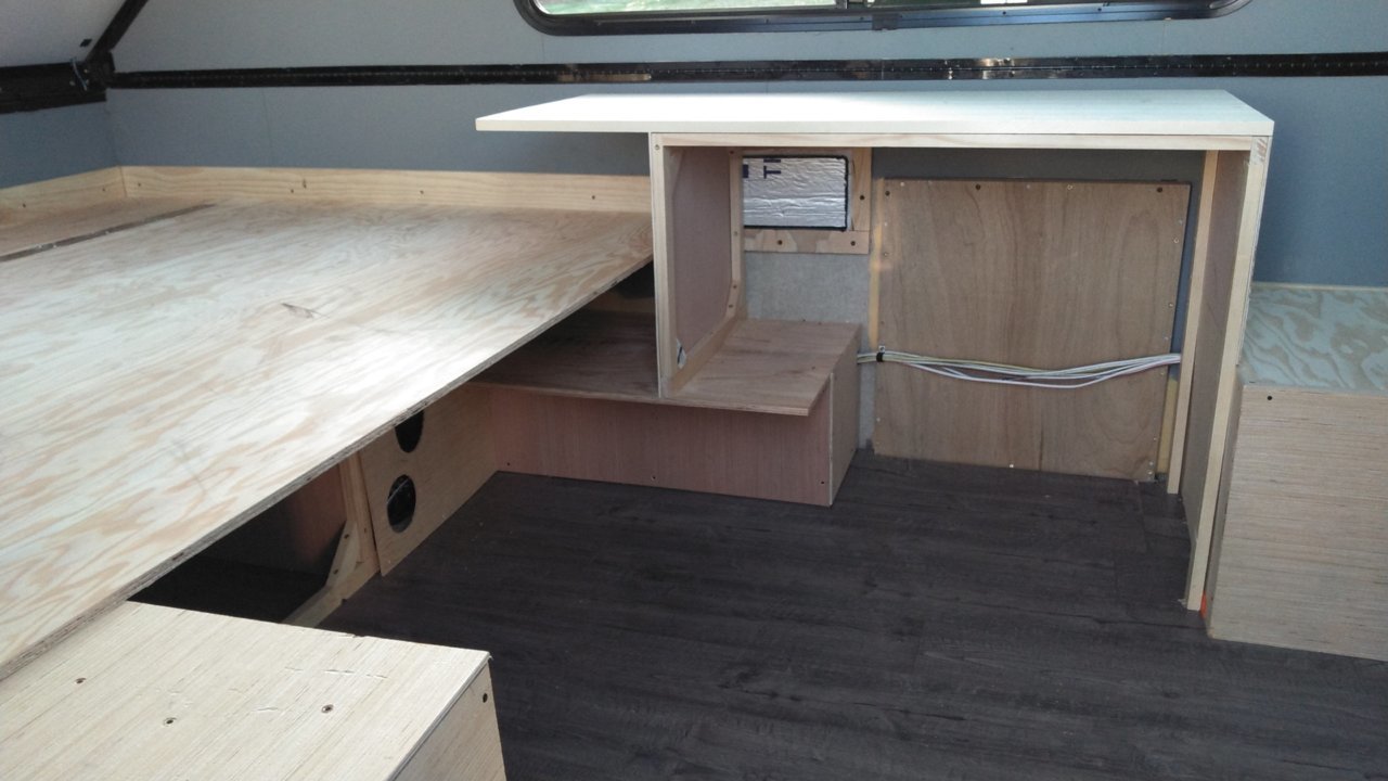

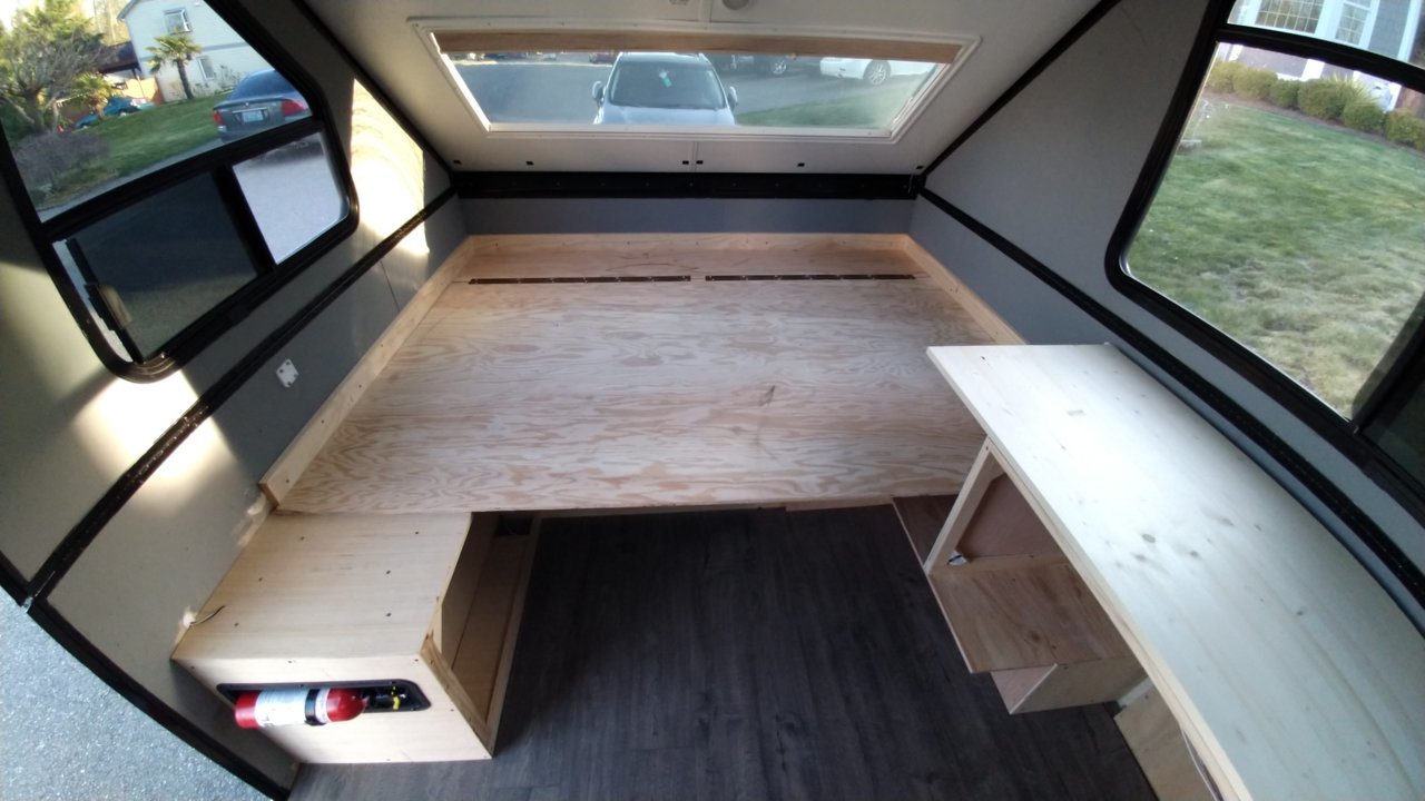

    Bed, bed side table that covers the wheel well, and counter top. Those dark strips in the back are the hinges, not gaps.
    The counter top isn't attached yet. That overhanging portion on the left will be cut off and attached with folding shelf brackets so the bed can go up and down, but we can have the extra counter space when needed. Might do another folding shelf on the right side too.
    These three holes are for the AC vents. The space under the counter will include a microwave and storage, of course.
    The wood panel just to the left off the AC duct holes will have the air return in it eventually. Thought I'd be able to cut some slots in the part where the vents are but I didn't have room to do it without it looking stupid. There will be a panel across the front of the open area too.

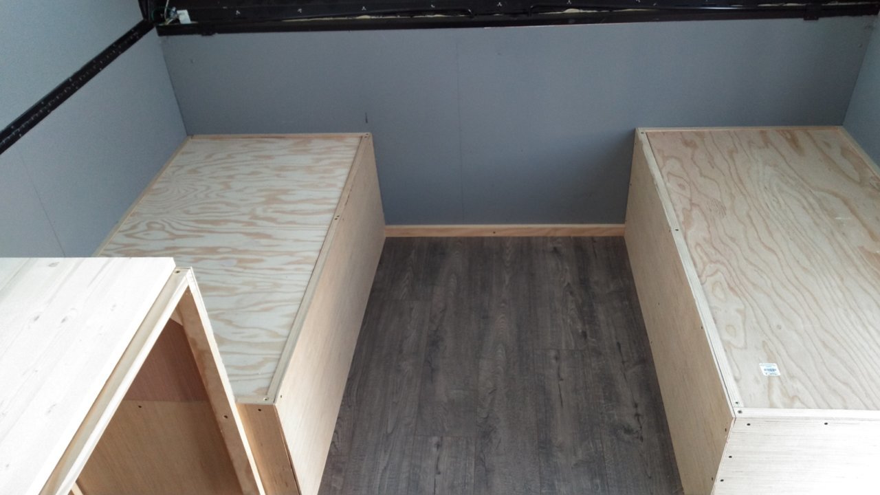

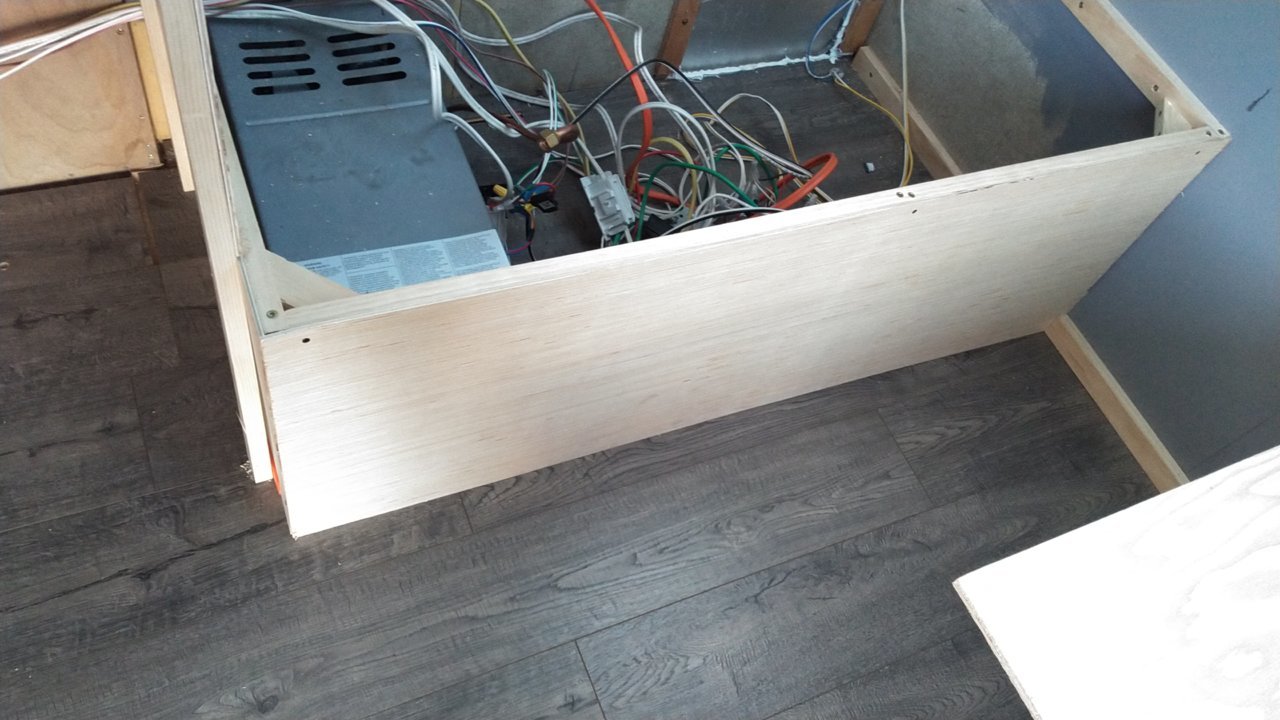

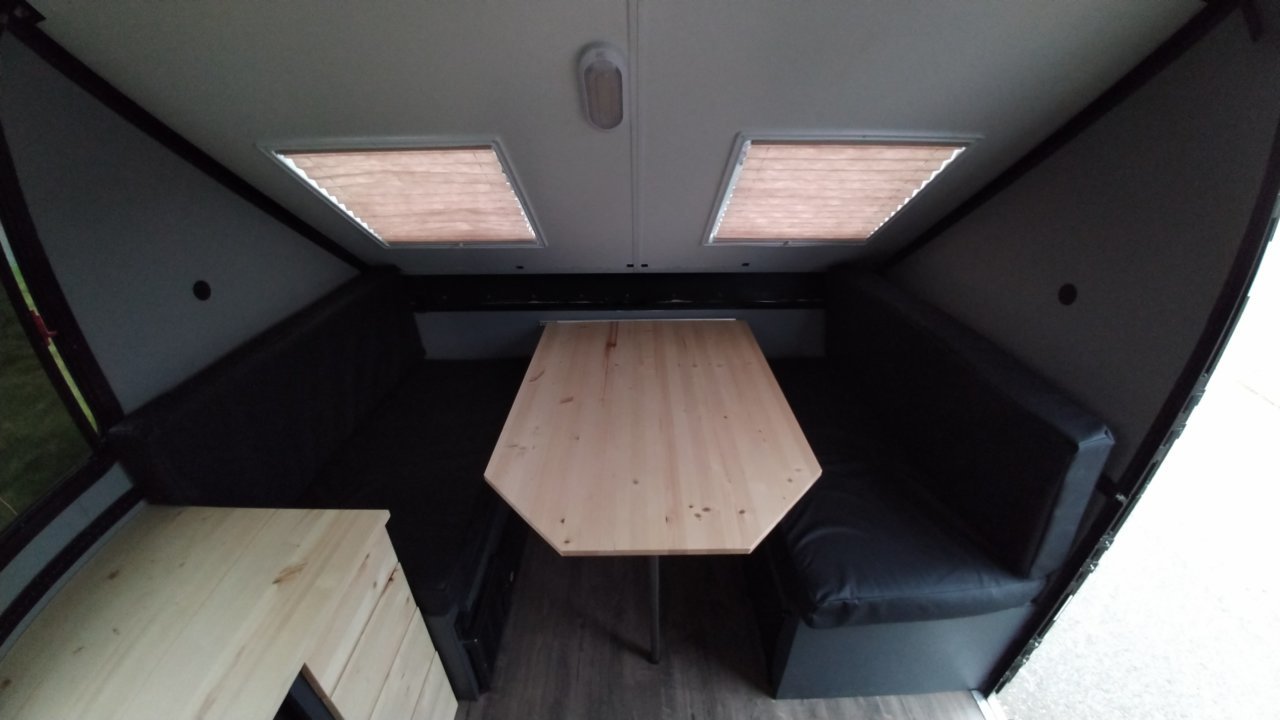

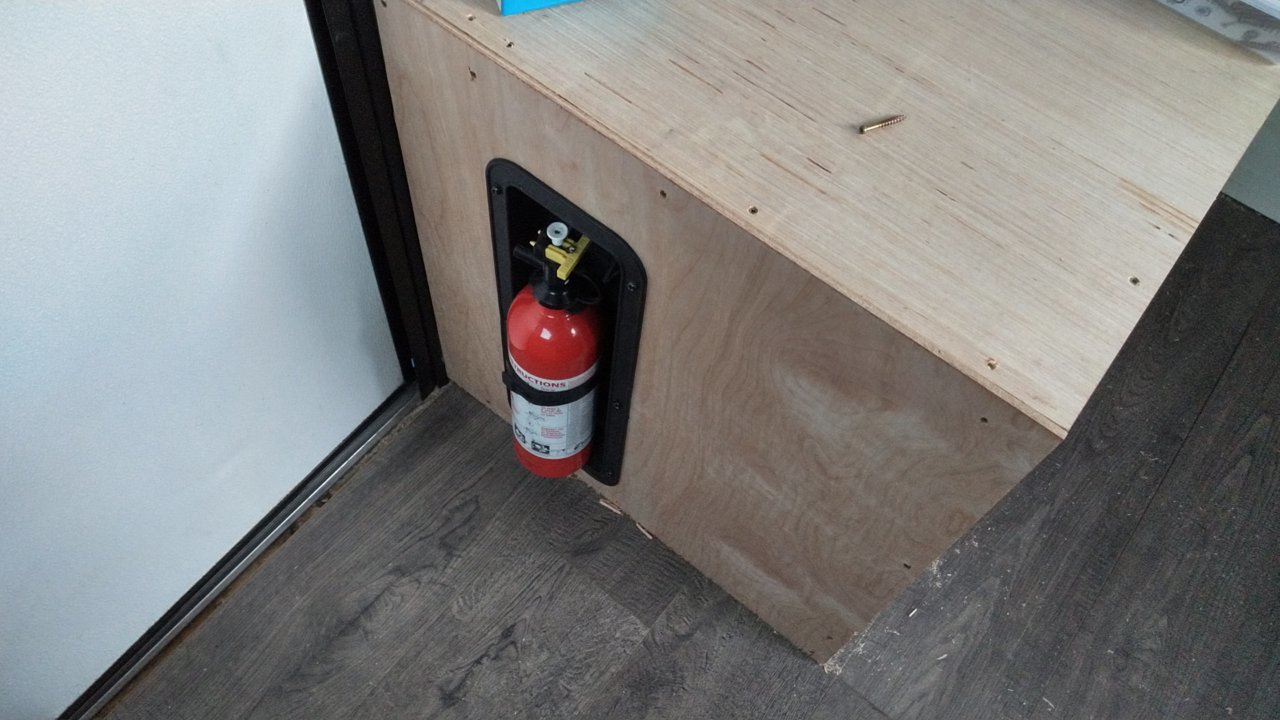

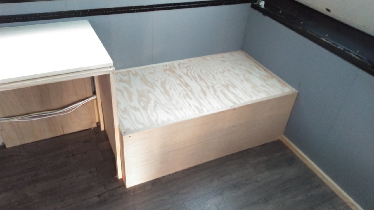

    Seat boxes. The table top will double as an extra bed, of course. Storage underneath both sides.
    This side was made identical to the other, but it just wouldn't come together quite square. Its taking some creative cutting to get everything to look decent enough. I'm gonna have to cheat a little to have the table top/bed platform be square but still fit between the seats tight and safely.

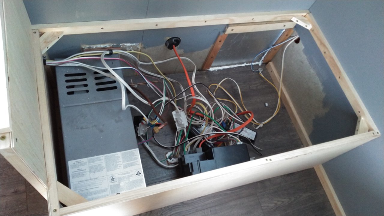

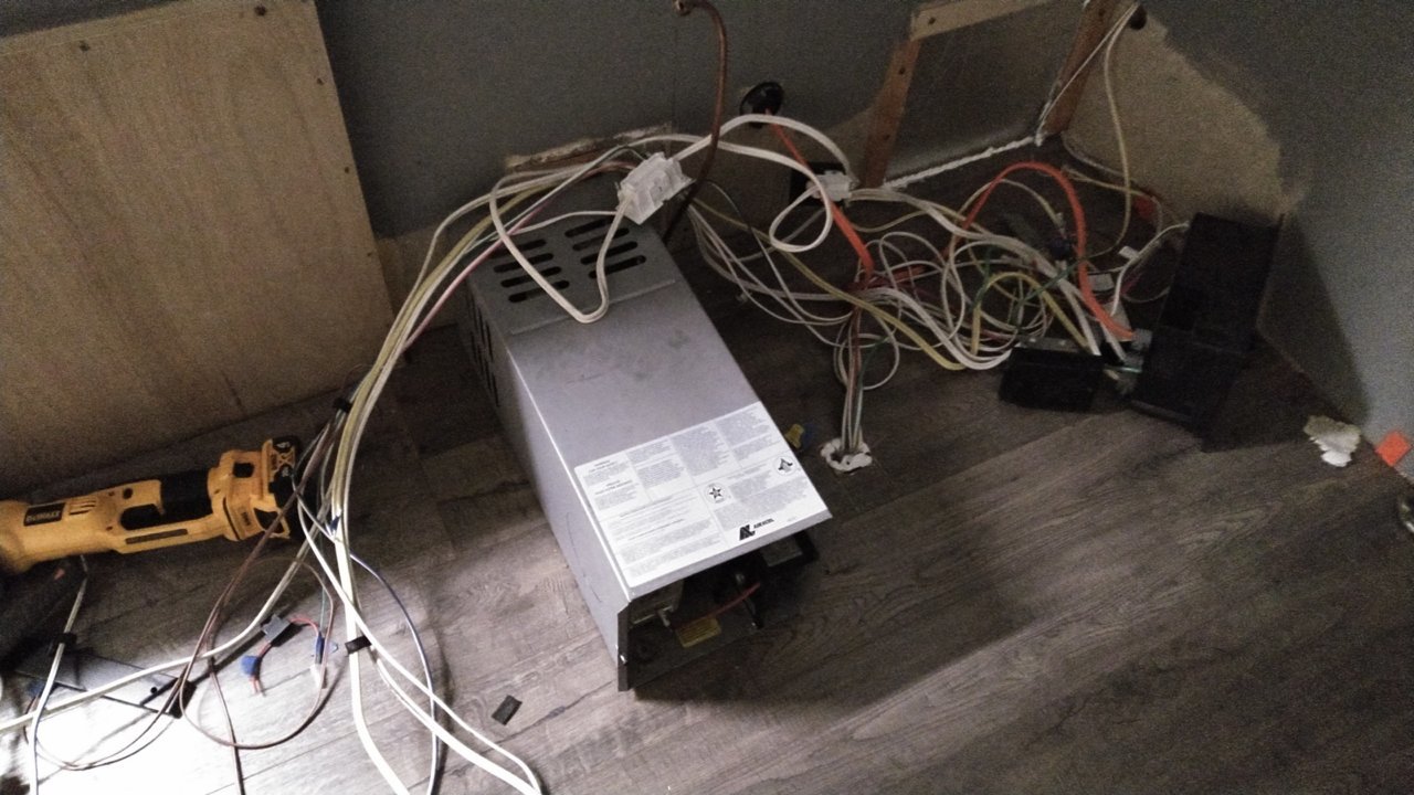

    This is the heater and fuse box. All the wiring is hooked back up. I need to cut out the front panel for the heater, get the fuse box mounted, and clean up the wiring. The furnace and fuse box will be boxed in so the rest of this can be used for storage. The opening in the back right is where the water heater originally was.

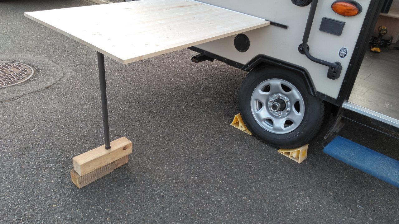

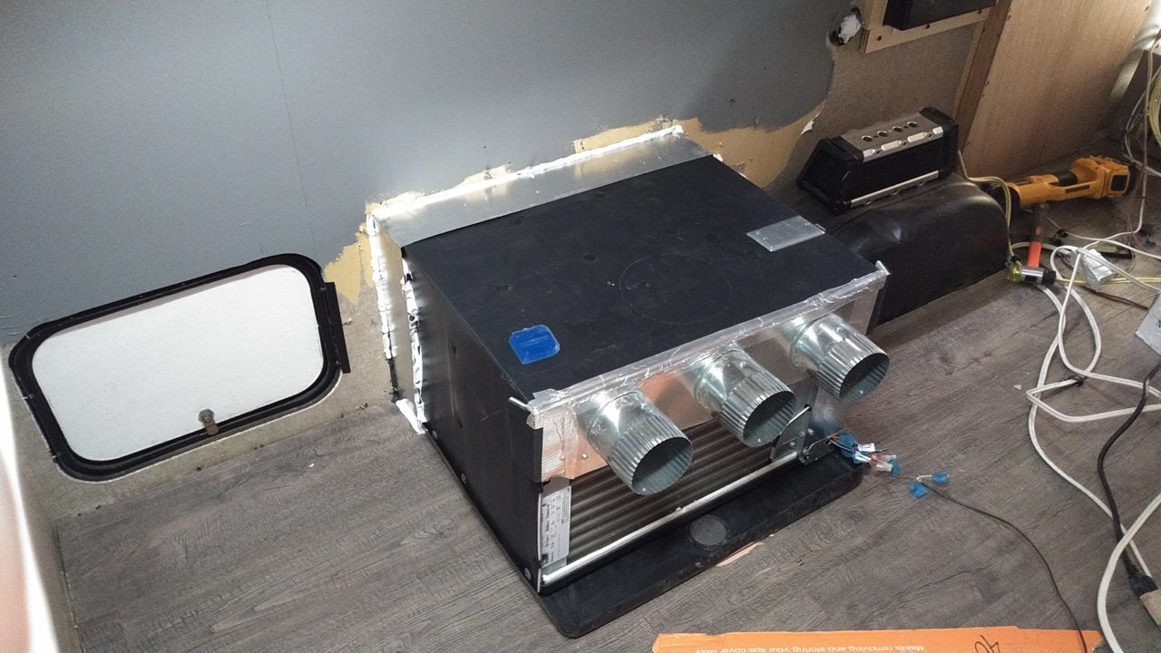

    Today, I got the panel cut out for mounting the heater, fuse panel, and an electrical outlet. Lots of measuring and thinking to make sure I got it right. Don't have a pic but it was like an hour two of fooling with it to get it just right.
    Started putting some carpet down on the bed platform and under it. It's only part way done and looks kind of shitty, so no pics of that either.

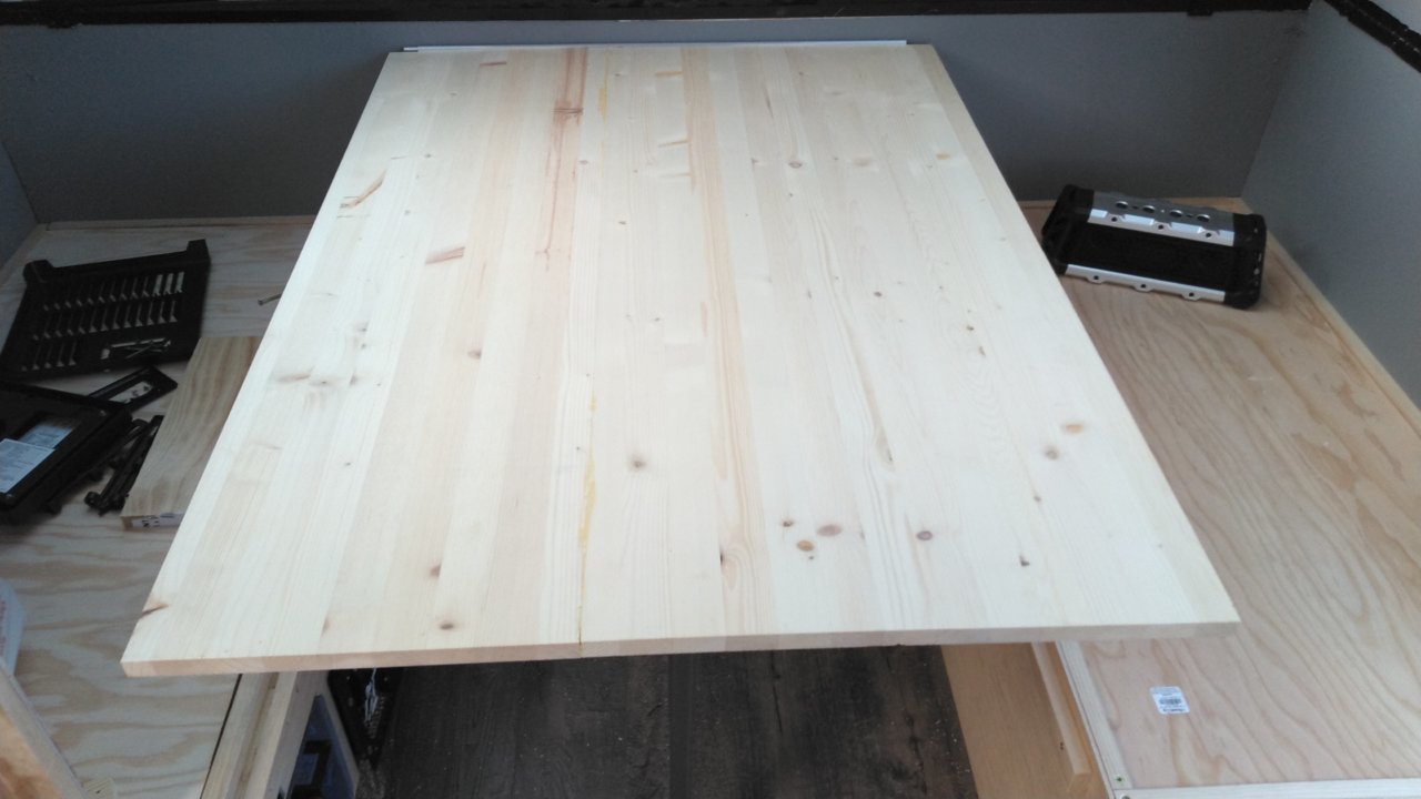

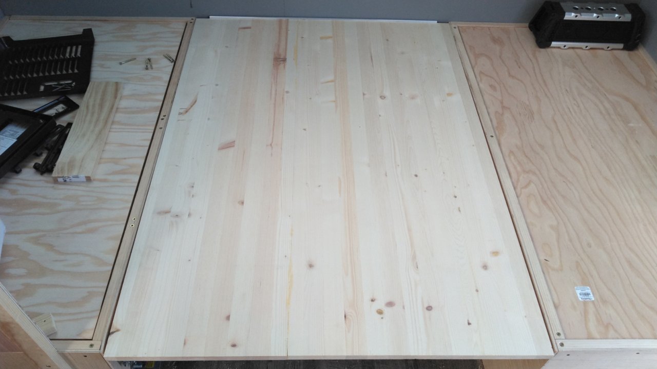

    Got my tabletop made and mounted. This is one of my first surprise touches.
    Table configuration:
    Spare bed configuration:

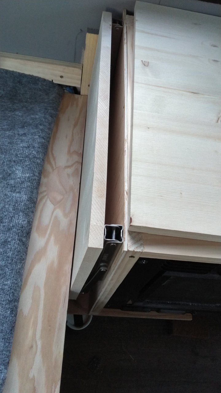

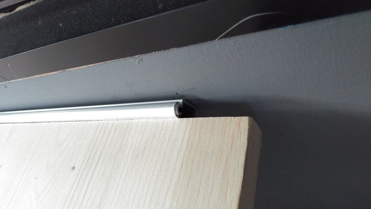

    This rail is what helps stabilize the table top when it's set up in that configuration:
    This is the same kind of rail that is on the outside of the camper where the flimsy gas grill hangs for outside use. That allows me to take the table top outside and use it as an outdoor table.
    I need to put a longer leg or make some kind of block to make this work outside. I'm surprised how stable the set up is. We have a big 3 burner camp chef stove and I think it will be fine using it on here. There is a gas hook up in that round hatch under the table. Should be a nice setup for cooking. I think I might make a longer table that can hook on here that will be covered in food safe plastic so I can use it to clean fish and game outside.

    Got all that mess of wires in the one seat a little more organized.

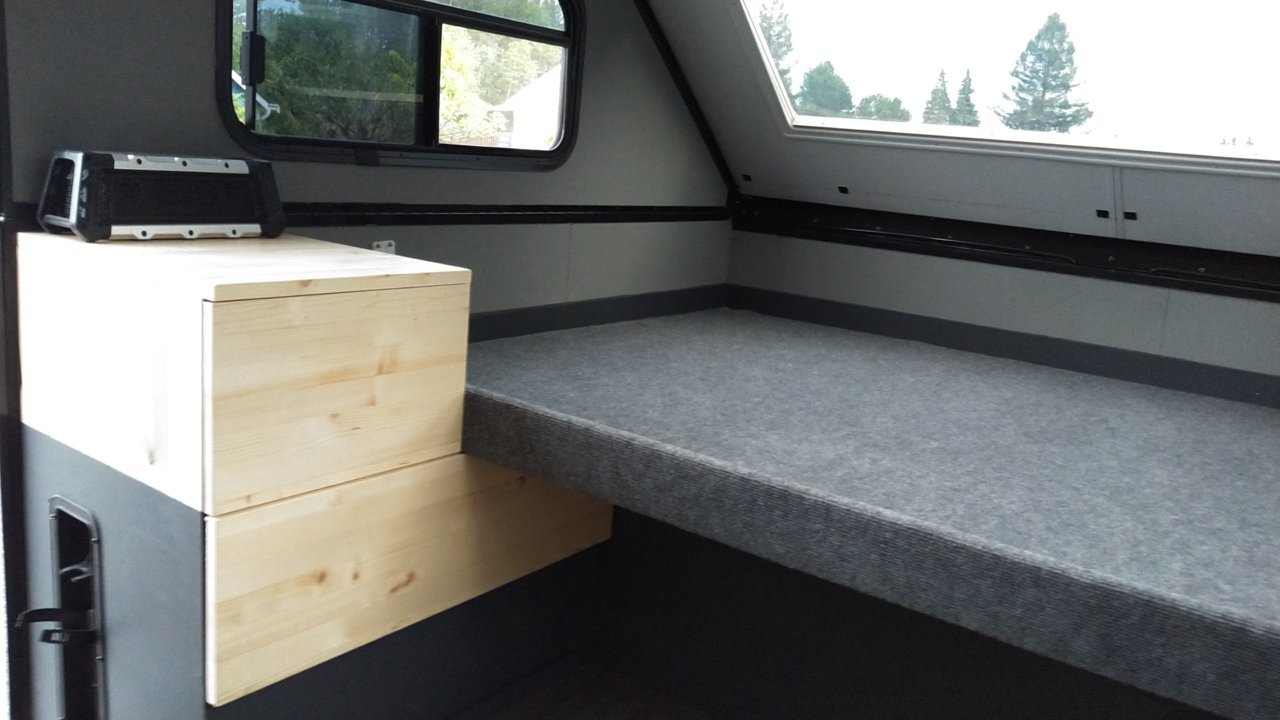

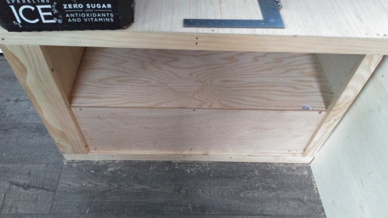

    Spent several hours redoing the cabinet over the wheel well beside the bed. It was one of the first things I built that required more than just standard measuring and I didn't check its squareness and realized when I started cutting panels to cover it that it was too far off for me to let go. I like the new version a lot better, and the fire extinguisher is more secure in the vertical position compared to the previous horizontal position.

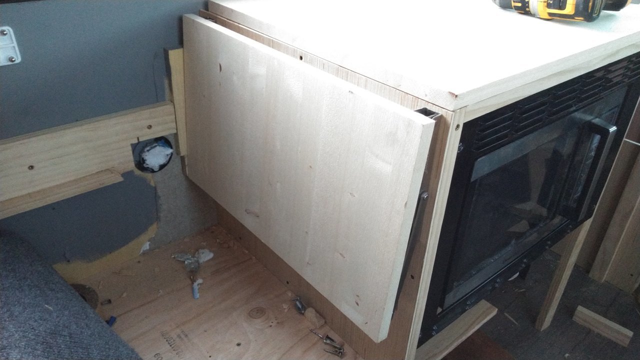

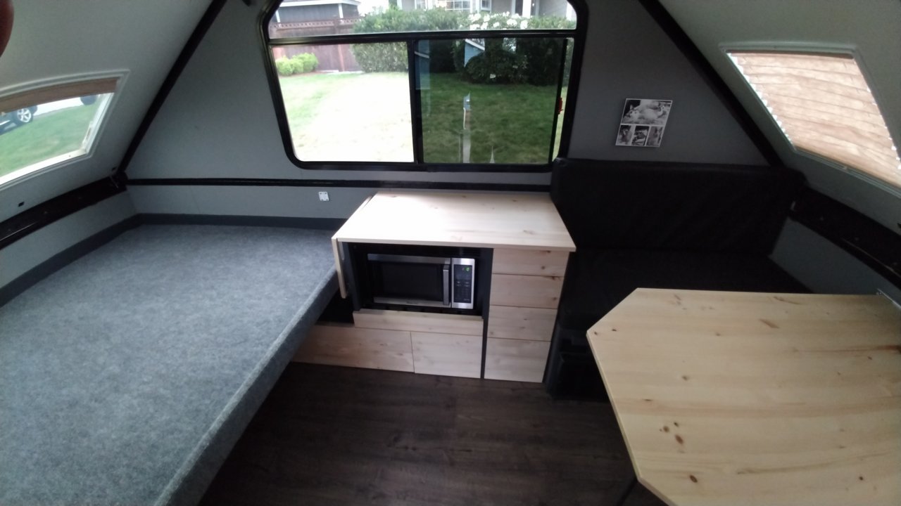

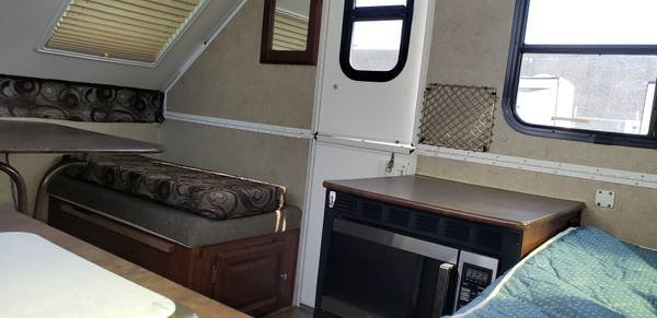

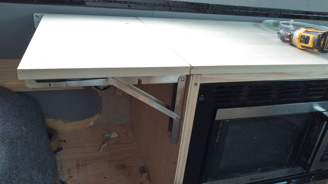

    Got the microwave mocked up. This picture looks weird, and might look like I have no idea what I'm doing. I decided to go a different direction so it looks a bit odd, but it'll all come together in the end.
    Got the counter top put on and put on this flip up shelf on the left hand side as you're facing the counter. I have to adjust the counter and shelf forward 3/4 inch so the cabinet doors I'll build will sit flush with the front of the counter. But this gives you an idea.
    Down:
    Up:
    Down with the bed folded down:

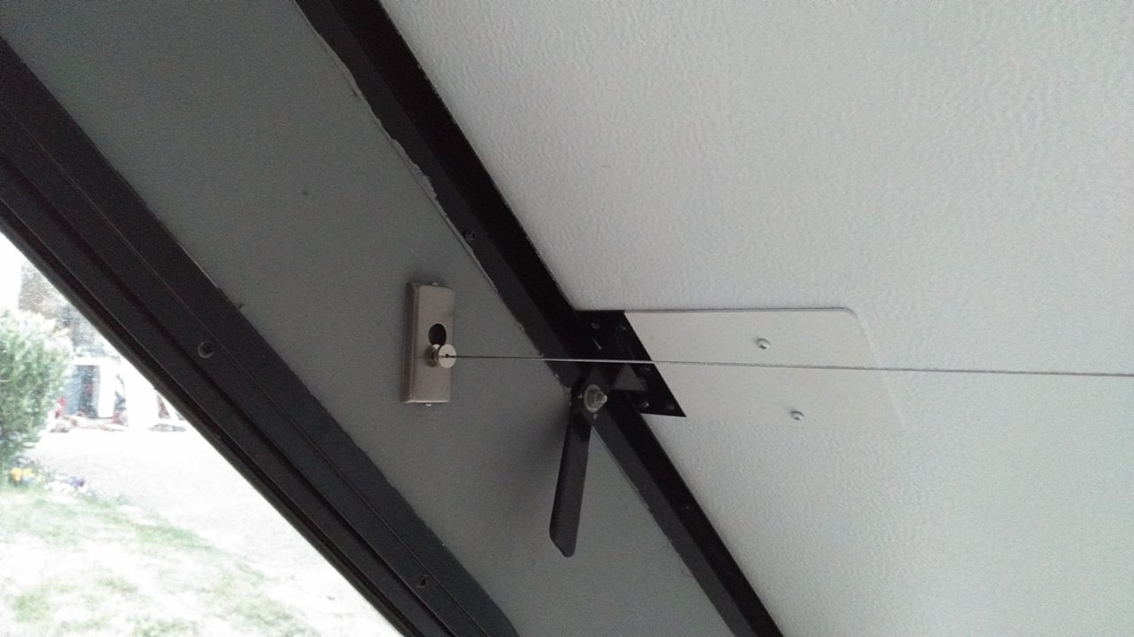

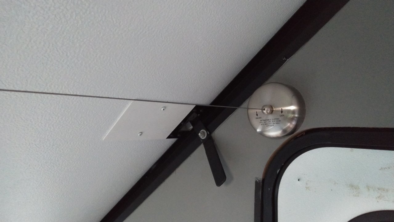

    And got one retractable clothesline put up. I have a second one somewhere. I'll get it installed when I find it.
    It's funny how the little pieces of a project make it all worthwhile. The folding shelf and clothesline really made me happy when I got them done.
