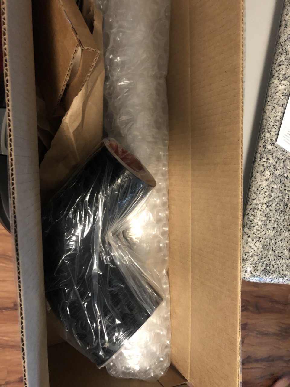

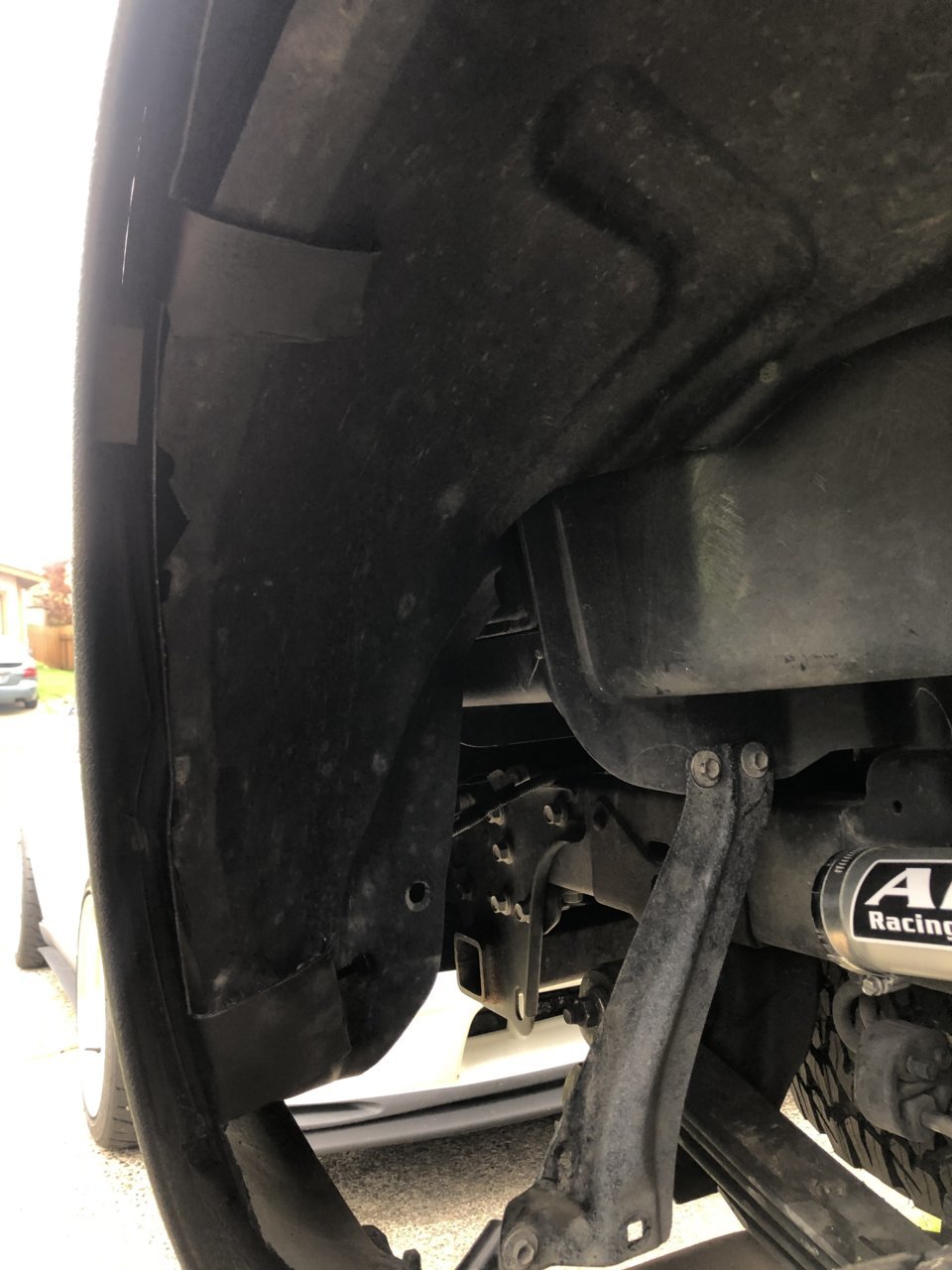

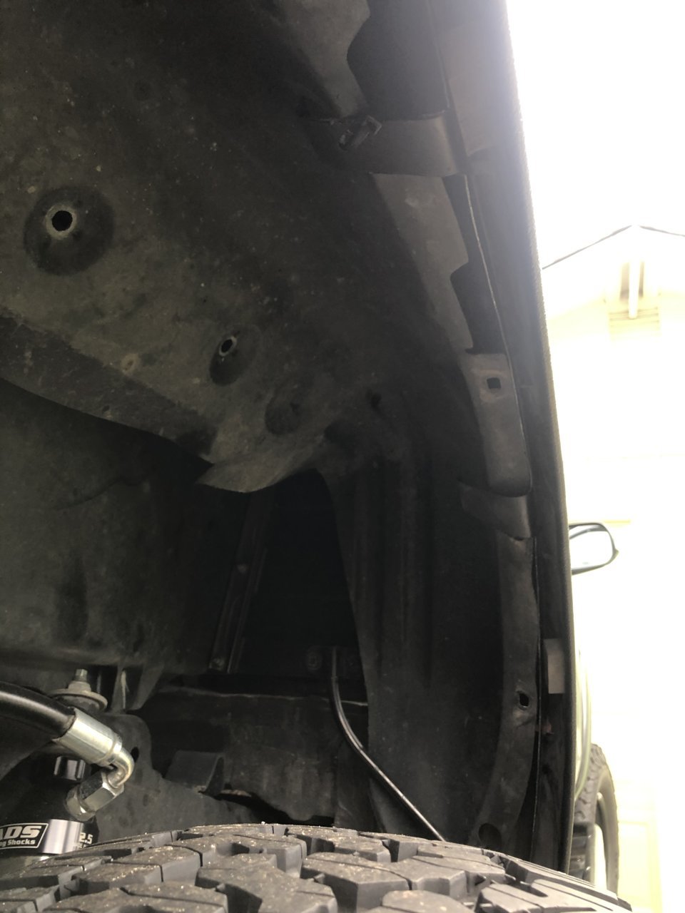

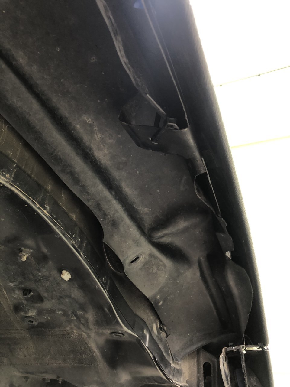

    Hard to take photos with the lighting but you should get the point. Scored these tabs that I just bent up, drilled through and zip tied. On another note, my intake hoses came for he cowl intake

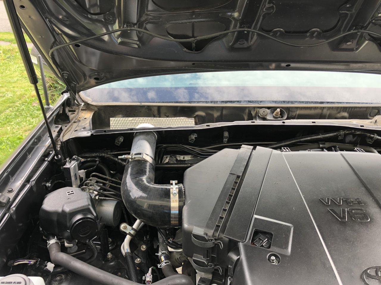

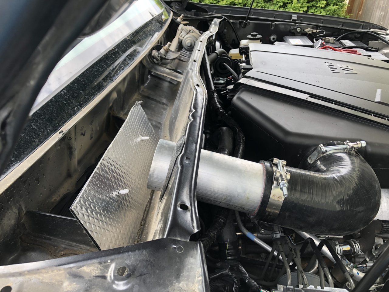

    Cowl intake is done. Haven’t been able to drive it yet since it’s still on jack stands. Hoping this helps with dust in the intake

    Very nice!

    I made a piece of aluminum for the sheild. I still need to get the hose clamps. Should be installing this weekend.

    I just used steel for the shield. None of my local stores had it in stock so hopefully it doesn’t rust a ton. And not yet, truck is still on jack stands. Waiting for my shock to be sent back from ADS. Definitely notice more engine noise inside the cabin
