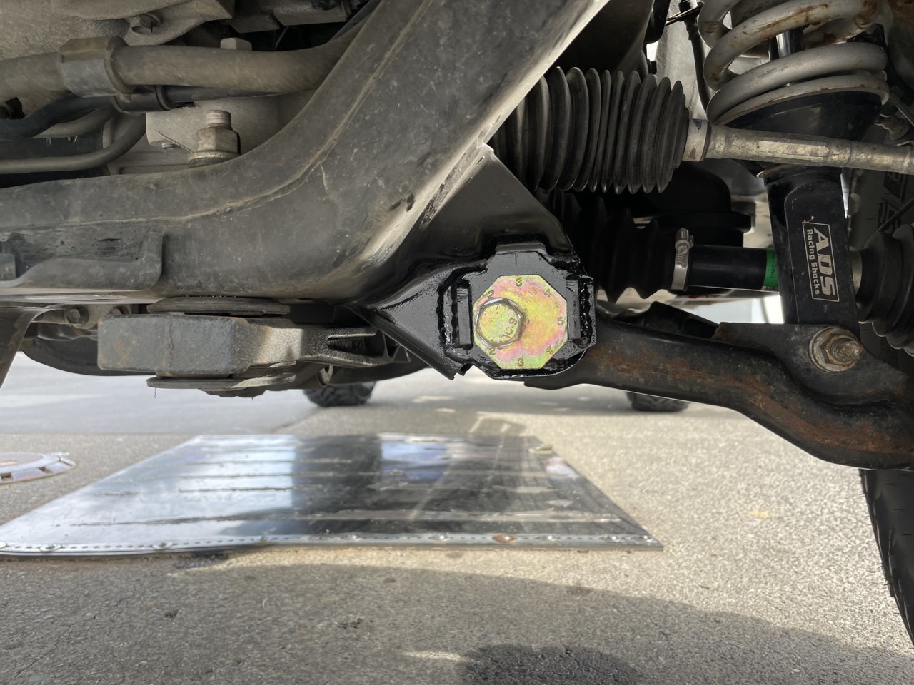

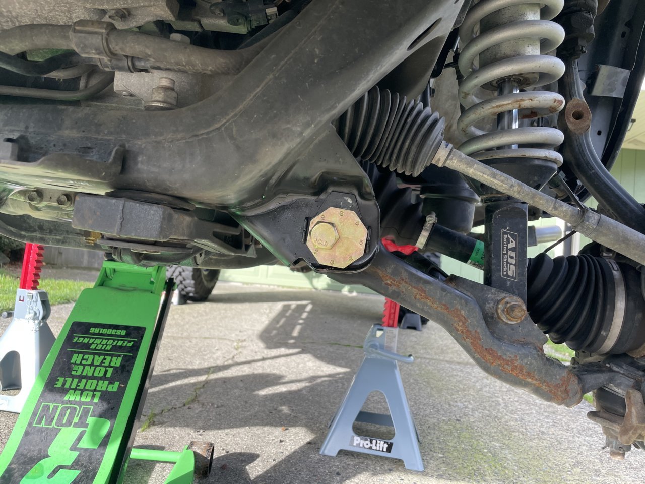

    Working on my @Bison Offroad stop cams. The front sleeves were pretty rusty but my bushings are good. As you can see my tabs are pretty shot. Looks like some cam tab gussets are in the near future. Also por15 lol573C304D-7D7D-4871-BA2C-D05F8C75CB47.jpg1D84E491-468B-4D47-889B-9B4667EF3B84.jpg

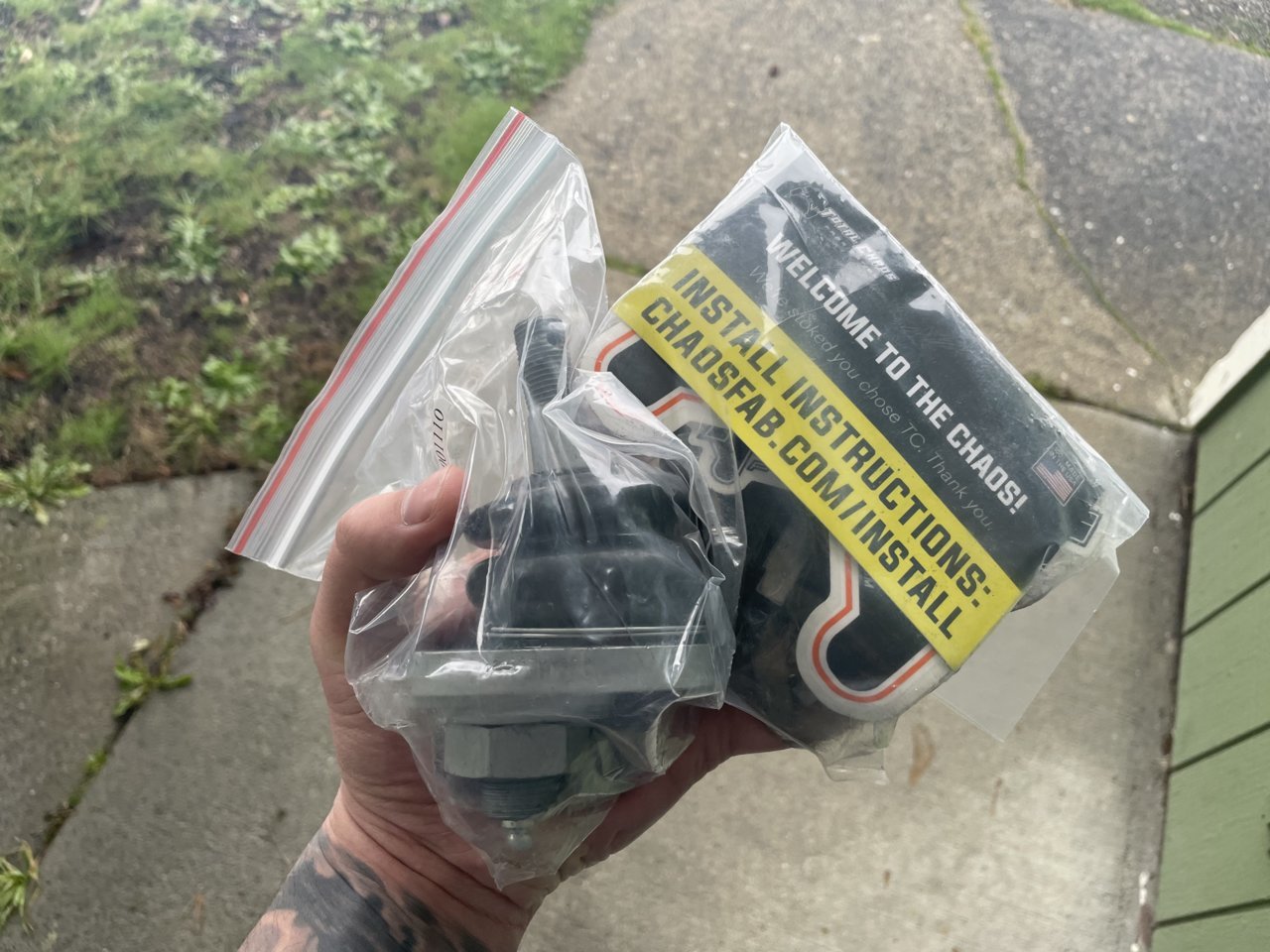

    Ordered some @TOTAL CHAOS cam tab gussets. Also, I noticed my passenger side UCA ball joint was leaking so I ordered a replacement set.
    Hopefully I can finally get this damn alignment dialed in. I’ve brought my truck in for an alignment about 5 times in the last year. The oem tabs are bent to shit so I’m not surprised.
    Here’s to praying the stop cams plus the tab gussets will do the trick.
