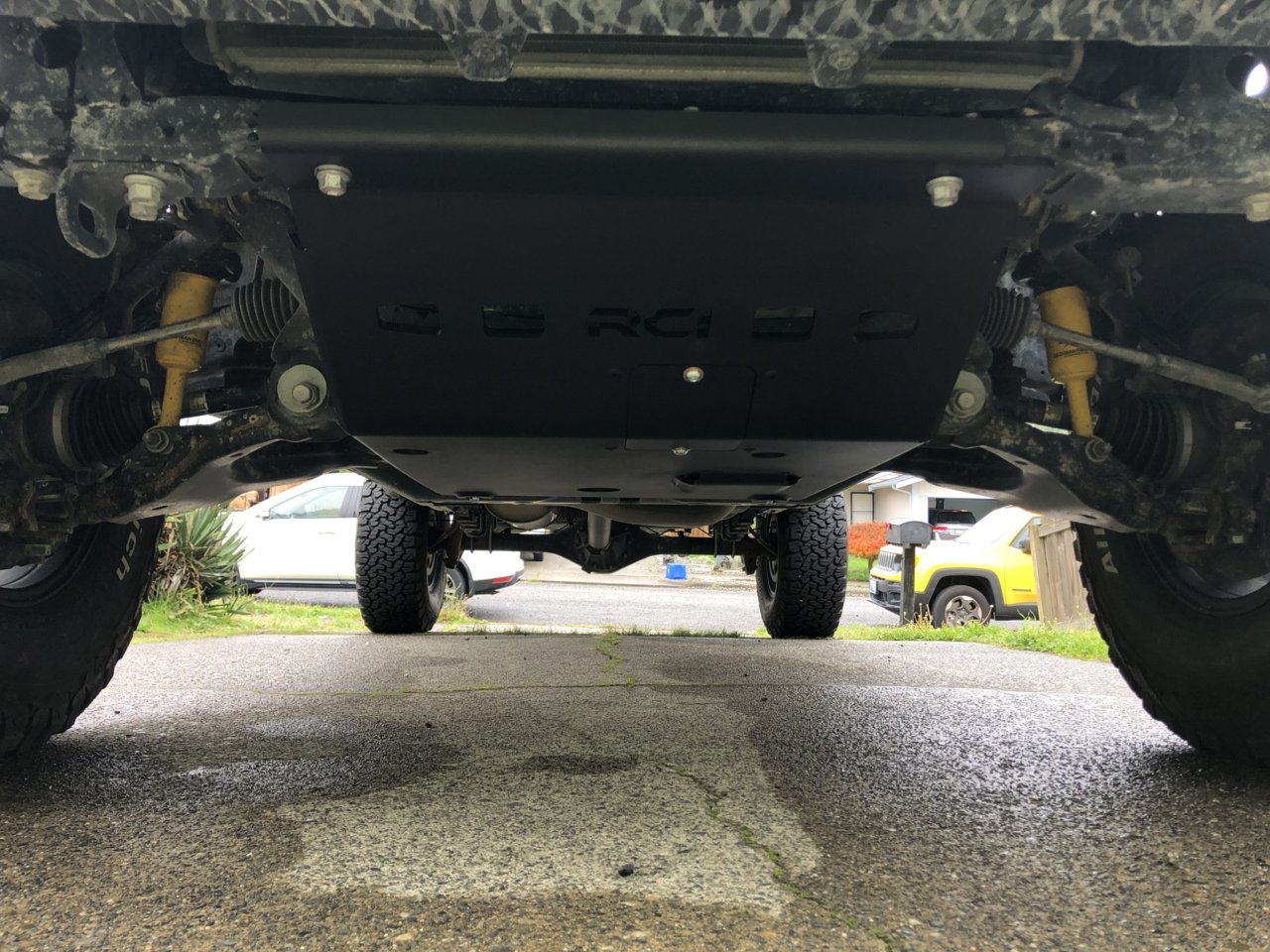

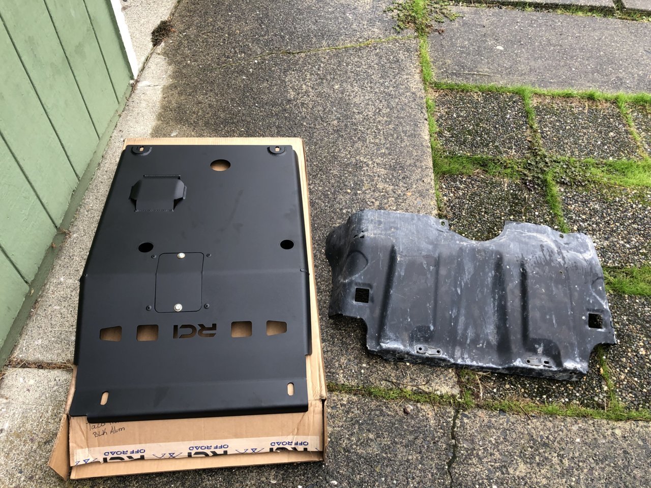

    Front skid from RCI is on. Huge upgrade and quality welds. Went with aluminum for weight saving. I don’t rock crawl and all that so no need for steel. Super nice, will eventually run full skids
    Comparison
    On

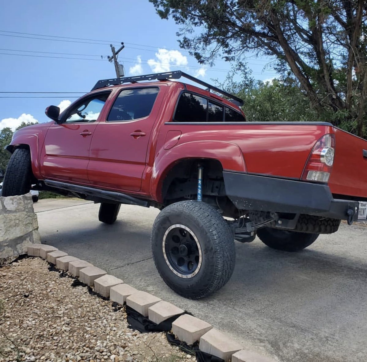

    So I may have gotten sucked into a group buy... deciding between ADS and Kings, extended travel on both. Opinions?

    Both have a similar build quality which is excellent. ADS is a smaller company the trucks I’ve rode in with them rode phenomenal but customer service from what I’ve heard is on par with king.
    I have Kings and really enjoy them you can’t go wrong either way. I chose king first I landed a fair deal on them and 2nd most shops are already familiar with them come rebuild time.

    One thing to note that type of suspension does require some maintenance. Nothing wrong with your current setup. I had ome previously only thing I didn’t like was the lack of rear downtravel with the shocks.
    The ride difference is better with the high end shocks and a little bit more travel.

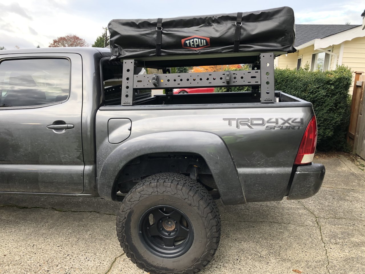

    If your really looking to get some rear travel I’d just get the front and for the rear get a shock relocate kit, hd shackle hanger, and a smoothie shock depending on the vendor you go with 12 or 14in.
    I have this setup from bamf top notch products and the ride compared to oem geometry is night/day. And for the total cost it was cheaper than 2.5 resi rear shocks but labor install may get ya unless diy.
    truck yoga
