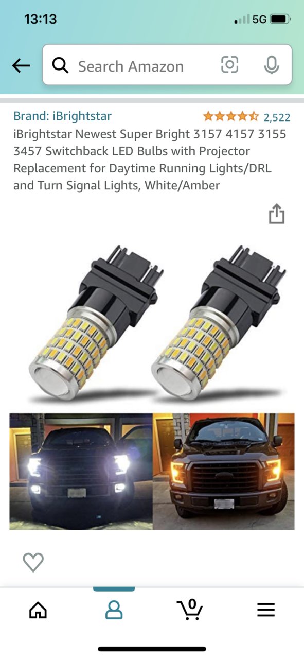

    Sorry to dredge up this old thread but wanted the community to know about a bulb that didn’t work for my truck. 2015 with 3 wire harness and DRL on the light switch. Bought the ibrightstar from Amazon. They were amber only. I did try to pull and reverse to make sure they were in both ways but they are going back today.

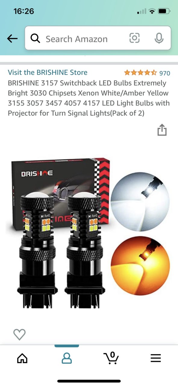

    Ok. Follow up on the next try. No good. The brishine shown here do the same as the others. They light amber when the switch is in the DRL position and stay amber when blinking. When I turn on the headlights these stay on but go white. Not what I want at all. I’ll try again.

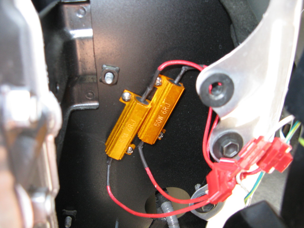

    Topic beat to death over the years.........A couple of resistors installed behind the rear tail lights solves the hyper flash problem. I installed LED's, front and rear, 7 years ago - switchbacks from Amazon (7 year old technology) and they still work today as they did then.Resistor.jpg

    What......... 10 bucks for a resistor kit and 25 bucks for a pair of 3157 "CK" switchbacks, another 15 bucks if you want to do the rear signals (all Amazon) I don't understand why this is so complicated.......
