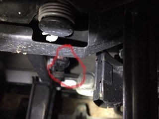

    Old Thread, I KNOW but the ScanGauge II shows under CANSF for Toyota codes for the Ambient Air Temperature. I entered the code for the F degree one and no go. I just went out to my 2015 and found one just below the hood latch I will upload a picture. I named it something other than AIR did I screw up and I am assuming the 0 are Zeros not O letters. This is what I used from the ScanGauge II website.

  10. Jul 5, 2022 at 10:01 AM
    #30
    Maryland TRD
    Maryland TRD Member
    Jul 5, 2022
    #400728
    22
    To follow up on the above post! I also have a 2015 Off Road TRD. No stock ambient temp display. So I have bought a Gentex mirror and mounted it. I was just about to run the wires for the temp sensor, and as I look at the front pillar behind the grill, bingo! An ambient temp sensor already mounted! I’ll include a photo! So what is the sensor for? Is it for the AC? Doesn’t make sense the system is so basic. Why is it there? Can I just tap into this for the Gentex mirror. Do I have to mount the Gentex temp sensor right above it? Rather redundant. Just a bit confused.

    Yes that sensor is for the A/C Amplifier only, no you can not tap into it or read data from it.
    Yes you have to run a separate sensor for the mirror.

    First mod I did after I got my truck. My previous vehicle had temp and compass display on the main display screen, but no auto-dim. I got the Gentex 455 dual constant display auto-dim kit from Bob's mirrors. It included the harness kit with sensor run to the front of the radiator. Fishing the sensor wiring through the firewall was challenging, but otherwise it went fine.
    I also discovered this model displays an "ICE" warning on the display when the temps drop to 38 degrees or lower to alert the driver to possible hazardous conditons. It alternates between that and the compass/temp reading for about 40 seconds and then returns to the normal display.
    Dm93 likes this.

    What he says above!!! Bob/Bob's mirrors also warns against messing with this sensor and/or tapping into the wiring: It will immediately destroy the sensor and the amplifier, fry the mirror and possibly other expensive A/C components. I cannot say what year this change was made by Toyota.
