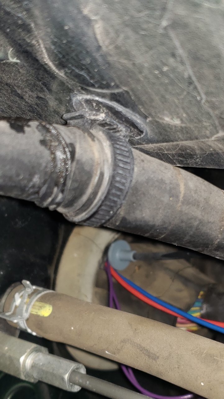

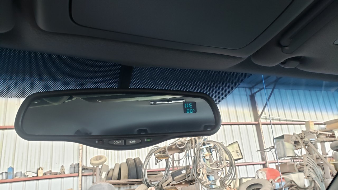

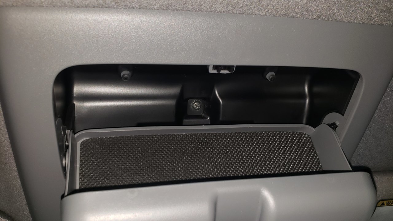

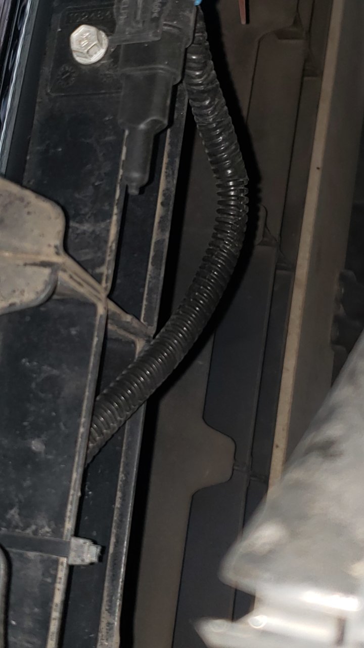

    The mirror installed.
    I chose to run the wires through next to the hood release cable as I have a manual and don't have a blank plug where the instructions show (purple wires are the temp sensor the others are for my air compressor).
    And I mounted the sensor to the grille with a self tapping screw.
    The kit comes with pretty detailed instructions on routing the interior wiring.

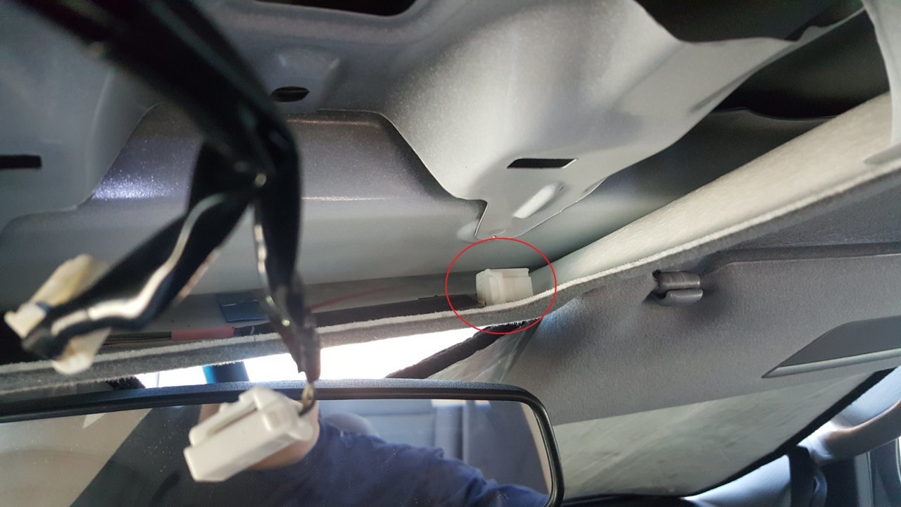

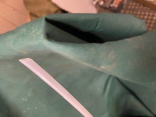

    OK Got Er done, the instructions were great. Install in an hour?? More like 3-4 hours. First you do not need the $14 wire cover it looks fine without it. I plugged in the mirror to the plug in the overhead and just pushed the wires under the lip of the headliner. When removing the cover and handle on the left side, you need a piece of plastic to pry off those screw covers, I used a piece off a Bondo spreader. The screws are 10 mm do not even think about a Phillps, way to tight.
    I followed the hood release cable when going thru the firewall. Used a sharp wood lead pencil to make an access point from the engine bay side and then 1/4 ID nylon tube cut at an 45 degree angle, pushed it thru and then guided the taped purple wires inside the tube. In fact I left the tube in to protect the wires. On the top side of the dash, same type of tube to fish the wires down. I used Top Hat crimp connectors, twist the bare wires together, insert and crimp all done inside the car and then put behind the kick plate.
    The compass is pretty accurate and I did set the zone the thermometer is also right on! A very worth while addition to the truck. Thanks to Dm93 and the rest of the folks.
