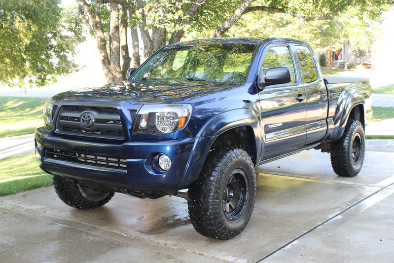

    3" lift OME lift 887 coils, LR UCA's, 16" Stealth Custom Series Wheels and 265/75/16 Duratrac Tires
    3" lift with 265/75/16

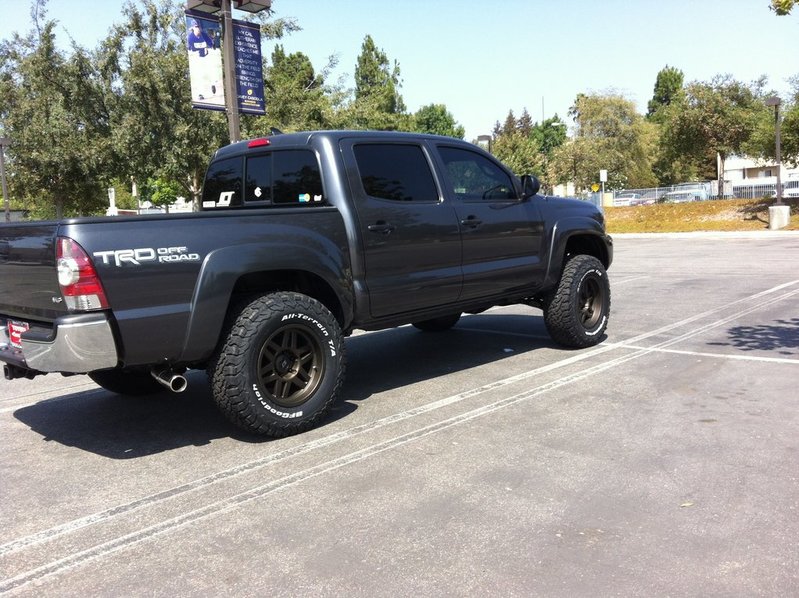

    Both. 285/70/17 BFG KO2's with blistien 6112's and Light Racing UCA's up front
