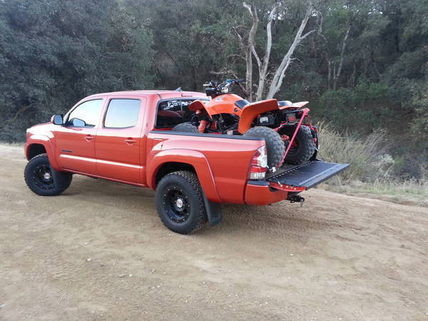

    #1 Frame flexing. This is pretty “visible” to put it lightly. Just driving at h/w speeds, I can see (in my rear view mirror) the bed pulsating on rough patches.
    Question: Is this normal?
    #2 Plastic in bed: The tailgate lip (the plastic overlay) has a quarter size hole from ATV loading. I get-it, it’s my fault to have it nicked. But plastic on bed?
    Question: What kind of protection do you guys have on your bed? Any diamond plate covers out there?
    #3 Anyone rhino lined your bed? the bed is damn smooth. I need the bed to stop skidding small items.

    The entire inner bed is plastic. The only steel is the exterior body panels, which is probably what you see flexing in addition to the frame at high speeds.
    For the sliding issue, I bought a rubber bed mat and it's put an end to things sliding around. Too much sometimes, as I have to remove it when I load the whole bed up so I can slide things easier. It's super difficult otherwise.

    The frames on the Tacoma are much stronger than you think. .. A truck frame made too 'stiff' meaning there is little to no flex during normal driving, will feel solid on the road, but not good when getting real rough, meaning it's more likely to permanently deform than say a good C-channel frame like the Super-Duty's. The F-150 and 1/2 ton Dodge frame's are shit because they are made WAY too stiff and ride on the road great because customers demand a more car-like solid ride and sacrifice the trucks ability to take a beating. A frame made to flex a little more can withstand more punishment.
    The Tacoma's frame is Boxed front, double C-channel in the rear, meaning it's designed to flex more during low frequency impacts to absorb the high frequency hard hitting stuff and remain straight when settled. Not saying Tacoma's are as strong as Ford S.D., but when studied carefully it's impressive and can take a beating.
    The Tundra's frame is mostly boxed, but that's based on the 200 Land Cruiser that is super strong, but not the right choice for a pick-up because it 'jitters' over rough terrain for being too stiff, leading drivers to a 'loose' not solid feeling.. but that's what what they had to play with.
    The plastic bed in the Taco is not good in the front section, and corrosion protection is weak, maybe 2016 it will be all addressed
    I'll also say this: Stock suspension on the Tacoma is garbage, the softness actually causes more visual deflection between the cab and bed.. stiffer springs/dampers is a must (I Chose OME with leaf packs... perfect) to truly get the most from the chassis in-terms of handling/stability, load capacity and towing, plus the way I see in the mirror, less bounce.

    1. Normal, it's really not that bad.
    2. Be honest, you did a lot more than just 'nick' it... Sure, the bed is composite but it still takes quite a bit to put a hole in it.
    3. Rubber bed mat.

    I do not use ramps. Instead I lift the front up and walk the quad until the front tires land on tail gate, then lift the back into the bed. The belly got hooked.
