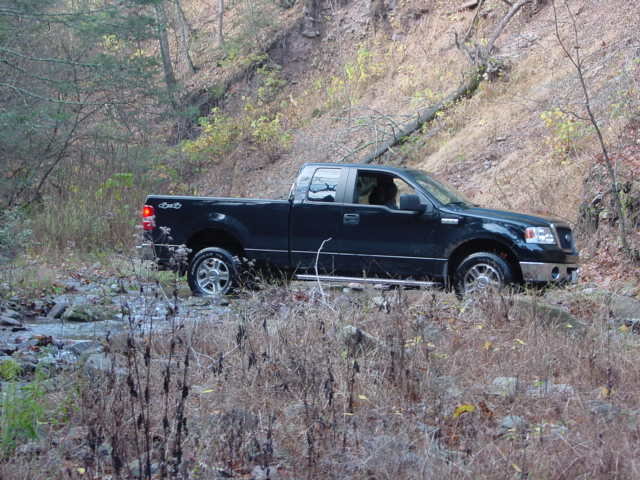

    I know what you mean about a $40k truck. It was hard spending the $32k for this one. In 2008 I bought a new F-150 XLT 4x4 for $24,800 and it's 3 times the truck of a 2017 Taco whatever model.....sorry venting.
    WIMG_0038.jpg First pic with stock tires and my Hooters girl girlfriend driving:)
    Second pics is with 285/70R17 upgraded tires and had also upgraded Hooters Girl to my wife at that point.
