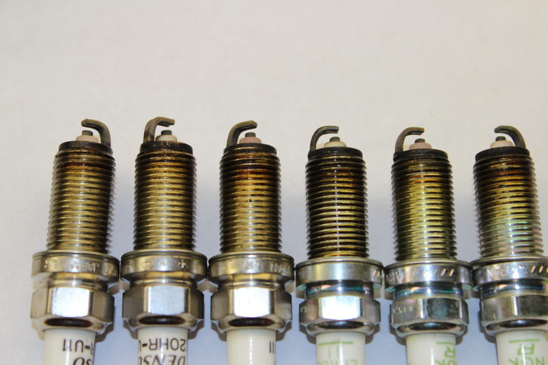

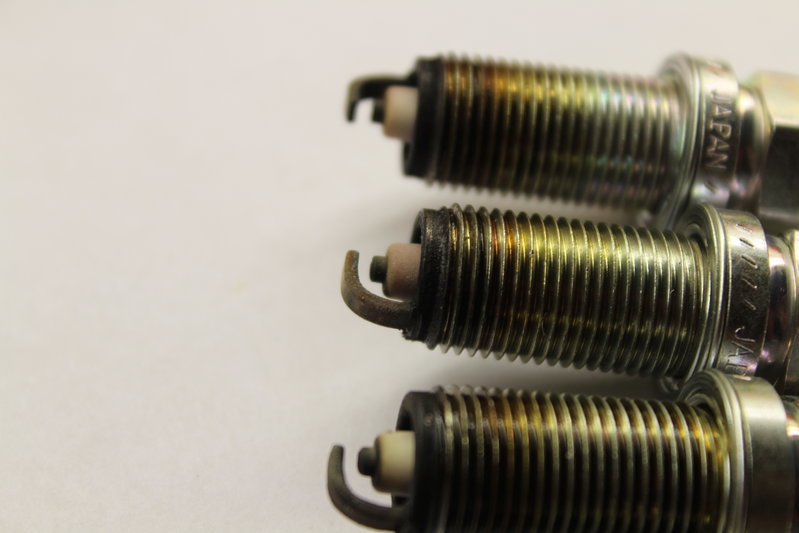

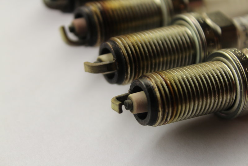

    I like your logic Ben and the development over time seems plausible. I don' know how long this has been happening as I just started driving it again at 27k miles. Around here Seafoam is a reputable fuel system cleaner/deposit reducer and one Toyota dealer recommended I try it. I put 32oz (two cans) in and filled'er up with 93octane. 1oz per gal it says, and what's our tank 21 gallons or so? I drove it the entire day the next day on a trip to the mountains and it knocked away. Next tank 93 octane, still knockin. New Toyota spark plugs (Denso) still knockin.
    What do you think of the plugs that came out? 31k miles on them. There is some reddish tint on a couple that I didn't see before. I just

    2015 DC Off Road
    Looking at these pics would you go colder based on your own experience?
