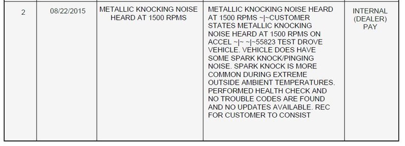

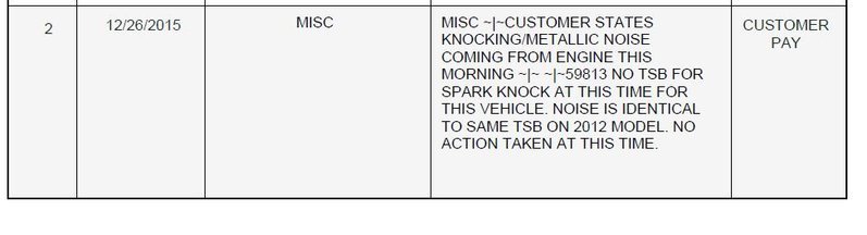

    Mastertech told me valve chatter was only resonance through the aluminum block. He said the aluminum block only just amplifies it and the engine could go over 300K miles with the sound. He said the timing chain tensioner would fail or need to be replaced long before the death of the engine.
    I just kept getting documentation:
