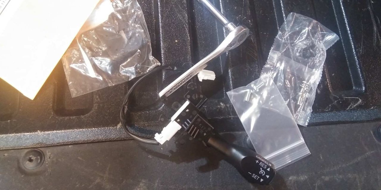

    892
    2017 2.7L/5MT AC Utility 4X4
    I did the cruise mod tonight on my 2017 SR Utility 2.7/5MT. The switch I bought was $18.99 on Amazon and had the wire harness and screws. https://www.amazon.com/dp/B07F14CZS3?ref=ppx_yo2_dt_b_product_details
    $10 Cover from ebay also had the switch screws.
    https://www.ebay.com/itm/201813078165

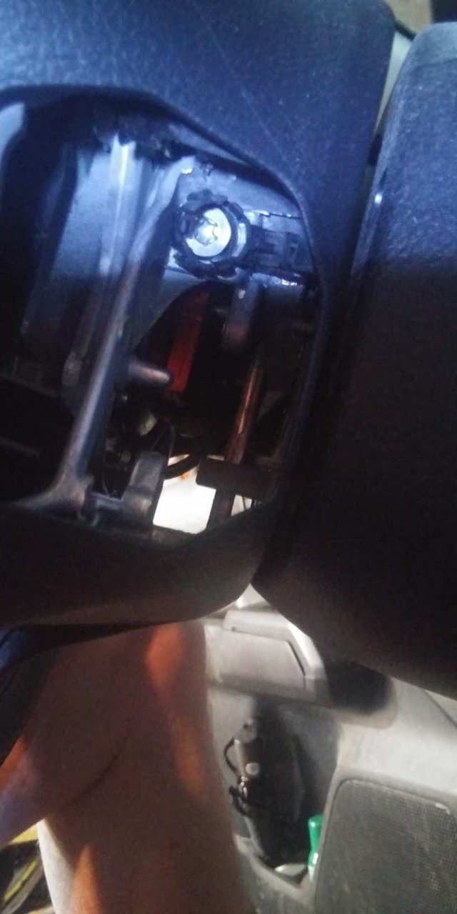

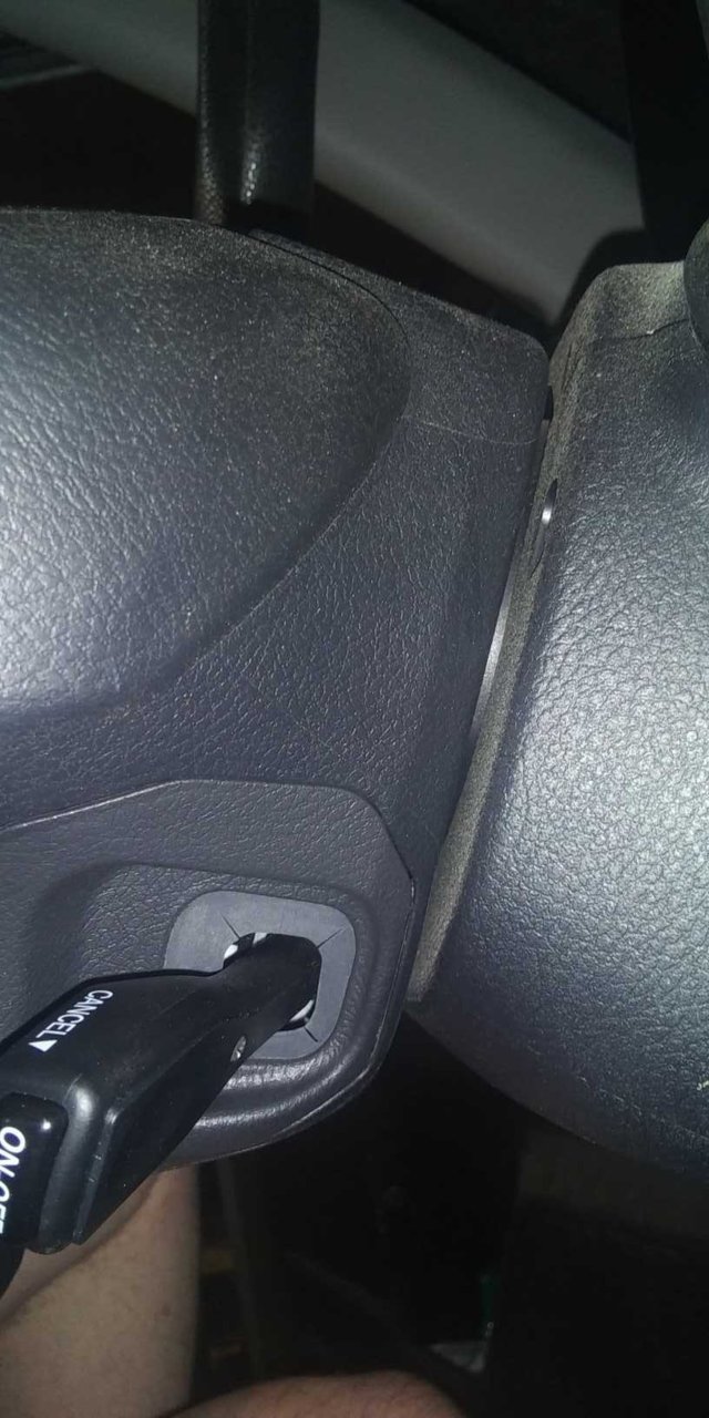

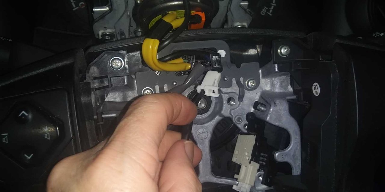

    Install was extremely easy. I went out to the garage at 7:55 and moved my wife's car out, my truck in, changed the switch and put my tools up, her car back in, had driven the truck down the road to test it and was back in the house by 8:15.
    The only minor hassle I had was getting the airbag/horn button down while getting both captured screws in place. I just reached in and grabbed the plastic screw holders and pulled them gently outward to allow the airbag to slip into place. No problem. Don't know why I waited so long to do this. Super, super easy.
