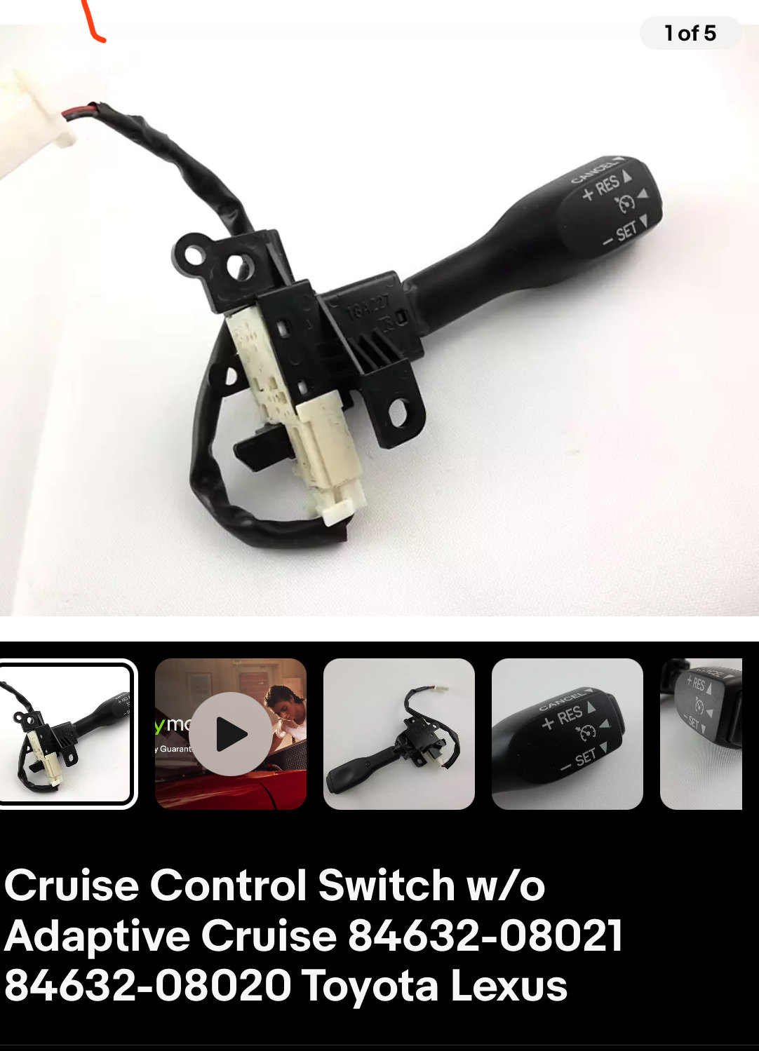

    I just bought this one for my 2016 SR 5 speed manual and it worked. It also came with the wire. I got the exact screws that estebanG mentioned above and they fit perfectly. Got em from Home Depot for under a dollar. That’s all I had to do- works in all gears, accel and decel works, and clutch cancel does too. Thanks everyone for the help.upload_2024-5-2_15-6-47.jpg
