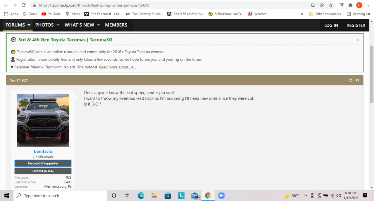

    Just found this guy posting same question 5 months ago with no reply yet. If all the online parts houses didn't list 3/8, 7/16. 1/2 and 5/8"77.jpg as options for 2016-2021 I would say 3/8" is all Tacoma center pin size. Must be a liabilty issue. Plausible deniabilty
