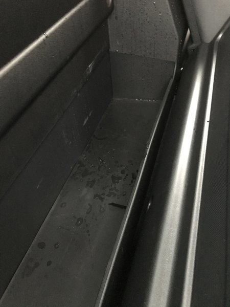

    IMG_0353.jpg IMG_0354.jpg IMG_0356.jpg I know that there are a few posts about this. I found this Sunday morning after a late night thunderstorm. It got the headliner too. 2016 DCLB

    Spent 3 hours at the dealership today, and they have narrowed it down to the third brake light:annoyed::boom:

    I just had the same problem after going through car washes. Dealer replaced third brake light assembly. Had to buy Damp Rid from Walmart to absorb the dampness in the rugs etc.

    I just bought, like a week ago, a 2016 Tacoma Limited with 19k miles. Very first automatic car wash I go through, water is leaking like crazy from the back headliner down my window and all over my back seats. What the hell!!! I just bought this and now it's at the dealer while they try to figure it out. I told them that others are having similar issues with the third brake light, but they seem oblivious. Still waiting to hear from the dealership while I drive a loaner of theirs.

    I just received an update from my dealership. I was told that the third brake light can't handle heavy water. I don't think that they want to replace the light under warranty. So basically, they're telling me that I can't take my car through a car wash. Is that Toyota's official response? I'll find out.

    I had mine fixed a few weeks ago. It took them 4 hours to fix it. It only took two to fix the rear diff when it was leaking. They had to pull the damn axles out and everything on that. I have no leaks on either now. #turdgenproblems.

    Mine is a 17. They said the seal was messed up.

    Did some testing of my own and clearly, it's the third brake light. It's sad that this certain Toyota dealership claims that they can't recreate the issue.
