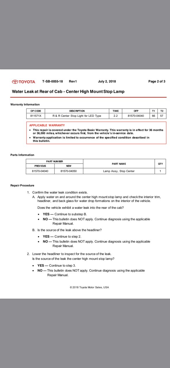

    So I was one of the original guys with this problem back in July of 2017. My dealership replaced the assembly. Two days ago I noticed it was leaking again, I went and dug up the previous service order and noticed they just replaced the defective assembly with another defective assembly.
    If you had this problem prior to July 2, 2018 you should check your service order. If your dealership replaced the assembly with part # 81570-04040 it is just a matter of time before it starts leaking again. Part # 81570-04040 is the problem assembly, it needs to be replaced with Part # 81570-04050.
    Reference T-SB-0055-18
    I have an appointment for Monday back at the dealership. We will see if I get any grief or if they correct the issue.

    Mine was replaced with part # 81570-04050. So far after a few weeks it all looks like it’s keeping everything dry!

    Does anyone know what the actual difference is between the two part numbers? A gasket made of different material or what?
