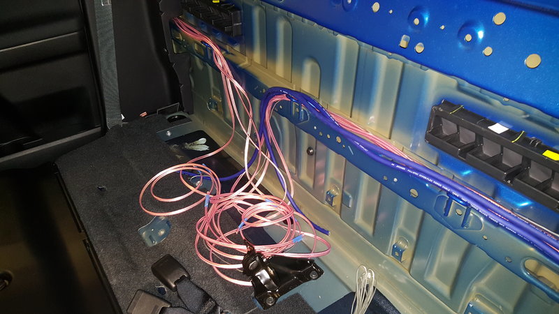

    Completed my install ran power cable from my auxilary battery to the amp in the back, ran 2 speedwire cable one from my oem radio to my dq-61 (loc), the other speedwire from my amp outputs to the radio harness that connects to the speakers, plug in the rca cable output from my loc to the input on my amp, an a wire from remote out on the loc to the remote on the amp..... moment of truth, turned it on and what a difference. With the EQ on my dq-61 I was able to fine tune the sound. I made a temporary mounting panel for the amp and loc until I get my box and amp rack from mr. Marv

    Awesome! Nice job man! Pics?

    Pics will come later right now my wires look like spaghetti, as soon as I receive my box I'll shorten my wires and make everything look nice and neat.....

    I didn't post my spaghetti either. This is what mine looked like.
    Edit: I looked back and I guess I actually did.
