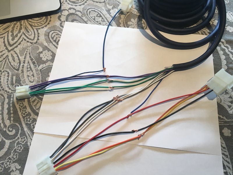

    Hey Jeremy - I just got my speedwire in today. I saw your pic of the completed speedwire/harness setup. In reference to my question re the power to the LOC that was answered by Marv and another member, does your setup allow me to get that power to the LOC without making any adjustments? My Audio Control LC8i has some sort of GTO function which allows it to turn on if it senses a certain voltage to the speaker, but after reading about another member having a delay I thought it would be best to run power to it directly.

    I think I answered my own question. Does this look right? So this will allow me to use the blue remote wire from Speedwire bundle to power my LOC directly to minimize potential delay when stereo is turned on??

    Yeah you can just connect the 9th wire (blue) on the speedwire into the 12v switched wire on the harnesses and run that to the lc8is remote in.

    Yup that's exactly right

    Time to start soldering!!

    How did the soldering go?

    Went well. Definitely feel confident about my connections.

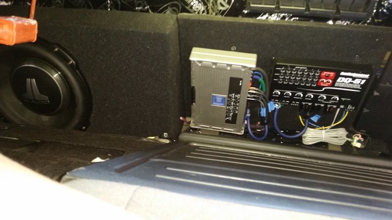

    Ok here's mine, still need to tweak it, like hiding the wires, still have to run the cable for the control knob...other than that marv's box produce nice deep bass.....sounds fantastic20160603_152456.jpg

    How do you like your Audio Control DQ-61? Was it difficult to set up?

    Not a problem at all.
