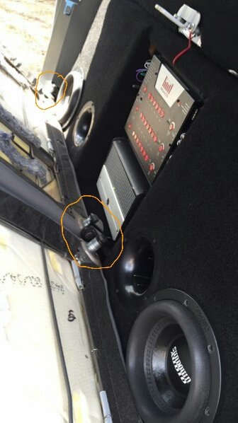

    I didn't place the sound deaden on the floor just the wall and my doors, it is a tight fit for the speaker box I had to remove the back panel from the back seat on the passenger side to make it fit

    There is a fix for that that Marv told me about. You can get longer bolts for the back of the seat and a 3/4 inch spacer. I was going to be doing that soon because I had to take the plastic off the back of my seats too. It's just too freaking hot right now in AZ to do anything outside. It is supposed to be 117 today. Once I do it I will make sure to take pics and stuff.

    Yeah the bolts that hold the back of the seat in place. You should be able to get them from home depot and the spacer I'm pretty sure you could do washers stacked or I think I have seen thicker spacers at auto zone

    I'll stack a few washers......I'll remove a bolt see if I can find a similar one these fasteners that the use to put cars together may be threaded different...

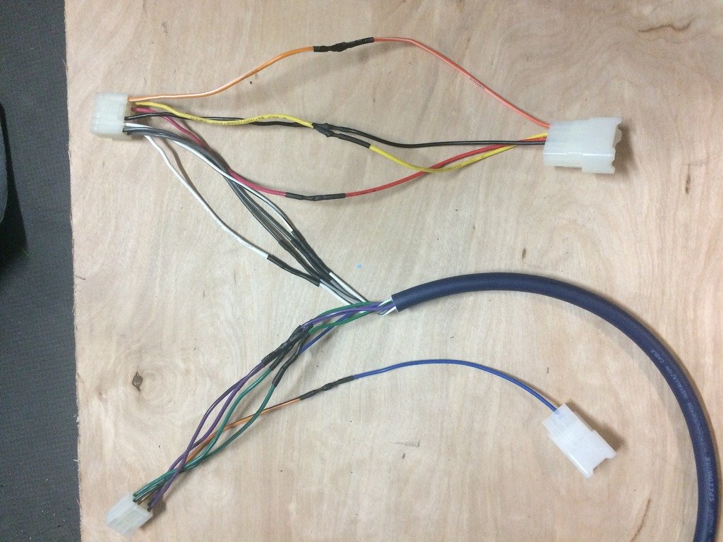

    Finally got around to soldering all my connections.
    Did I get it right ? Only one I wasn't sure was the orange striped wire to blue wire...

    Looks nice and clean. Perhaps some tape to wrap all the wires up? I know its too late to put heat shrink around all the wires unless you depin everything but thats a pain lol

    You have it wired up perfectly. Looks really good.

    Would you guys be able to take a pic of the bolt you guys are referring to.

    The bolts that hold the seat back on. You can put a spacer in between the bracket and the seat to push it forward far enough to clear the sub and box with the plastic back on it. I haven't done it yet but I plan to.

    I knew I had seen another pic of someone that had done this mod to their seats to push them forward.

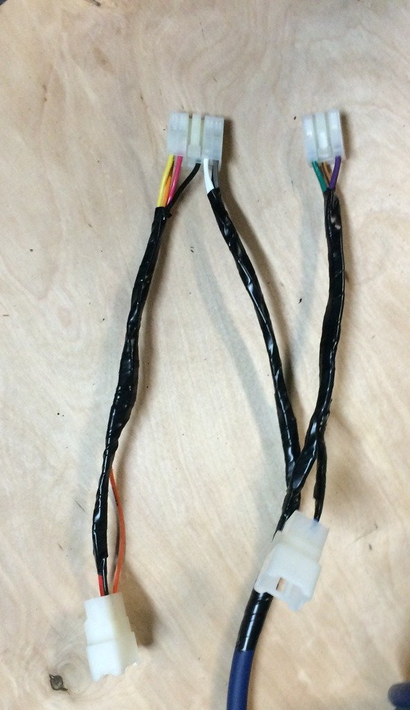

    Cleaned things up a bit and kept the orange dimmer wire exposed so that I can pull from it for my LED light bar switch dimmer power without tapping into any factory wiring.
