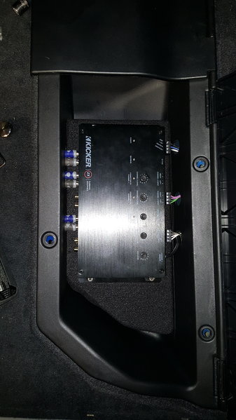

    I agree with @hookembevo. You can get a bass knob for your lc7i. That's what I did with my kicker zxsum8 and it works beautifully. I put it in my arm rest.

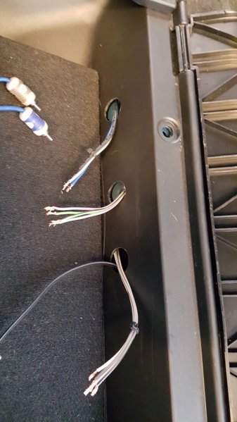

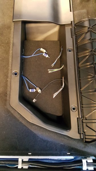

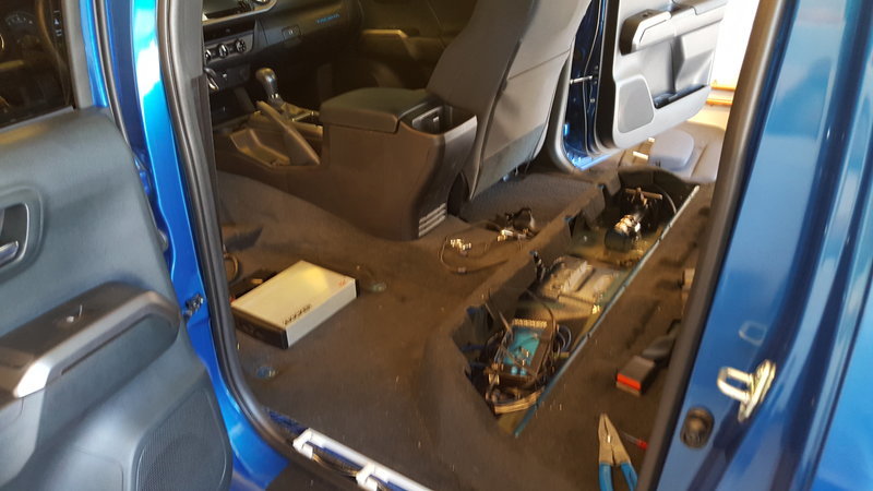

    That gets me to my post for the day. I finally relocated and rewired my zxsum8 with the speedwire and harness I made. I originally and stupidly had it mounted to the back of my amp rack behind my seats. Hindsight is 20/20. With it back there is couldn't troubleshoot or adjust anything on it. I borrowed @Aw9d idea for a small shelf under the back seat in the storage bin. Thanks for that brotha!! Well I must have had something wired wrong because now my sub output on the signal processor works along with the bass knob and the entire system sounds 10x better now. I can't wait for @Aw9d to help me tune it. Here are some pics

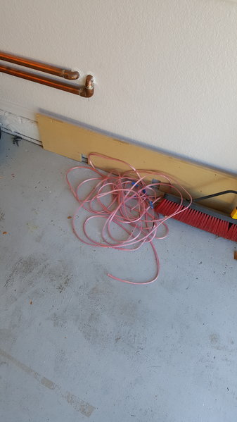

    And this is all the speaker wire that I eliminated with the speedwire!
