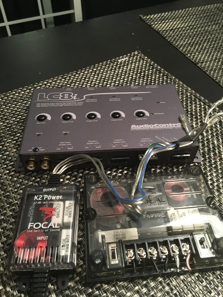

    1. Audio Control LC8i - 8 channel Line Output Converter with Aux Input
    2. Alpine 5 channel PDX amp
    3. Focal 130KR (front)
    4. Focal TNK K2 Power tweeter ( front)
    5. Focal 130KRC (rear)
    I am recycling this from my Mustang which I believe had a separate sub - thus the LC8i??
    I will have to investigate where to put rear crossovers when box comes in?
    Wiring question. I hooked up remote wire from Speedwire to red on Metra harness. That Blue remote goes into LOC Remote In. Remote Out of LOC to Remote In on amp. Question - is the amp only switched on by remote but draws from large 4g wire from battery when ON? Guess I was thinking amp was powered all the time since it is directly hooked up to battery
    Man of Steel TRD[OP] likes this.

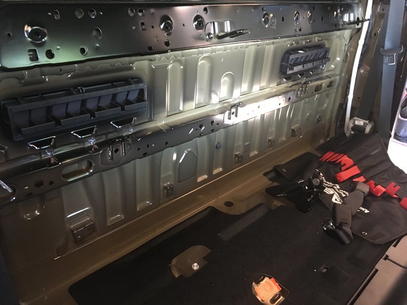

    Dave - I have a 2016 Sport Access Cab and have sound deadened the entire cab
    except the firewall and flooring. The firewall and flooring will be covered with 1 or
    2 layers of EzCool (3/16" Closed Cell Foam (CCF) sandwiched between two layers
    of aluminum foil) when Mr. Marv gets my box finished. The back wall is covered
    completely with a layer of RaaMMat, a layer of Ensolite (high Density CCF), a layer
    of EzCool and the PET sheet that Toyota had installed. I left both vents untouched.
    Both rear posts are covered the same, as are the front doors. The roof has two
    layers of EzCool, including above the headliner console (makes for cooler glass
    frames). I left the plastic water barrier on the front doors (to protect against
    moisture intrusion) and covered it with Ensolite. If you need any repairs on the
    doors, technicians are familiar with the water barrier and know to remove/reinstall
    it without damaging it. The front doors have Image Dynamics (ID) 6x9s and the
    rear doors have 6/5 IDs I have an Audio Control DQ-61 ready for installation when
    Mr. Marv ships my ARC IQ850-5 amp and ARC 8" sub in its custom box. While I
    wait for components to arrive, I am designing/building a platform for Bella, our
    Min-Pin.
