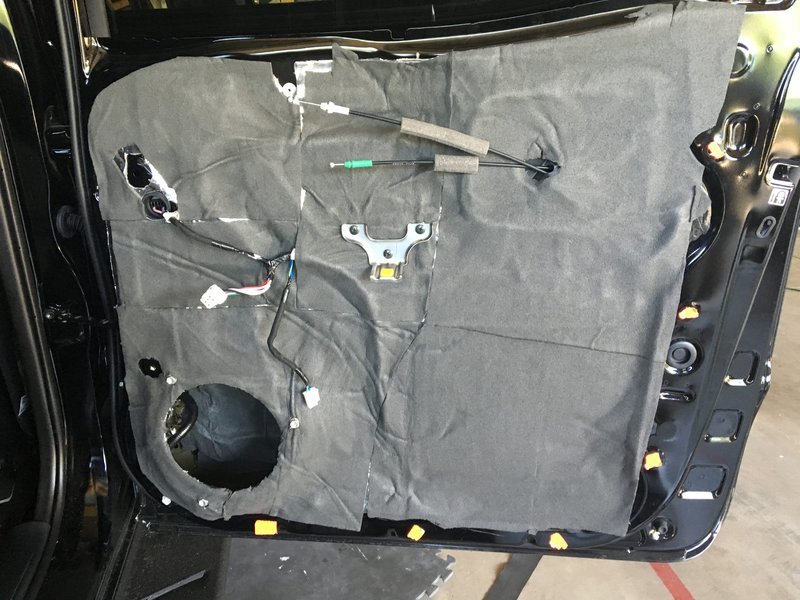

    So I could not get into dealer until mid-September to address door not opening. Just for the heck of it I tried opening tonight.... low and behold it opened right up! I made sure to get the panel off right away just in case it happened again. Still can't understand why it did that. I looked over everything and don't see any areas where it could have been a problem. Crossing my fingers next time I put panel back on.
    Update on my build...
    -Sound deadened all doors and most of rear wall.
    -Ran 16 g speaker wires to all doors and tweeter location. HINT FOR THOSE DOING THIS FOR FIRST TIME - I FOUND IT MUCH EASIER TO FISH WIRE THRU TO DOORS BY LOOSENING THE WATERPROOF RUBBER TUBING/CONDUIT BETWEEN THE DOOR AND THE BODY!! INITIALLY I TRIED TO POKE A HOLE BUT THAT RISKS CUTTING WIRES THAT CONTROL WINDOWS, ETC. I ALSO FIND RUBBING A LITTLE BIT OF FOAM HAND SOAP ON WIRES AND IT WILL SLIDE THRU LIKE BUTTER
    - I was mistaken on the rear speaker crossovers. Fortunately, the larger crossovers were for the front so I was able to place those inside the kick panel.
    - 4g amp wire placed thru firewall
    - Sub box/amp rack should be arriving soon!!!IMG_3750.jpg

    Glad your door opened!! That's awesome.
    Great work on the sound deadening on that door too man. Looks great. I need to go back in and add more to mine just because. It sounds great but I figure why the hell not. :notsure:
    You reminded me I needed to get you a pic of the bracket I have holding my boxes in....
    Here you go!! I wanted to get them perfectly centered but couldn't because of the way they lined up with the holes in the rib.
