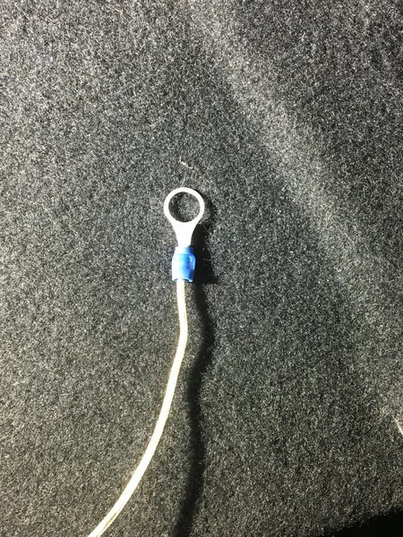

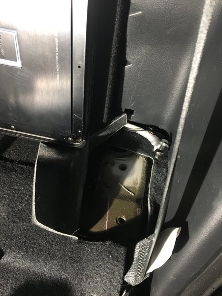

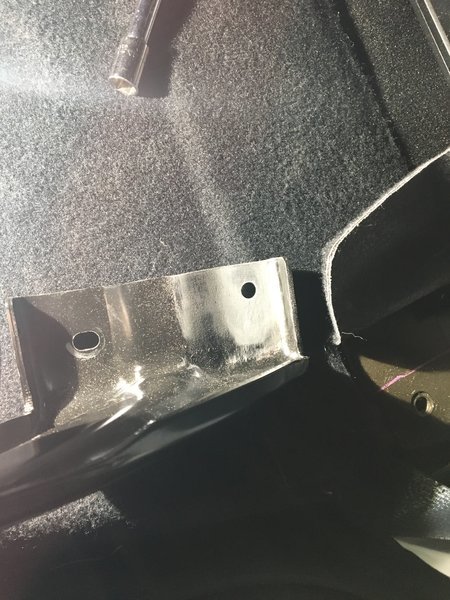

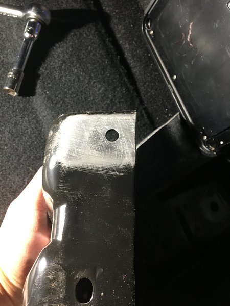

    Got some time to kill so was looking at amp install/setups and decided to make sure I have good ground contact. It seems that a proper ground can make a huge difference. I'm using one of the bolts that anchors backrest to floor board. I took 100 grit sandpaper to expose bare metal on floor, underside of bracket, and topside.
    I originally had ground wire off of LOC with bare wire wrapped around bolt but one guy suggested a cleaner method is to crimp a ring connector on it.

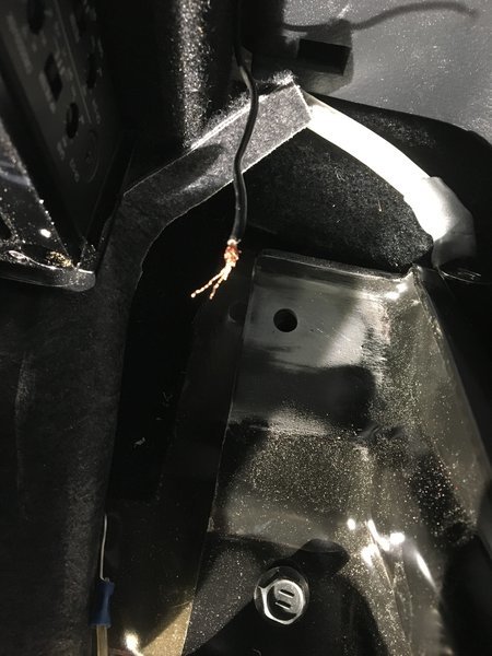

    Definitely recommend installing terminal ring on ground from LOC. I took a look at mine that I had wrapped around bolt - basically disintegrated in my hand. Here's a shot of how thin the wire was ( originally around 3/4" long).

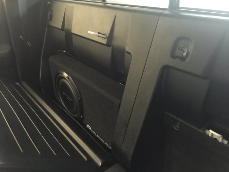

    Who made those MDF speaker adapters? those look great!
    Man of Steel TRD[OP] likes this.

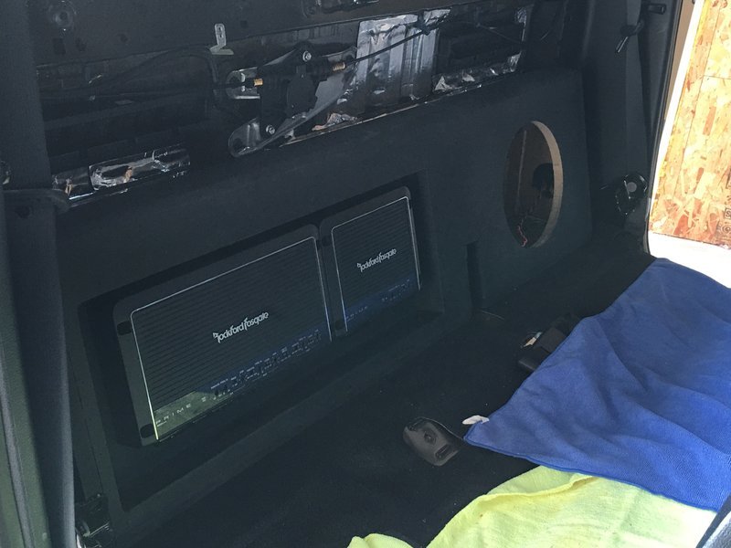

    Ok well I decided to take my 3 day weekend and push forward and get my system started. I built a box for it, mounted my amps, ran my power wire, speaker lines and speedwire. The sub I have is just a little too deep so I am going to have to order a new sub.
    Here is a picture of the box so far. I plan to made a facade that will cover the box and go up above the box to cover the vents and window motor
    I have one question. Right now I have the speedwire going from head unit to LC7i then from LC7i to amps. Everything is working, but I have noticed that when the truck shuts off there is small popping noise. Any ideas what that could be? This is the same amp I ran in my '15 access cab and didn't have that noise so not sure if it is the LC7i causing it or something else. Not a huge deal, but wanting to know what it could be.

    My truck does the same thump with my signal processor. I have done a lot of research and I have not been able to find a fix for it.
    @ratcityrain thathe looks fantastic man!! Well done!
