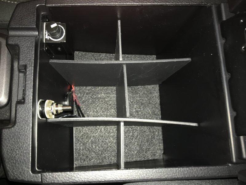

    Bored so had to find something to do.
    Still need to tune my system. Cartoys said it would take them 4 hrs to do at $90/hr. They said it may not sound noticeably different to my ears.
    My biggest complaint is occasional high pitch constant tone in back ground. Not noticeable when I listen to music. When I turn radio off, can still hear it. Gives me a headache.
    So decided to add toggle switch to power up LOC/amp. Easy install and easy to remove if I want later.

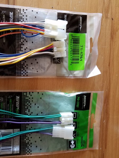

    hey guys, just planning on running just an amp to a pre made sub enclosure. Which speaker wires would I need to tap into for signal? I will be purchasing an amp with high level inputs. Thanks

    Your best bet is to purchase a factory harness so you don't have to tap or cut any wires

    Thanks for your suggestions, i did read this thread, but just want to know where I could do a simple tap off for signal for the amp. Wasn't planning on going behind the stereo and doing the after market adapter splice. Thanks

    You have to tap into the speaker wires - whether it be the front or rears. I believe the fronts can also be found in the kick panels, but the rears I'm sure you could find in the center panel where all the wires from the rear doors come out into the cab, but I couldn't tell you what color wires they are in either location. Behind the dash is much easier and honestly it is not hard to remove the deck

    Yeah, I saw a post earlier about the color codes. I really don't mind at all tapping in the factory speaker wires to get the signal and then just run a remote signal to the front somewhere. Appreciate the advice, thanks

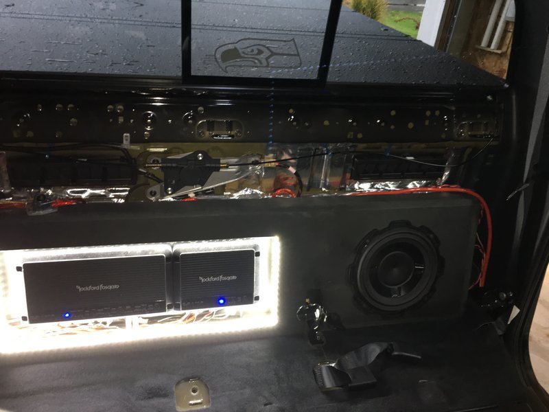

    Ok made some more progress today. Added the sub and some lighting.
    Still need to tune it and the sub sounds real hollow so I am going to add some polyfill in hopes that helps.

    For those who have a sub box in the back - do you have any rattling or vibration on the back wall? I did put some sound deadening there, but still rattles pretty bad. I am just curious if it is only me or if I need to add more

    I hardly put any sound deadening on mine. No rattles

    You can hear the back wall rattling in the cab?
