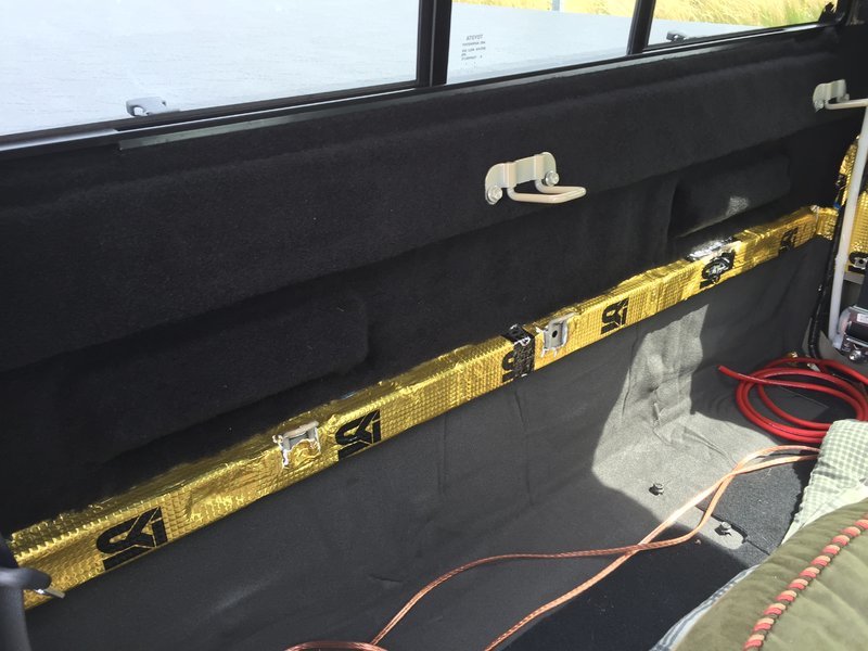

    That is what it sounds like to me. From the outside of the car I can hear it vibrating, but while on the inside of the cab that is what it sounds like is vibrating/making noise. Could be the box itself

    Weird. I added some hushmat back there on mine and don't hear it in the interior, maybe I'm missing it. I can hear it outside the cab, will add more later.

    Have you checked the vents? They aren't mounted very well. Learned the hard way and actually pushed it out from the cab. Had to put rubber around the inside to keep tension on the ears cause they get stretched out easily.

    My vents rattle on my 16. I have my box bolted to the crossbar across the rear wall with a lot of sound deadening. Still have some rattles.

    I noticed how poorly mounted they are. no rubber grommet between the hole and the plastic vent, only rubber on the outside. If you center the plastic piece in the hole and add a couple of drops of epoxy in the corners I think it might help to keep plastic from making contact with the metal

    When I did my carpet on the back wall I overlapped some around the cut out for the vents. When I pulled them back into place they were much tighter in there.

    I applied deadener right up to the vents and covered them completely in carpet. No rattles at all.
