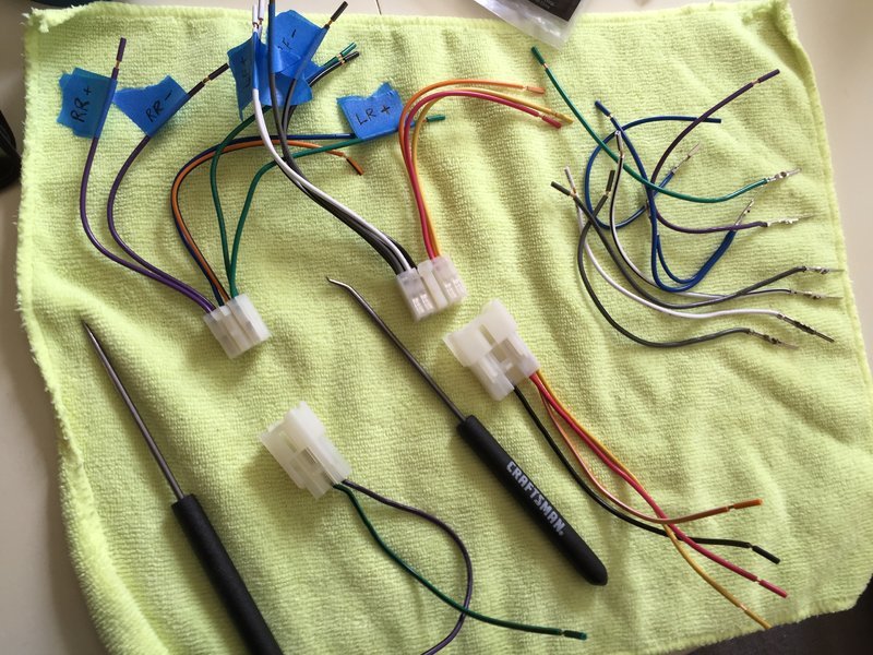

    There are a lot of peeps here asking questions and since I didn't go this route I haven't really been able to fully answer all of their questions. I think if you post the finished product of how they get wired in and plugged into the deck they will really appreciate it. Thanks man!!

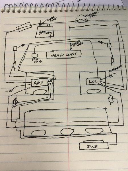

    My plan is to use the speaker wires comin off the harness and connect it to speedwire. Run the speed wire to an audio control lc7i which is a LOC. Then RCA cables from the LOC to the amp. Going to run new speaker wires to all the speakers and running from the amp.
    Does this quick crappy drawing I did help?! I'll have more pics of the completed Metra harness soon.

    Yeah definitely will do. I plan on taking my time installing all this as I'm popping my cherry, so it might not be fast enough for some. Harness will at least be finished soon for people to see.

    You are as good of an artist as I am. Haha. I totally understand it but I think once you post the finished harness it will turn some light bulbs on. I think I'm going to replace my kicker xzsum8 with an lc7i as well. The kicker sound processor has been nothing but a pain in the ass.

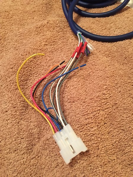

    Wrong Metra harness. Needs to be the one that plugs into the headunit

    Good eye, they did hook the speed wire to the wrong end
