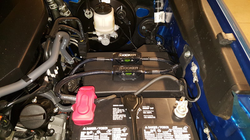

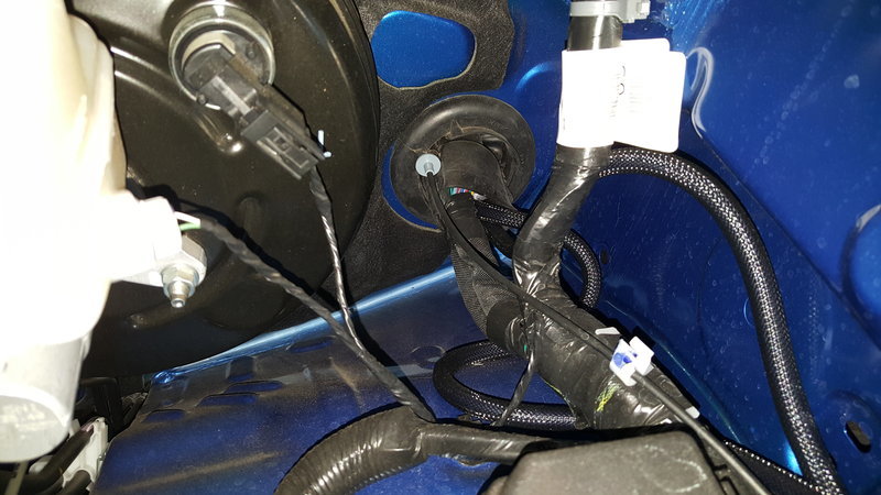

    Yes I did. So for the 2 amps I'm running I went with two 4 guage kicker amp kits. I went through the firewall using the grommet for the main harness right behind the battery.
    What are you going to be using for your system? Are you just replacing the door speakers and just having the factory head unit power them and adding the 13 inch sub and amp?
