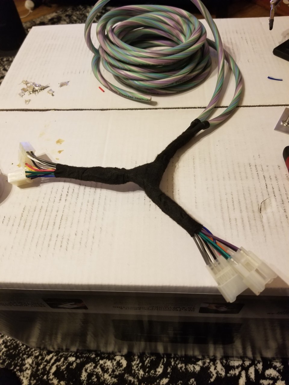

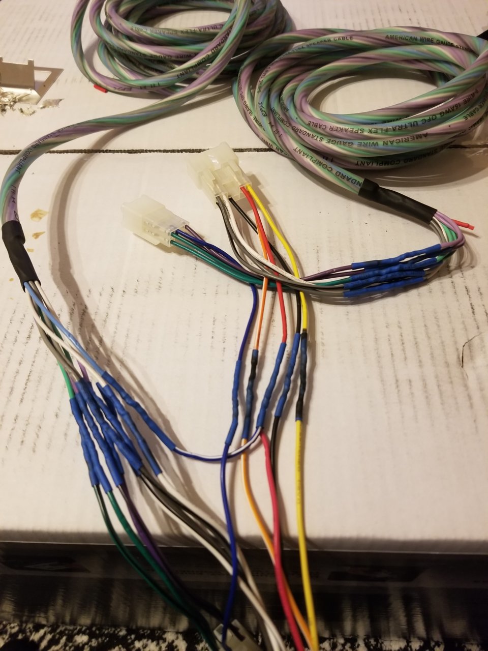

    20190318_201843.jpg 20190318_202508.jpg Finally finished up my harness. I'm using the factory speaker wires for now so I'm using 2 speed wire harness

    When you wired that did you just tap into the rear door speaker wires ?

    How did you route this monster? One passenger side one driver's side?

    Nope, all through the passenger side. Went under the dash, behind the kick panel and under the door sill. Definitely tight, but manageable

    Did you consider running the cable under the centre console? I'm about to install the same custom cable to my amps mounted on the rear panel.

    I did think about that as an option and may try to do that at some point. The issue I see with that is how tight the center console is to the floor. I wouldnt want it to get pinched or cause a hump

    I considered it for a minute but could not find an accptable way to neatly go through the storage compartments. The cable raceways under the door sills are perfect. Run power down one side and Audio down the other.
