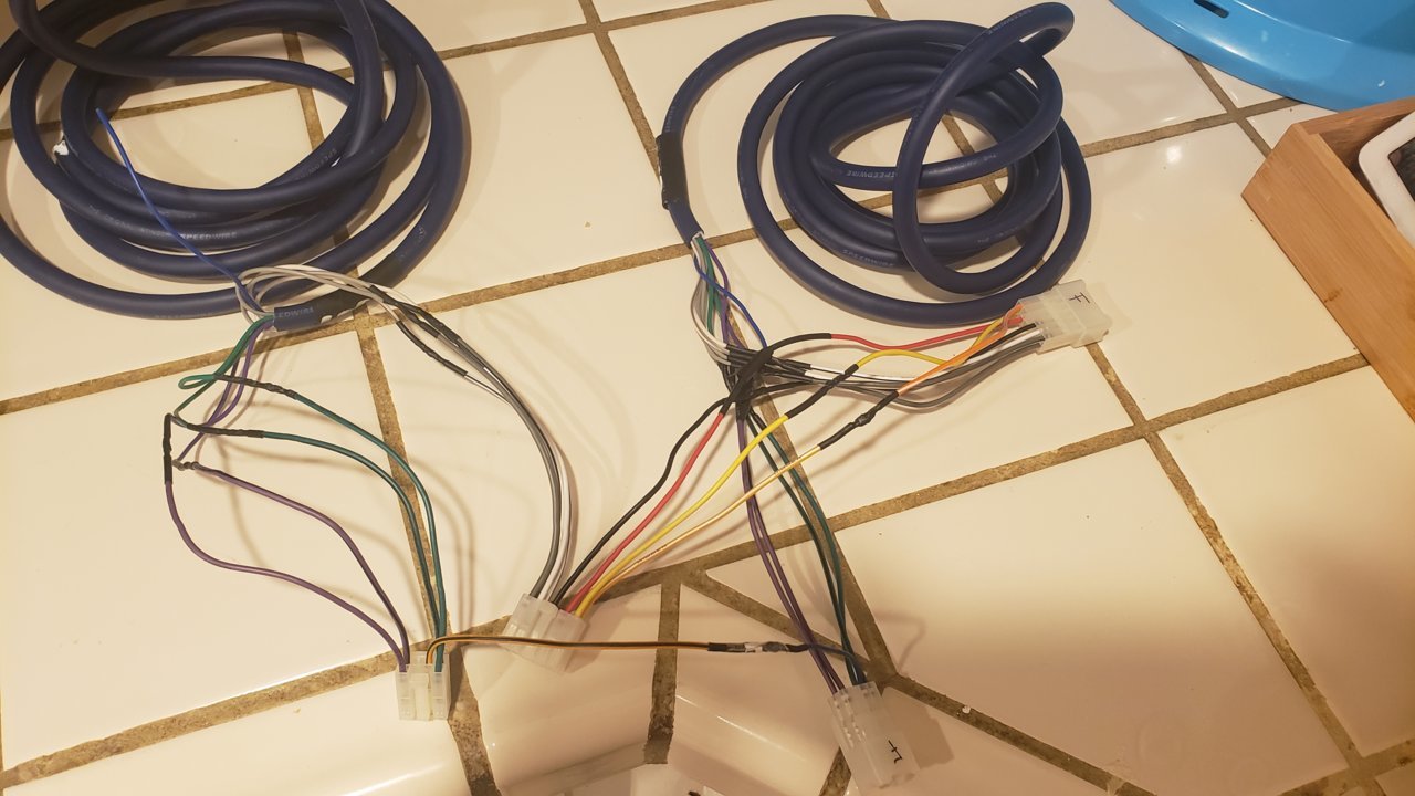

  5. May 27, 2020 at 12:24 AM
    #1005
    19trdoffroad
    19trdoffroad Well-Known Member
    Dec 13, 2019
    #313196
    155
    Chava
    Wasco, CA
    19 TRD OR 4x4 MT
    Anyone?

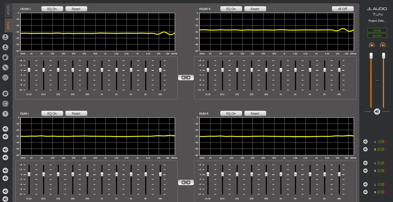

    Hi,
    I upgraded my 2017 TRD Sport audio and now the right tweeter/speaker are louder then the left. The front signals from the head unit are off based on JL Audio TuN. Do you have the same issue that I’m having and how did you correct it?
    I have OEM head unit + JL Audio FiX 86 Digital Sound Processor + JL Audio RD900/5 amp
    Thanks.

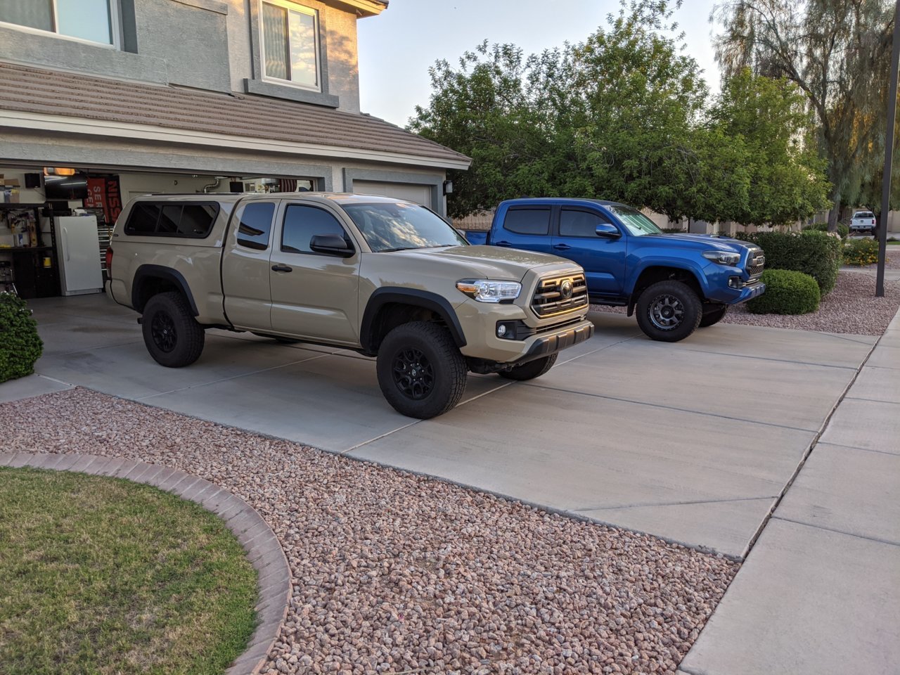

    Got to drive this truck the other day.
    It was tuned to Bluetooth audio, so I didn't even get to enjoy the sound system. Jeremy let me take it to Autozone to rent a spring compressor while my truck was up on the jack stands.
    He's been dealing with some RL stuff so he doesn't get on TacomaWorld much anymore, but I'll let him know you all say hi if you'd like me to.

    No I never had an issue like that. Does the processor have any jumpers under the front panel. I know a lot of these have to have certain jumpers moved depending on how you set it up

    I reached out to JL Audio support and he said that some of the new Toyota vehicles use an All Pass filter on one of the front output channels. It could be that the FiX is trying to compensate for the All Pass filter but can not. This could cause the uneven output levels. I ended up replaced the OEM head unit with pioneer avh-w4500nex and Crutchfield installation gear package. The system sounds good so far, however, the avh-w4500nex resets itself 2 to 3 times a week. I think it has to do with idatalink maestro rr. Hope someone on this forum has a fix for that.
