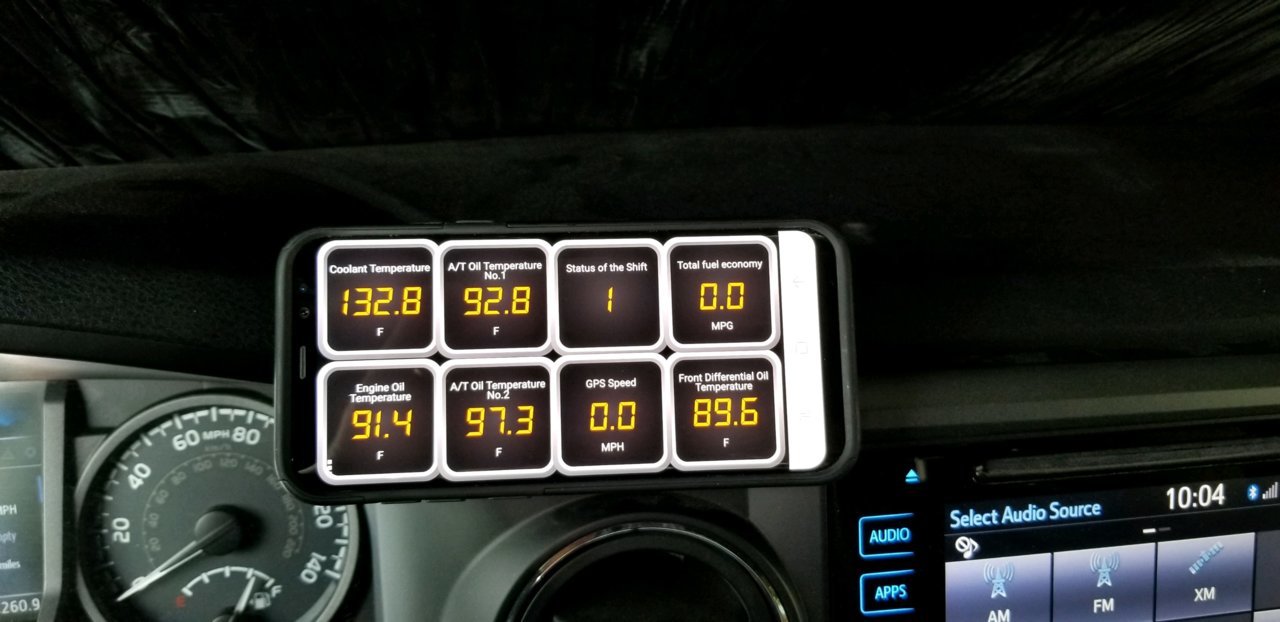

    4939.jpg This is what I use. OBD Fusion app (free) with bluetooth OBD2 reader ($25). In app purchase of Tacoma specific PIDs for $10 gets you everything you could possibly want to monitor.

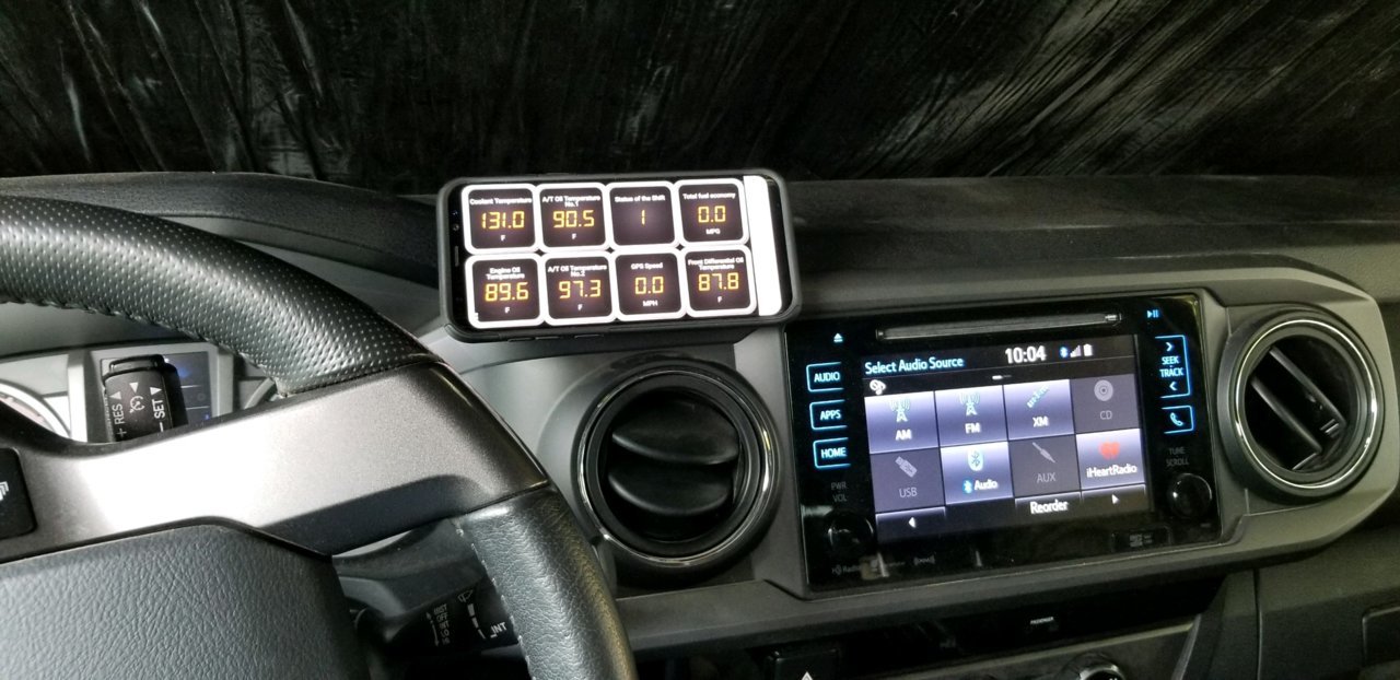

    4938.jpg Here's a better pic.

    This is fantastic. I've used Torque on Android with my FJ but I'm all iOS now. It looks like ODB Fusion will get me what I want, specifically Engine oil and trans temps! Thanks for sharing as I hadn't heard of ODB Fusion before.

    OK, I have to ask, what did you do to get OBD Fusion to work? I have a different WiFi OBD reader that I used with my BMW's and it appears to work, however even after purchasing the 2017 PID's I just get the basics. How did you get your 2017 PID's to show up for use?

    Go to the dasboard then hit the 3 dots in the lower left corner to add whatever display you want. There is a search function to use after you choose "add display"

    Thanks for the reply! I was able to add display's, but none of my displays give me the options you have. All I have are default OBD metrics, none are Toyota specific. I want the temperature display's you've got, specifically for engine oil and transmission temperature.
    I've sent an email to the vendor asking what's going on. I know you're on Android with a bluetooth OBD2 reader and I'm on iOS with a wifi one, but that shouldn't make a difference. I update this post once I hear back from them.

    Have you tried Torque Pro ? Just wondering if you did and pros cons.
    It reads front differential temp ???
    Didn't know a sensor was in there.
