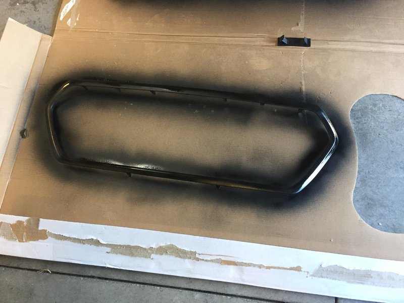

    Hey man I found a couple sr grills used but little surround is chrome. Did you find an all black one or did you paint that part?
