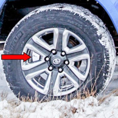

    from a toyota engineer....
    Truck buyers and journalists love to hear about new styling, powertrains and technology, yet the nitty-gritty maintenance items are often overlooked. For example, while the new 2015 Chevrolet Colorado and GMC Canyon got disc brakes all around, Toyota opted to keep using drum brakes on the rear of its 2016 Tacoma, but the decision is not without logic.
    The reason has to do with trade-offs, according to Toyota Tacoma chief engineer Mike Sweers. Toyota improved the drums brakes with a new vacuum booster and a new antilock braking system to improve how the brakes feel, reduce fade and improve stopping distance.
    "Based on these changes and the proven durability of our braking system, the disc/drum was determined to meet all of our criterial for on- and off-road performance and maintain proper brake surface temperatures," he said. "Bottom line is that disc/drum or disc/disc setup will give you similar performance and stopping distance based on system cooling and/or temperature buildup. Disc brakes provide better cooling and reduced mass over drum systems. Drums provide less exposed braking surface and less brake vibration due to braking surface flatness [rotor warping] concerns resulting from overheating of surface."
    http://news.pickuptrucks.com/2015/01/5-things-overlooked-on-the-2016-toyota-tacoma.html
