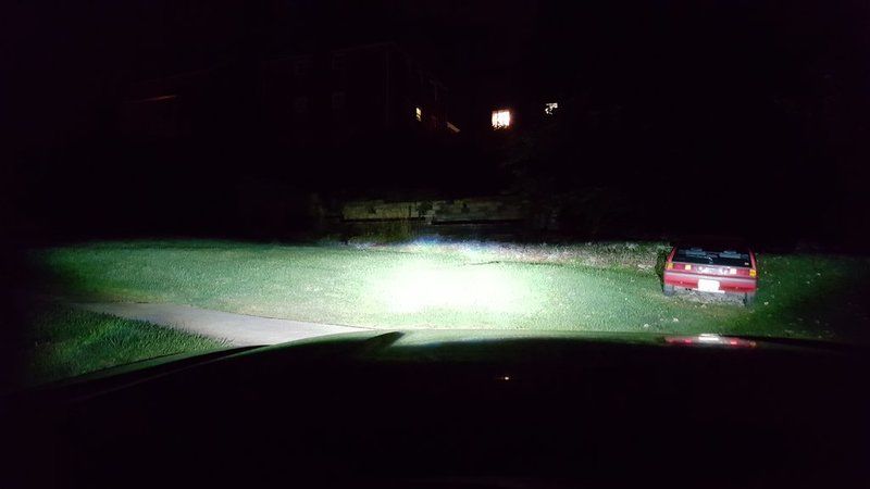

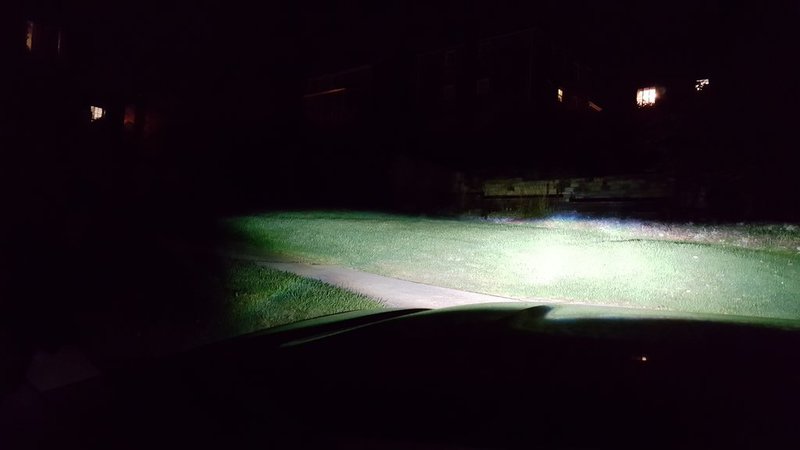

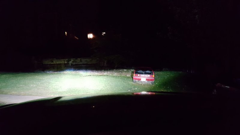

    Well got the V fixed, ordered a set of Morimoto H11B hids from The retro fit source!!! $40. Here is the pics!!!

    This was the solution. The standard H11 HID bulb has a different grounding wire location on the bulb than the H11B. So i ordered a set of H11B Morimotos and the "V" is gone!
