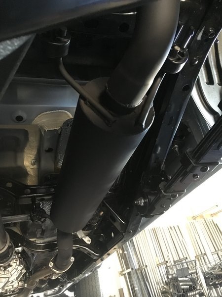

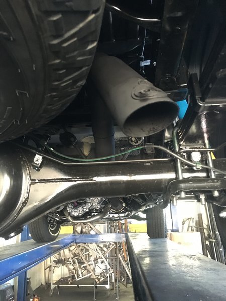

    I just had a Magnaflow custom setup done on Friday using a 4x9 oval center/offset, 2.5" in/out muffler with a 3" coming from the collector flange and 2.5" tail to keep backpressure in check. It sounds amazing and with the 6 speed auto in top gear at 70-80 it is near stock level quiet at part throttle. I was amazed at how quiet it was until you stomp the skinny pedal. I haven't had time to get sound clip videos yet. I am happy with the tone. Also, I had a shop do everything with aluminized pipe, stainless muffler, and tip. Came to around 350.00, which is a lot better than the bolt on catback setup.

    What was your motivation for going with aluminized pipe? Purely cost?

    Partially. The reason why the Magnaflow cat back is so expensive is all the mandrel bent, polished stainless tubing. It looks very nice, will probably hold up well, but not worth the money. I have used the same shop and same materials for years and never had a system fail prematurely. My Jeep had the same shop do a cat back. The tubing was still like new after four years, the stupid 40 series Flowmaster was rusted to shit.
