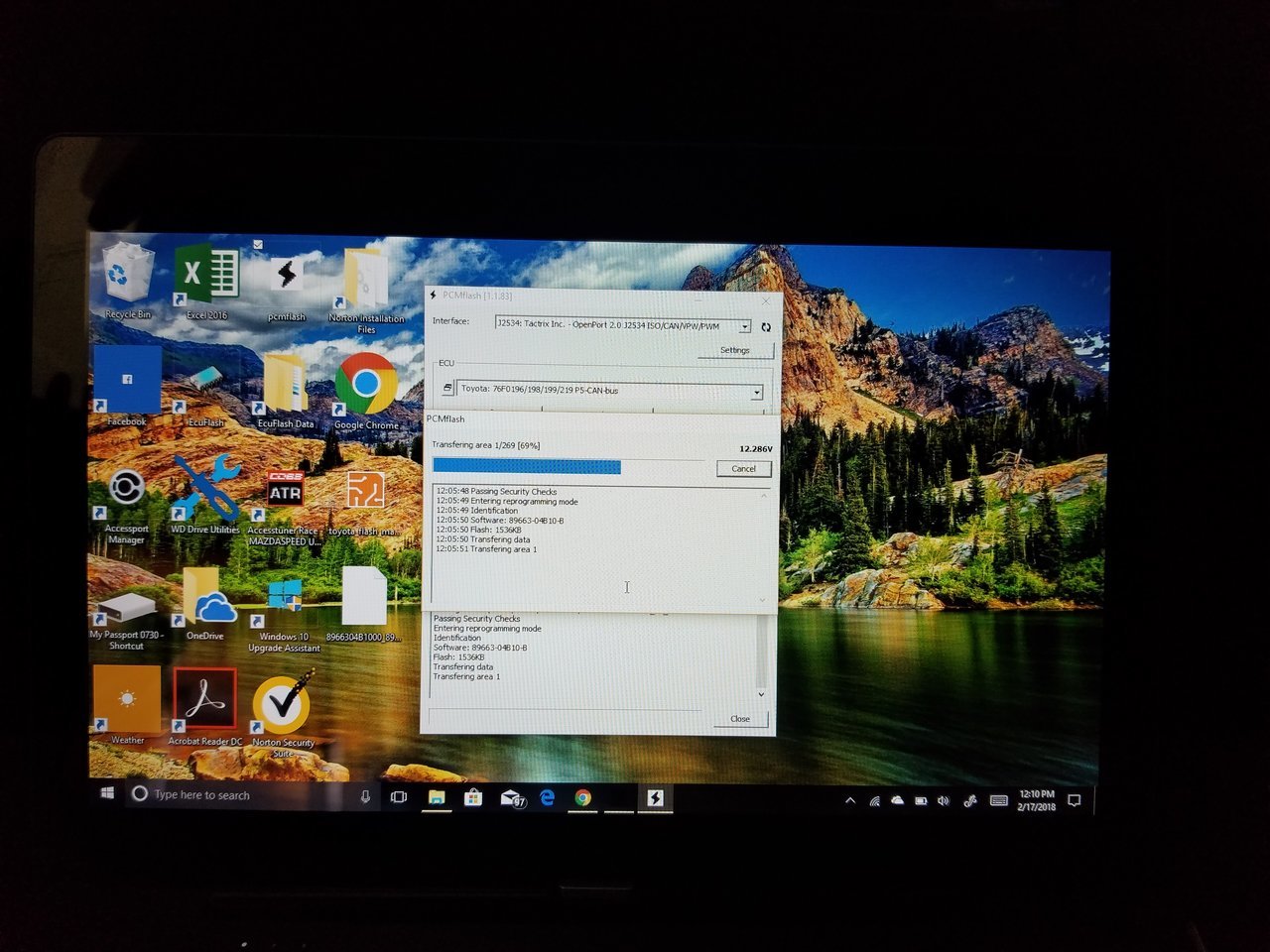

    Identification worked fine.
    checksum corrected, passed security checks.
    "Completed Unsuccessfully" three times. that was with 04B12-1.03B_91_Octane.bin
    EDIT:
    redownloaded the .bin file, restarted pcmflash and reconnected to truck. all looks correct like above but same thing, fourth time Completed Unsuccessfully

    Try without identifying first, just truck on select file, write

    same, Completed Unsuccessfully
    EDIT: stopped, disconnected everything, started over, same: Unsuccessful

    Truck completely off, retry.
    Try to flash a stock file?

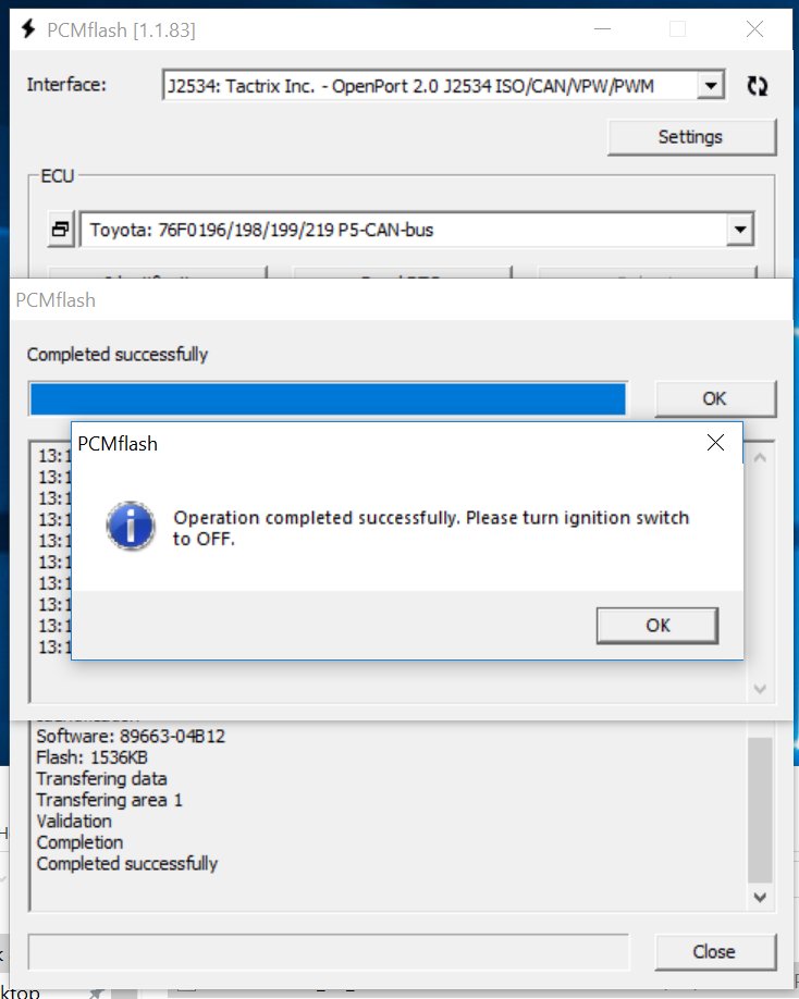

    I ran it successfully, identified successfully and then wrote the new tune! Everything went fine but I have not had a chance to drive the truck yet. Software said everything went fine though so everything should be good

    i've got last version of 1.03 on here now. do you need me to flash stock? unfortunately i'll have to do it later.
    this is literally the first problem i've had since installing alpha. weird.
