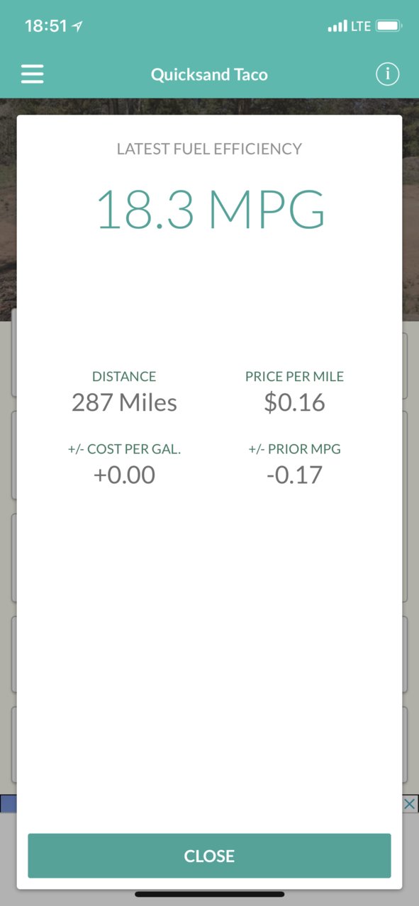

    First tank of gas on 1.03B for those interested. About 300 miles on 3/4 tank. About normal for this time of year with winter fuel and freezing temps.
