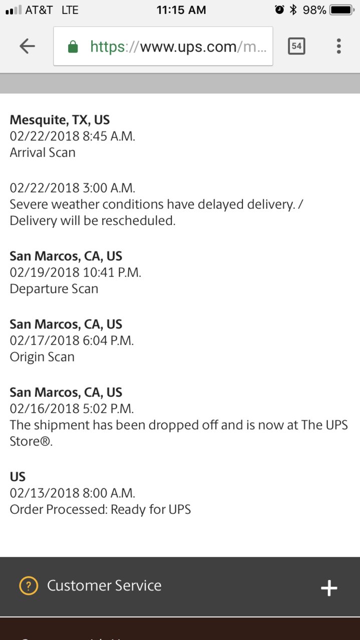

    Well this sucks! Got to wait another day...ABE98A5D-C7DB-4BAB-B725-6786E8C097DC.jpg

    I have a permanent hatred for the Mesquite, TX UPS hub because they lost (i.e. stole) my Tavor SAR -_-

    That was an expensive claim...

    I got a brand new one free of charge out of it, but they made a local gun shop eat over half the cost on it, and it was certainly stolen at that facility. Naturally they refuse to admit that and their customer service through the whole situation was abysmally tragic. A lot of things about their side of the story dont add up either. I documented everything down to the smallest detail and it was only good for intimidating "supervisors" who tried to blow me off and getting them to change their stance to taking my comments under advisement. Lol
    Now I get a courtesy call from the ATF every 3 months or so as part of their protocol they said, for verifying that the lost/stolen rifle has not yet been recovered.
