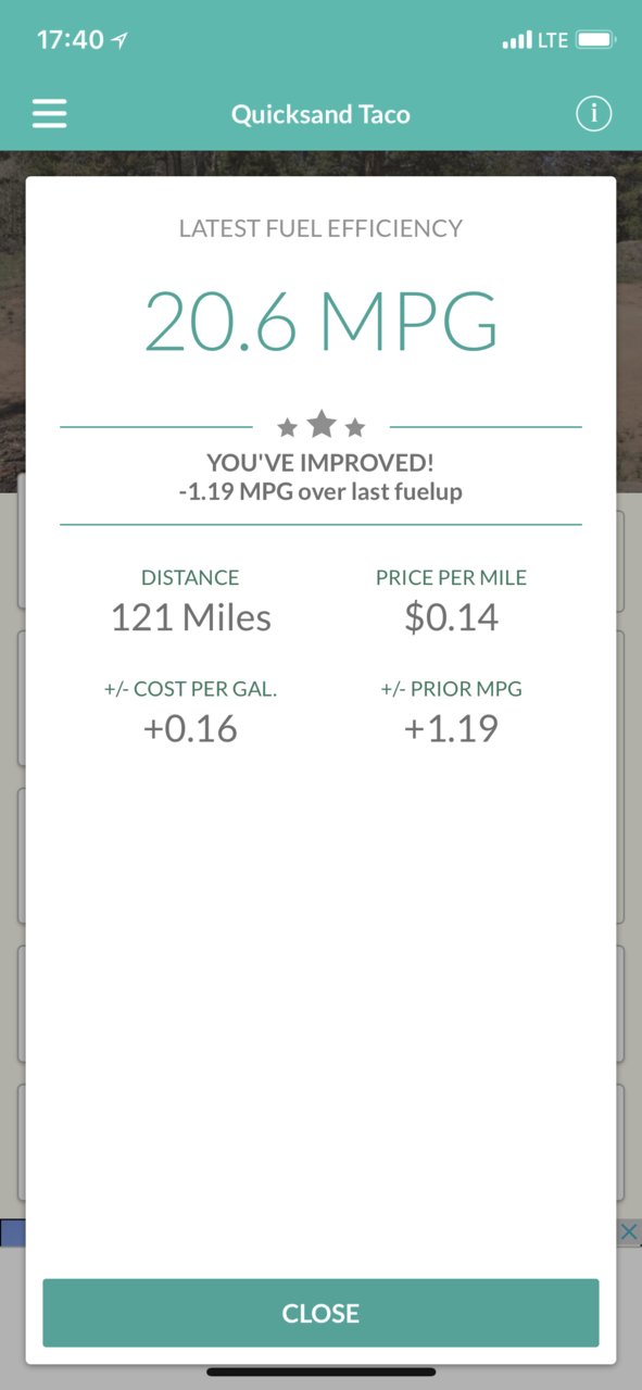

    I’ve got about 500 miles on 1.03B now. The stuttering issue seems to have gone away now for me. Not sure if it was fuel related or if it was still learning / calibrating.
    Last fill up with the cruise set at 65-70, 87 e0, 35 degrees out.
    MOC221_ likes this.
