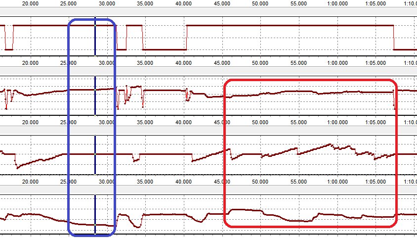

    after hearing you guys report this I did some testing on my truck today, tried to get as much data as possible from 1200-2500 RPM with the torque converter locked up so I can get good data.
    it's not injection timing, it's camshaft timing, right around 15-18% throttle 1900ish RPM I am able to produce it on my truck regardless of temperature.
    I tested same lock but with completely stock camshaft timing and can still produce it.
    it's the transition of valve timing as the exhaust cam advances and the intake cam retards.
    from what I see it is when the intake camshaft is around 20-23*, but not when lower at under 20 to 10*, or over 30*
    this area on the camshaft map I have not changed from stock on the tunes.

    I'll have to tune this area of the valve timing..
    you can see here under peak retard it is OK, but the transition range around 20* on the intake there is ignition instability, likely pre-ignition
    it's an area of the map I've never changed...
    this might explain why some of you have said you have stutters since you've owned the truck even on stock tune.
    Ares32, su.b.rat, mstrbrc and 6 others like this.

    Those ragged waveforms look like my trucks feels. Damn stutters lol. Otherwise I love 1.03B, especially the 91 file. Power.
